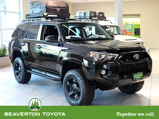

So i was checking out the dealership and they had a 4runner that was all blacked out. TE roof rack and im guessing TE running boards. Can anyone confirm that thats a TE running board in this pic.

Those boards looks like the one my dealer install on my 14 trail. Those are the rigid boards that 10-13 trail has as an option, because 10-13 trail doesn't have the bottom rocker like the sr5 and limited have. But from what I know 14s sr5, trail, doesn't have the bottom rocker.
Yeah, those look like the Rigid running boards to me as well. It's hard to tell from that image. I'm still trying to decide if I'm going with NFabs or the OEMs. I'd like to get some Budbuilt sliders, but I don't think I can afford them.
What kind of tires are those in the picture? Duratracs? Those wheels look awesome!

Wheels were Rockstar II with Duratracs. Dealer built some pretty nice looking 4runners but all the mods on it were pricey.
