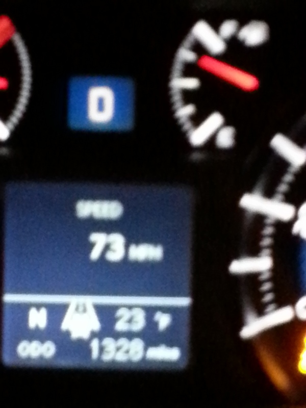

i have confirmed that turning off via Techstream the "Eco Drive Indicator Zone" will actually remove the gauge completely.
sorry for the crappy cellphone pic, but it was a quick snap to prove it :)

Good sleuthing! Thanks. Does it alter the 'Current consumption' monitor though? I wonder if the dealer will shut this off for those without Techstream.

is there a reason for doing this, or is it just to get rid of that dumb light?
Not the light, but the bar gauge on the centre screen that makes the font size of the digital speed smaller. Without the eco monitor the readout is larger. And the monitor is as useless as the light.
well its under the customize settings in techstream, so i wouldnt see why they couldnt, if you are specific on your description and your really nice about it :)

Re-confirm. Yesterday was at the dealer's for the 5K miles checkup, told them to hook up Techstream and switch that thing off -- and they did.
