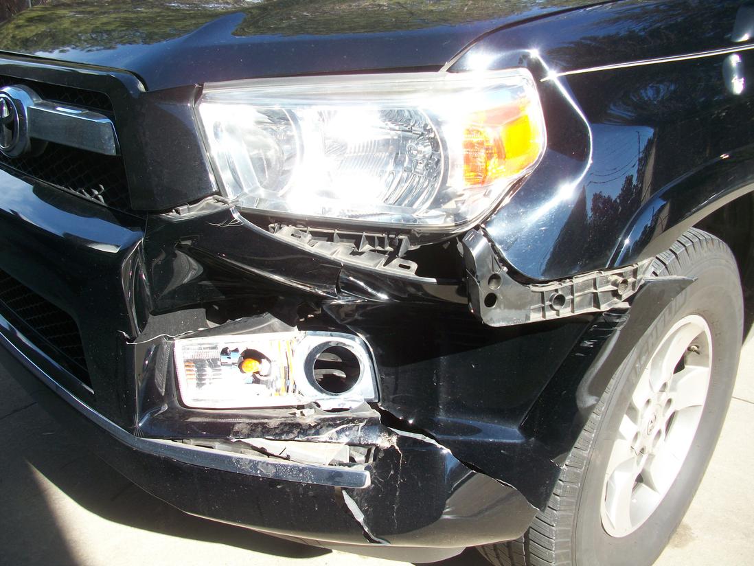

I echo that. I haven't pulled a '14 yet but I'm 99% certain that you will need to at least pull away that side of the bumper cover in order to get to the bolt that goes from the fender into headlamp. This photo is of a wrecked '11 but the basic design will be the same. You will notice that not only is there a bolt coming in from the side of the fender into the headlamp but also that the bumper cover clips into the bottom of the headlamp as well. It's not too bad to pull the bumper cover away or even off so don't sweat it (maybe an additional 30 minutes worth of work)
