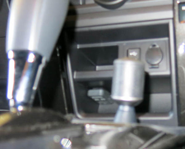

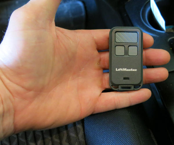

One other option for those on a budget. I ordered a "keychain" opener off of Amazon for like $20. I put some velcro tape on the back and secured it to the roof of the lower dash cubby hole. You can't see it unless you have your head on the seat looking right at the dash with a flash light. Of course, there are a million places to stash one of these.
radicalwillie-albums-do--yourself+homelink-picture30750-key-chain-remote-amazon-%2420-%242-velcro-tape-home-depot.jpg
radicalwillie-albums-do--yourself+homelink-picture30751-cubby-slot-mount-youd-never-know-its-there-unless-you-looking.jpg
