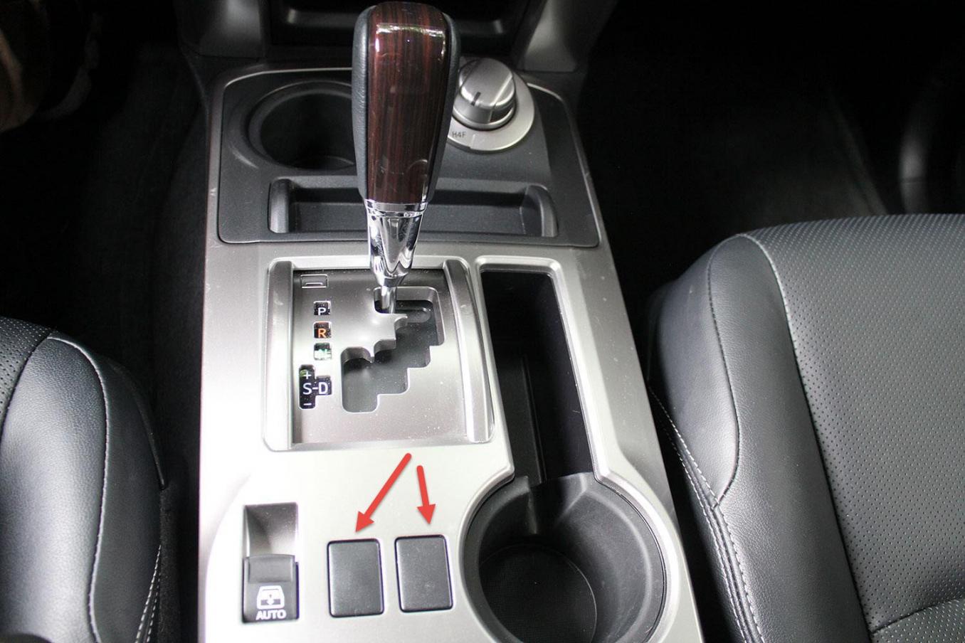

I have a 2014 Limited and am going to replace the head unit with an aftermarket one (DMX906S). My question is about adding a USB port to the center console where there are 2 blanks currently.
I'd like to know if anyone has added a Carplay compatible USB port to this area and what part(s) they chose for the task.

You can get a Toyota-compatible USB port that has at least a 3' cable (though that might be cutting it short, you may need 4' to reach there) and route that through the center console to the back of the head unit.
Toyota has two switches; normal size and short stubby ones. You'll need a short stubby one for that slot.
Why not use the factory USB port for CarPlay using Metra USB adapter for Toyotas? That is what I did with my Kenwood headunit. The adapter is needed as the Toyota USB port wiring is not a standard USB connection on the headunit side and an aftermarket head unit is going to have a standard USB connection.
But my Kenwood also has a second USB input that can be used for Android or another digital source. I used the supplied USB cable with the headunit and installed in one of the slots you pointed out by drilling a hole/slot in the side of the blank.
Do you happen to know the part number for the port that'll fit?
Sent from my moto z3 using Tapatalk
I would have used a panel mount USB passthrough for a cleaner install... IF you can't find a USB switch blank that fits the OEM spot.

This looks awesome. Can you give a quick rundown of how you did this and what USB ports you bought for this??

I found this mod in a Taco forum on how to move the EnTune USB into the armrest, which would be great to get the cords out of the way. Can someone confirm if this would work the same in a 5th Gen Runner? I’m not familiar enough with the head unit/wiring to confirm myself.
It’d be slick to pair this with BeatSonic to get a sleek CarPlay setup!
I cannot tell if the stupid PM system actually sent you a note, so apologies.
Regardless, can you advise where you purchased the second USB port? Thx!
Sorry for the delay. I did get your PM but rarely check. I got both usb ports from Amazon. Here are the links
Cllena 2.1A USB Charger Socket... Amazon.com: Cllena 2.1A USB Charger Socket Power Adapter + Voltmeter Tester 1.9ft Wiring and Fuse (Blue LED-2) : Cell Phones & Accessories
Cllena Dual USB Port Charger... Amazon.com: Cllena Dual USB Port Charger Socket Quick Charge 3.0 & 2.4A for Toyota : Automotive
Hi there! Do you have any rundown or guide on how you accessed those switch blanks and what you tied them into? I'm wanting to do the same thing on mine. (no seat heaters for me). Thanks!
