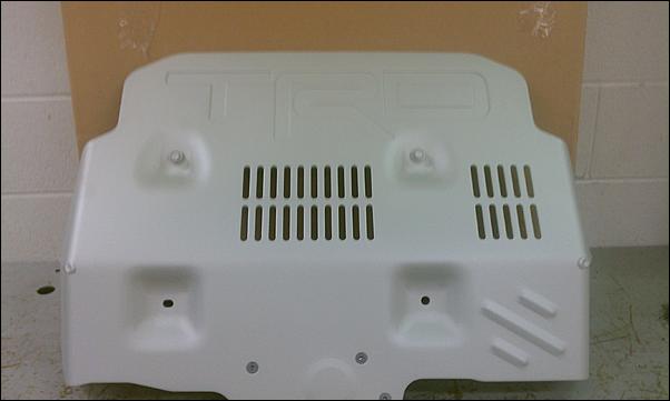

Quick question. I searched the threads but could not find the answer so I apologize if I missed it. I am wondering I'd the TRRD PRO skid plates (particularly the front skid) will fit on the 2010-2013 models since they have different front clips.

I don't see why not.
The TRD skid does not use any front clips, it is bolted on.
look here: http://www.toyota-4runner.org/5th-gen-t4rs/176518-trd-pro-parts.html
Hope this helps!
These are not made for KDSS, so the sides will have to have a cutout for stabilizer bars clearance, IIRC!

The prototype TRD Pro 4Runner with KDSS had a skid on it with cutouts as shown....
