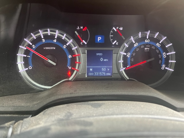

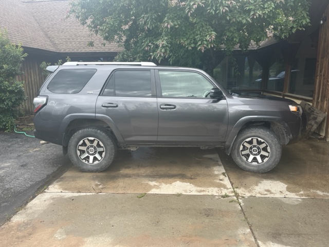

My wife’s 2014 SR5 up at our Montana ranch. Hadn’t driven it in awhile, so my wife wanted her mechanic to drive it. Did a 150+ mile loop over Skalkaho Pass to fish Rock Creek from the top down. Heavy rain year and Rock Creek road was muddy and full of potholes. Feel like I’m still cleaning the mud off.
My wife names her 4Runners and this one is “Priscilla”. Her brand new ORP in Lunarock is name “Basel”. Anyhow, Priscilla is clocking 331.5K miles and running strong. Only issue is a persistence sheet mettle rattle when the road is wash board. I’ve tried to find this previously, but really need to get it on a rack to tap around. I know it’s none of the skid plates. More like a. Shield.

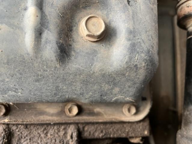

I was just under the truck lubing the driveshafts and check for rattles on the shields and could not find it. What I did find is that the rear steel skid plate with oil drain cover has a resonating noise when I bang on it, but nothing is loose.

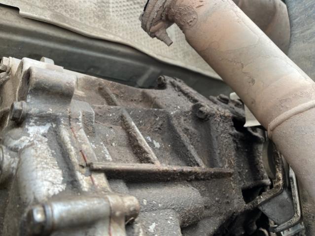

Also, noted that I have a leak on the input seal of the transfer case. I just rebuilt a transfer case to replace one with the same leak on a ‘94 Suburban K2500 my son gave me. I won’t need to rebuild this transfer case, just replace the seal. Will need to find a how to video on pulling the transfer case out.
towards the rear of the vehicle. if you start at the tail pipe and work from back to front you will see it. I haven't seen any videos on the 5G 4runner transfer case removal but timmy has one for the 3G, it should give you a good idea , and I'm sure with your knowledge you can fill in any gaps

OK, I’m pretty sure it’s the skid plate with the engine oil drain cover:
4R Rattle - YouTube
I will pull it down for inspection. Thinking of placing rubber washers on the bolts between the plate and the mounting holes.
IVe found my skid plates (all RCI either steel or beercan) all seem to come lose slowly while driving resulting in some minor resonating with the usual...bzz vibrations. Maybe its the anti seize that causes the M8 caps to back off. I dunno, the factory torque is low for these bolts. I have tried abit tighter but thats about it.
IF you get washers maybe go with VITON types as they can take heat upwards of 600F for limited times or many thousands or hours at heat of 450F. THeres PTFE but it can break down alittle above 600F. LIkely your probably less than 250F on the plates due to air flow and distance from hot bits... but considering how stupid cheap viton is.. why not!
