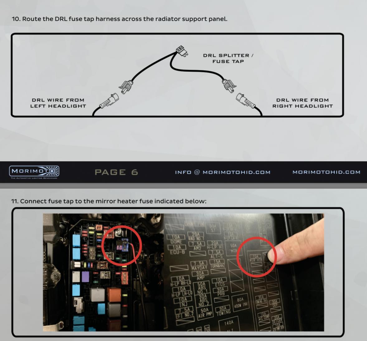

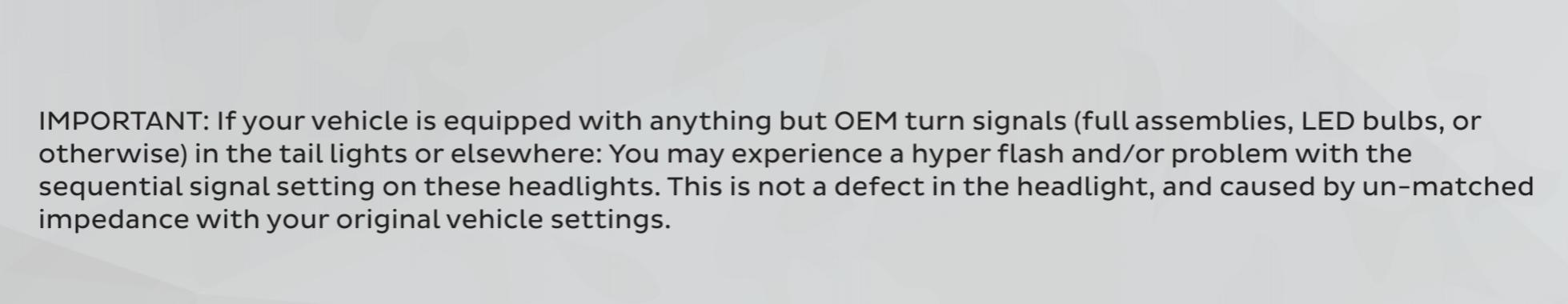

Something else not widely advertised, if your running modified tail lights you might get hyper flash with the turn signals. XD, I've got the LED rear plate bulb and Morimoto fogs or my trailer lights... is that gonna be an issue, or any auxiliary LED lighting I've added?
looking at the specs, these have built in resistors.
