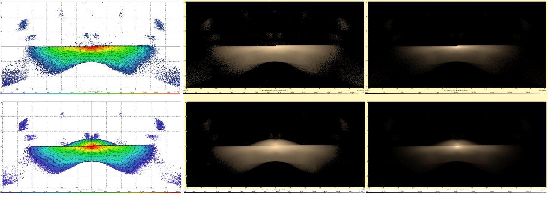

[MENTION=150162]brtnstrns[/MENTION] - Thanks for sharing your review! We have been following the thread closely, and while we 100% respect the opinions of all members - the fact is that headlights are not really intended to provide strong foreground illumination, because that limits your ability to see into the distance.
If you take a look at the ray-trace plot for the beam pattern on these lights (or any other, for that matter) you'll see the brightest part of the beam pattern is in the center, towards the top. When the beam spreads out over many meters on the road ahead - the brightest light ends up at the furthest distance out, and the dimmest light on the ground directly in front of the vehicle. This is done on purpose so that your pupils dont adjust to overly bright light directly in front of the car. FWIW, the recently launched Tacoma and Tundra lights use the exact same optics as the 4Runners, and we havent seen any similar complaints from those owners
At the end of the day, fog lights are for foreground light, and any DOT/SAE fog lights wont be overly bright for that reason. Morimoto's Toyota fogs blend perfectly with the intensity/spread of light in the foreground of the XB's - making them a great pairing for the ultimate in fully street legal lighting for the 4Runners.
