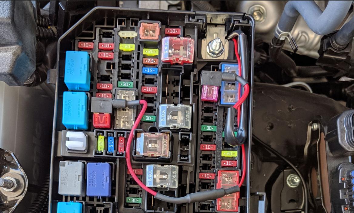

Yep that's the place for directions. One thing I noticed it doesn't say, I went to tap the fuse wire and then couldn't close the fuse box cover. couple minutes of google showed nothing so I took a dremmel and notched a slot for the wire. If you ever pull it I just used refrigerant tape to seal the hole... similar to this

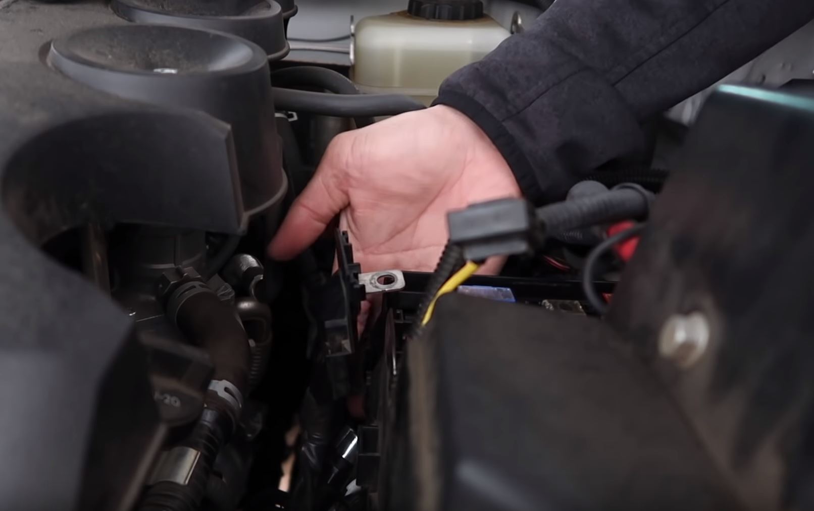

I installed the DRL wire through this area. You won't have to cut into the fuse box. This picture is from an install video on YouTube of the "Raptor Grille" lights. It works for this case as well.

Link to video? Is great to know but I just watched 3 videos on raptor grill lights and they all went through the firewall to tap. thanks

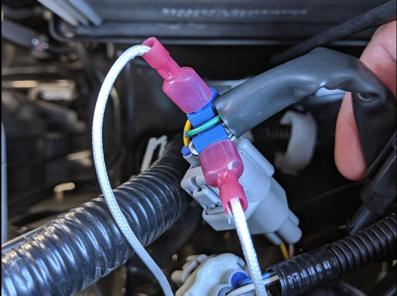

I tapped the headlight wires. I don't know if there is anything cleaner but it worked for me.

Here is the video for reference:

Here is a photo of how mine turned out.
Nice, guess I'm gonna go back and do this to mine. I found the method of just clamping the cover down on it kind of questionable, but at least the wire is reinforced.

Thanks for the fusebox wiring fix! Much cleaner. I was about to notch mine, but glad I don't have to now. Another bad product design fixed on the forums. You're welcome, Morimoto and XD!
