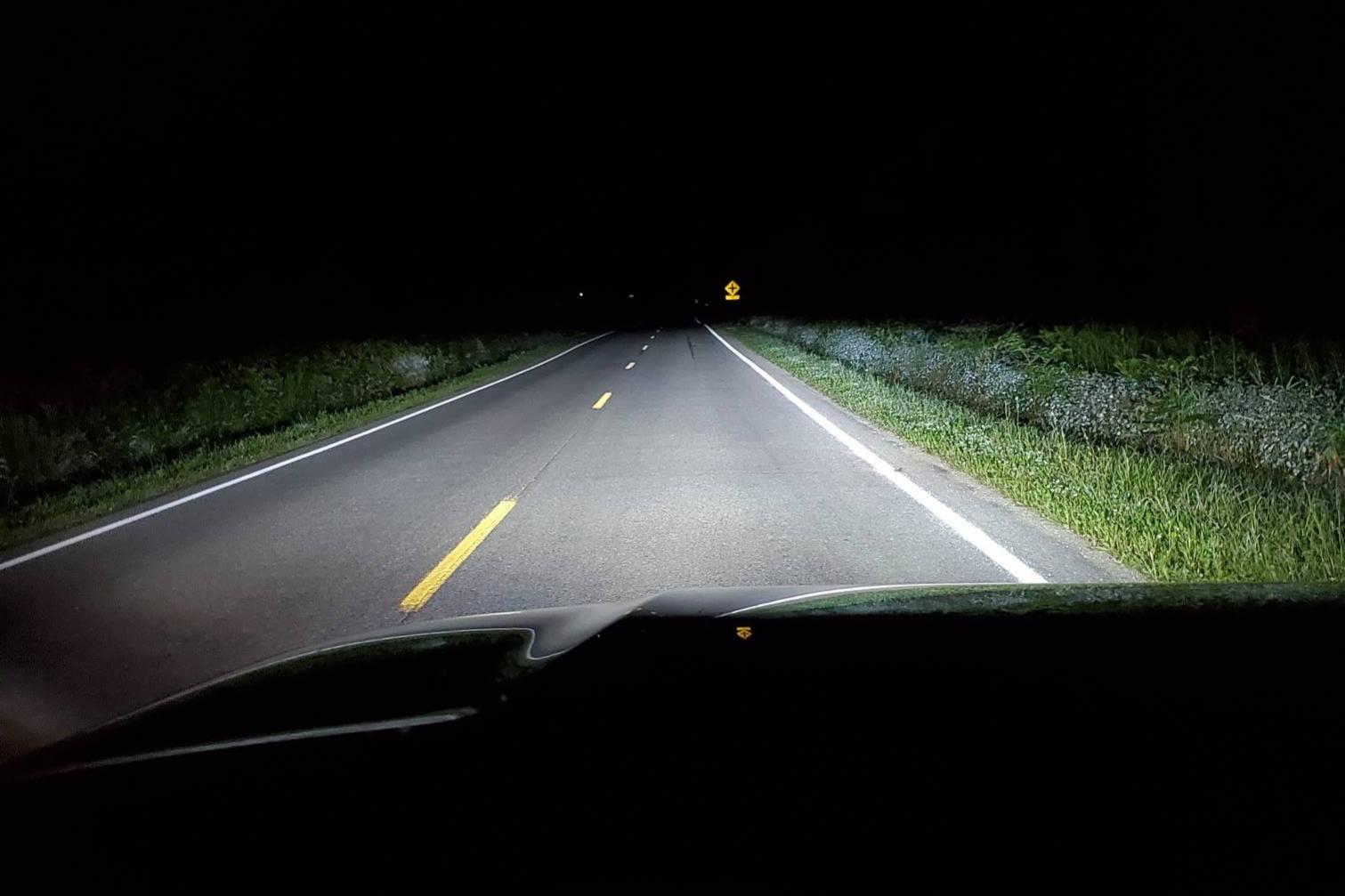

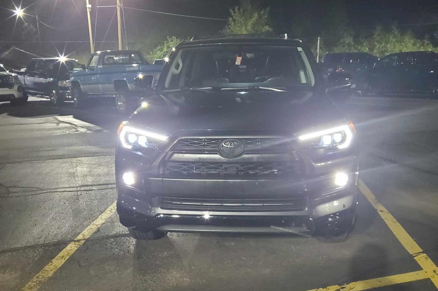

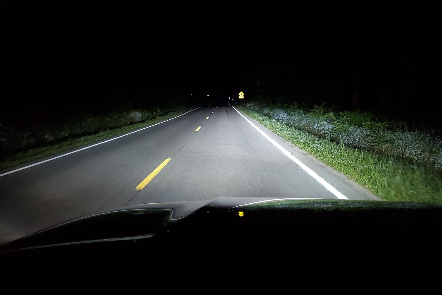

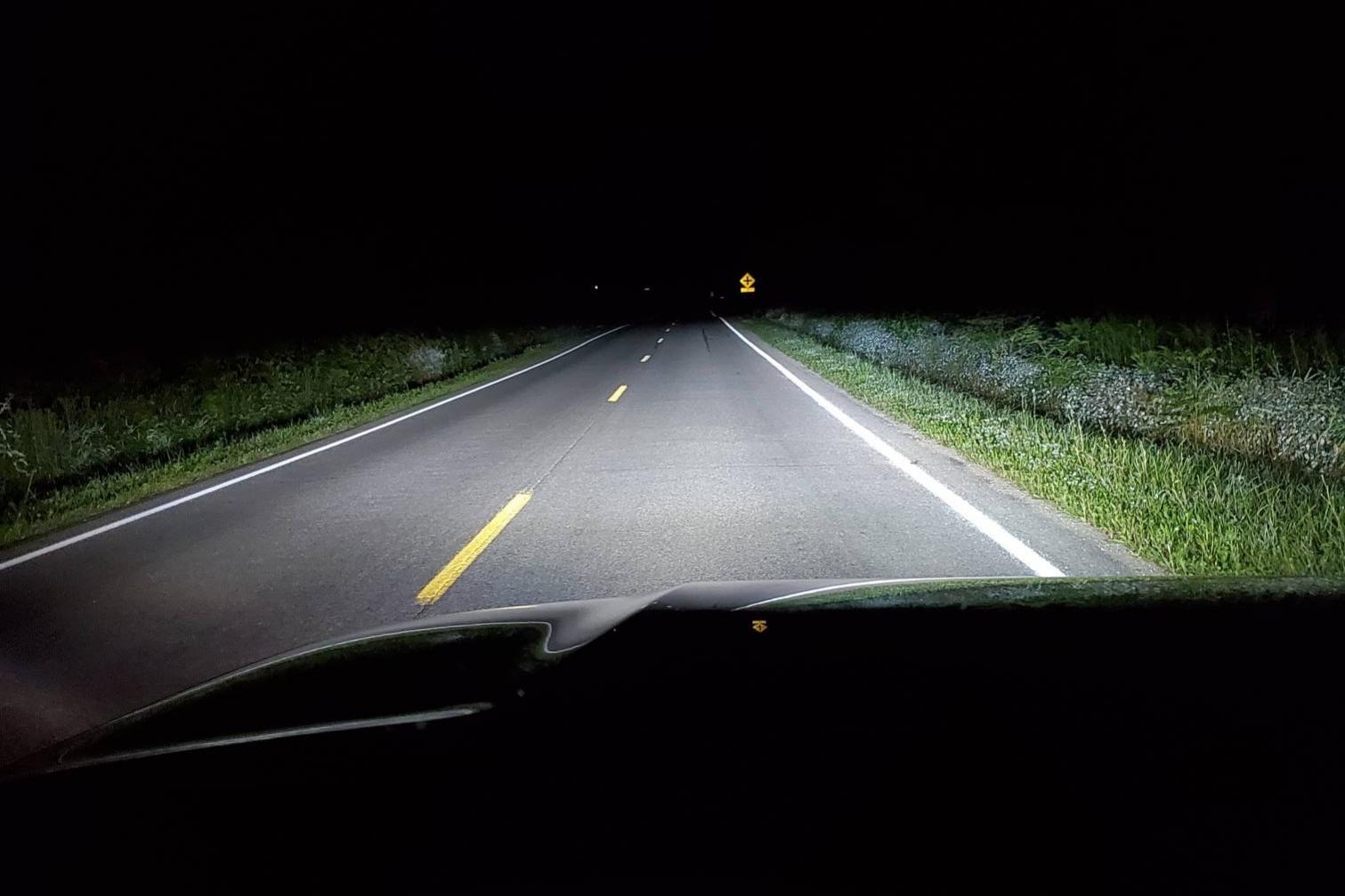

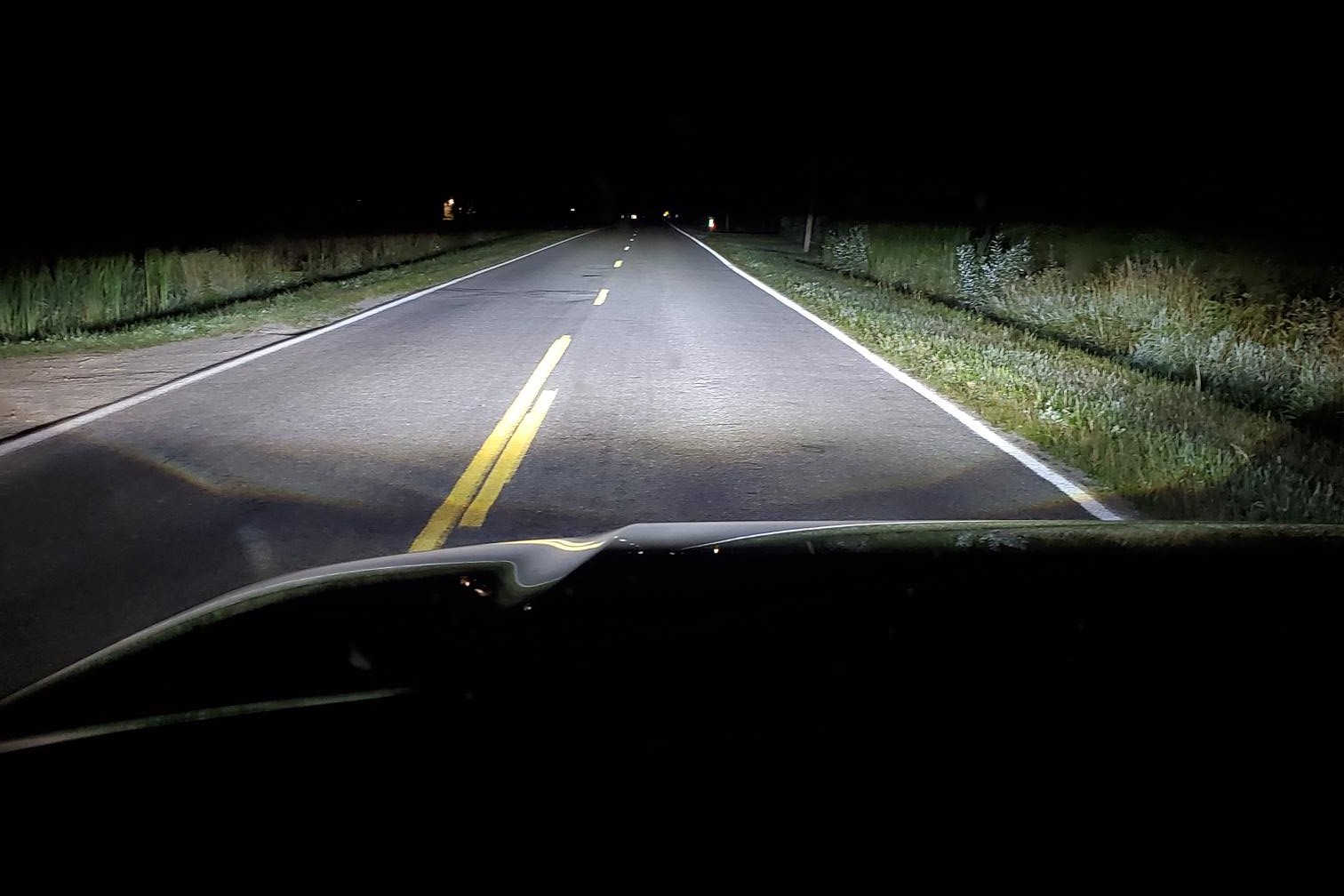

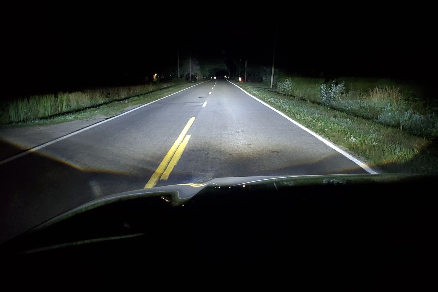

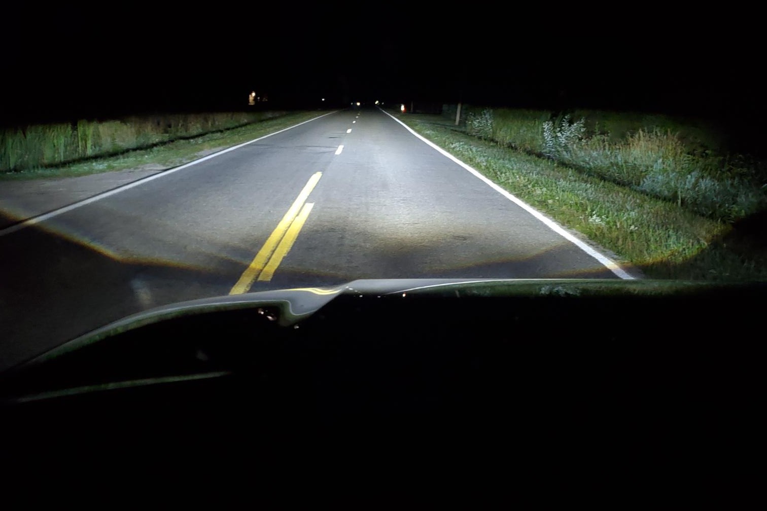

After driving with these lights for a couple weeks now I wanted to give some insights from a couple different perspectives. First off I really love these lights and I came from a Morimoto 50w HID drop in kit. I believe the HID did throw more light and had more overall light output, but you can not beat the beam pattern and clean, crisp cutoffs from the XB headlights. One of the biggest things that drew me to these was the great DRL and switchback turn signal that I have setup in the sequential mode. I was previously running LED signals so I already had resistors installed on the factory harness so I did not experience an hyper blinking as some others did. These turn signals/DRL are bright as hell and I love them. Ultimately I got these though because of the black out appearance to match the rest of my 4runner. They also match my Morimoto XB fogs perfectly. The low beams, when adjusted properly are very good and the high beams are great too. As some others have said, these lights needed to be adjusted up out of the box. Now to address the biggest complaint about these, the side cutoff. I can see why some would find this to be unacceptable or even annoying but IMHO I dont think it is that terrible. I drive mostly very dark country roads about 80% of the time and this is just not an issue for me. I find myself regularly using my fogs which helps but I dont NEED to use them. I never used them with my HID setup just because they were drowned out by the erratic bright beam pattern of the HIDs. I am attaching some Low beam, High beam and low beams with fogs comparison pictures from the HIDs to the XB LED headlights. Overall I am very happy and I think Morimoto did a great job with these. Can me get some XB taillights now!?
Pictures starting at the top:
FRONT VIEW
XB LED LOW
XB LED LOW + FOGS
XB LED HIGH
HID LOW
HID LOW + FOGS
XD XTREME LED HIGH

Did a great job of comparison photos.
You can definitely tell where the area that people are complaining about is. However, I'd bet that area is also not very well lit from the OEM halogens, so that's probably why people like myself and others that came from non-HID don't have the same concerns.
But these obviously have plenty of spread even if it's not as much as the drop-in HIDs. Unless you weren't paying attention to when you were driving up to an intersection and only look to the side when you're nearly on top of the intersection, it's basically well lit from 15 feet back or more.
The "missing" light in front of the xb headlights is not able to photograph with a cell phone camera. By the eye it's black, dark nothing to see. With the hid and stock halagen that area is dark but there is enough "cast" lighting to see safely while going around dark corners.
Just hope no one blows a tire while driving over the curb they didn't see
This is true, and like others have said, is corrected by using your fogs. I dont think running your fogs most of the time is that big of an inconvenience. Everybody has their own preference and these headlights will not make everyone happy, but I can strongly reccomend them.
