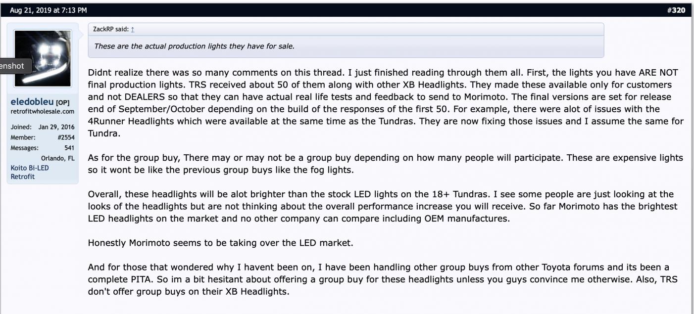

Seems the Tundra XB's have problems as well, just looked at there forum. One of the XB dealers stated the 4runnner lights have issues that will be corrected for the production units in October along with the Tundra lights

Also, if you look at future posts from the guy over on the Tundra forum, he corrects those statements, seemingly based on a misunderstanding
I was about to add that the tundra vendor did retract the statements from the previous post as well. I’m sure mild revisions will happen, but I highly doubt that morimoto will blow money on new tooling, molds, and even more prototype units at this point. Also, another member spoke out about having a REAL prototype model. They are not made the same as the “pre production” sets.
