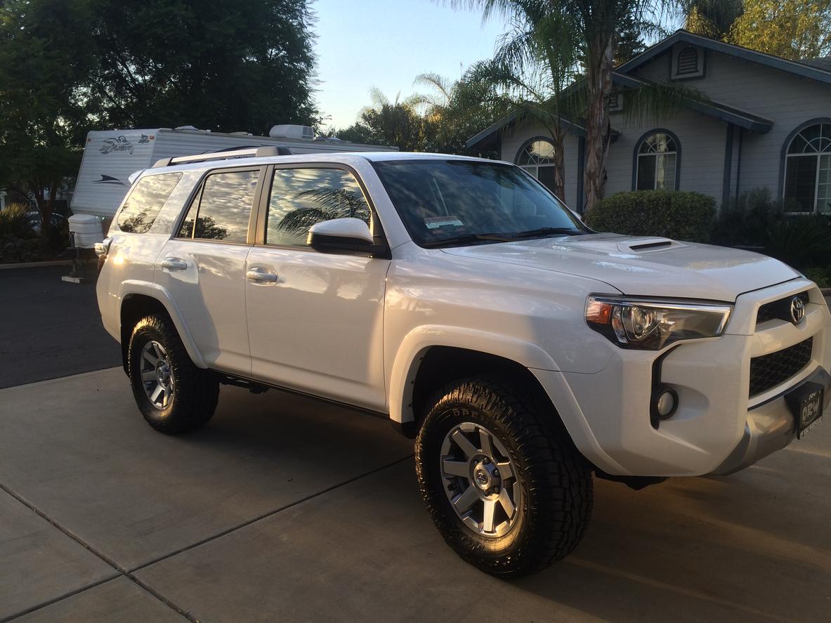

I just lifted my brand new 2014 Toyota 4Runner Trail.
I went with the following set up:
Stock coils
5100s Bilsteins All Around.
Front End Lifted (I believe at the 3rd Notch, I did not install)
Diff Drop
285s Toyos A/T II (LT Version).
Overall, it sits level (it looks higher in the front in the photo). It is a little stiffer, but the ride is still good and solid. I have KDSS, so I kept it simple. I removed the front mud flaps and trimmed the front a little. My tires rub a little when doing a hard turn in reverse.
Overall, I happy with the set up. The gas mileage went down from 17.4 MPG to 16 MPG and some change (1-2 MPG). The OEM tires and the 2.5" front rack were annoying the crap out of me. I believe this should be the stock set up :-).
Very curious as to what setting the Bilstiens are set to. I have a set ready to install and I'm still on the fence on what setting to put them.
Truck looks great BTW
Hey I have same rig just grey... Kinda wish I would of got white. But I have been waiting on someone to do this setup. Can you find out if it is at the highest setting. Stock rear springs right? If so I'm doing same setup. Kind of glad I do not need wheel spacers. Can you post a few more pics when you have a chance thanks! Also how is the ride compared to stock. Tires are awesome too. Great job.
