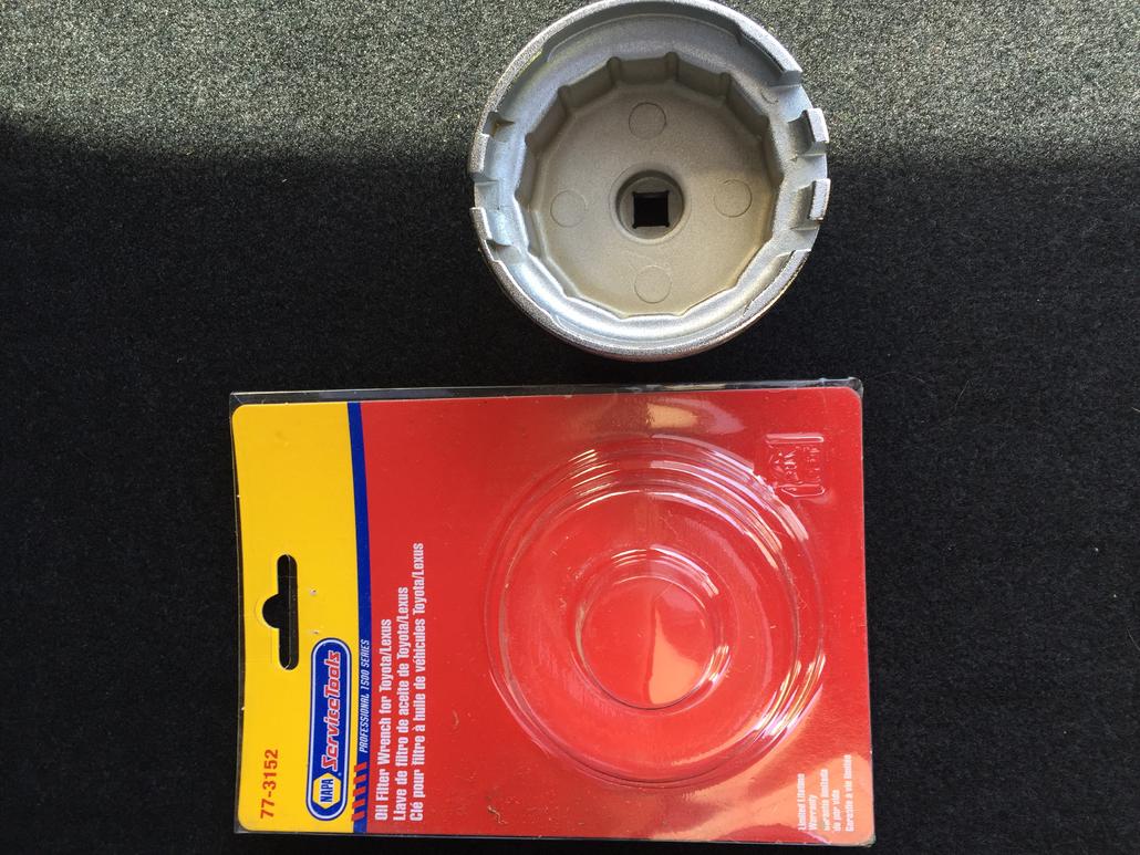

I just wanted to share the Napa p/n 77-3152 ($18) is the same oil wrench my Toyota dealer sells for $35
I used it to do my oil service and it worked awesome, it even has the 3/1 slits cut into it to fit the filter element cover perfect
14 flutes x 64.5mm 3/8 drive
A repackaged PBT 71113

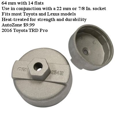

After removing skid plate and drain plug cover , I realized I needed the tool to pull the oil filter canister.
Called the dealer, young kid quoted 69.95 for a Toyota cap wrench
Called Auto Zone, young kid quoted 9.99 for a Toyota cap wrench
Purchased a very nice fitting, good quality 64mm cap wrench at AutoZone part number 25412
