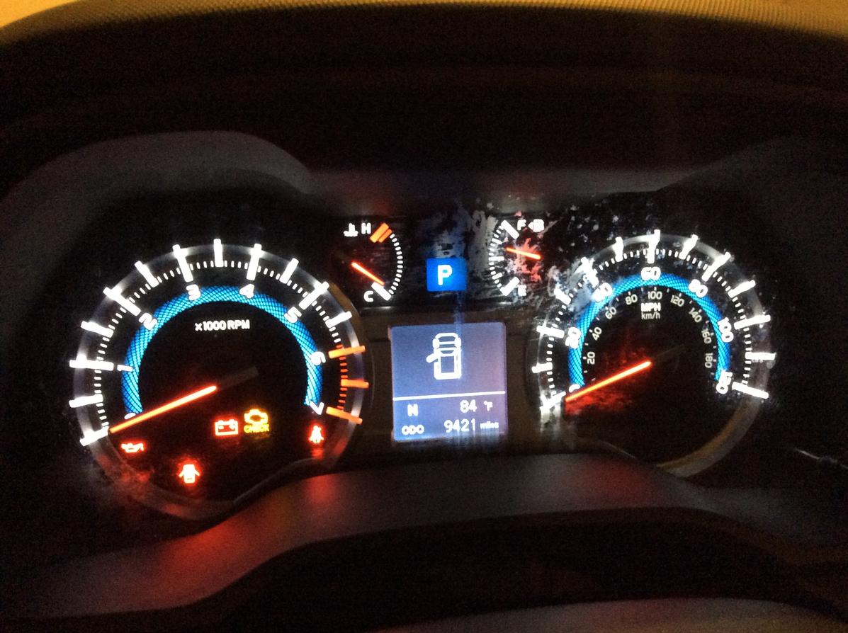

Bought a used 2015 TRD Pro with 9k miles on it. Fantastic car except the glass on the instrument panel is messy land looks like a spill on it. Nothing is broken just annoying. Any ideas on cleaning? I've tried everything. Any idea how to replace? Warranty coverage?

Have you tried a plastic polish/micro fiber cloth? I read you've tried everything, but had to ask. Yikes. It looks as if something splashed on it and etched the plastic.

I am gonna try some plastic cleaner tonight or tomorrow and am contacting a local dealer to see if it's a warrantied part/cost of repair if I can get it clean. Seems to be on the inside of glass. I bought this thing at Carmax. Everything else is in great shape but they don't really repair, nor do I trust Carmax to take apart the cluster and make it right.
I would be concerned about what someone was doing inside the cluster to cause this? I have never seen anyone complain about something like this before, so I doubt it is a Toyota issue.

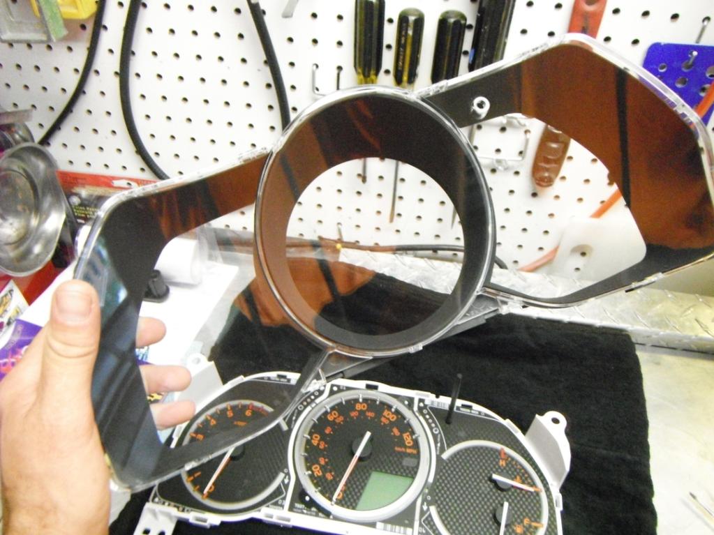

I know on the "early 5th's" you could order that clear plastic cover separately from the dealer (or any Toyota parts place) for relatively cheap (less that $30 in the parts manual). I'm sure you can order it for yours too.
It's really easy to take apart if you are even the slightest bit handy. Here's my cluster apart...
That's what I would do. Good luck!

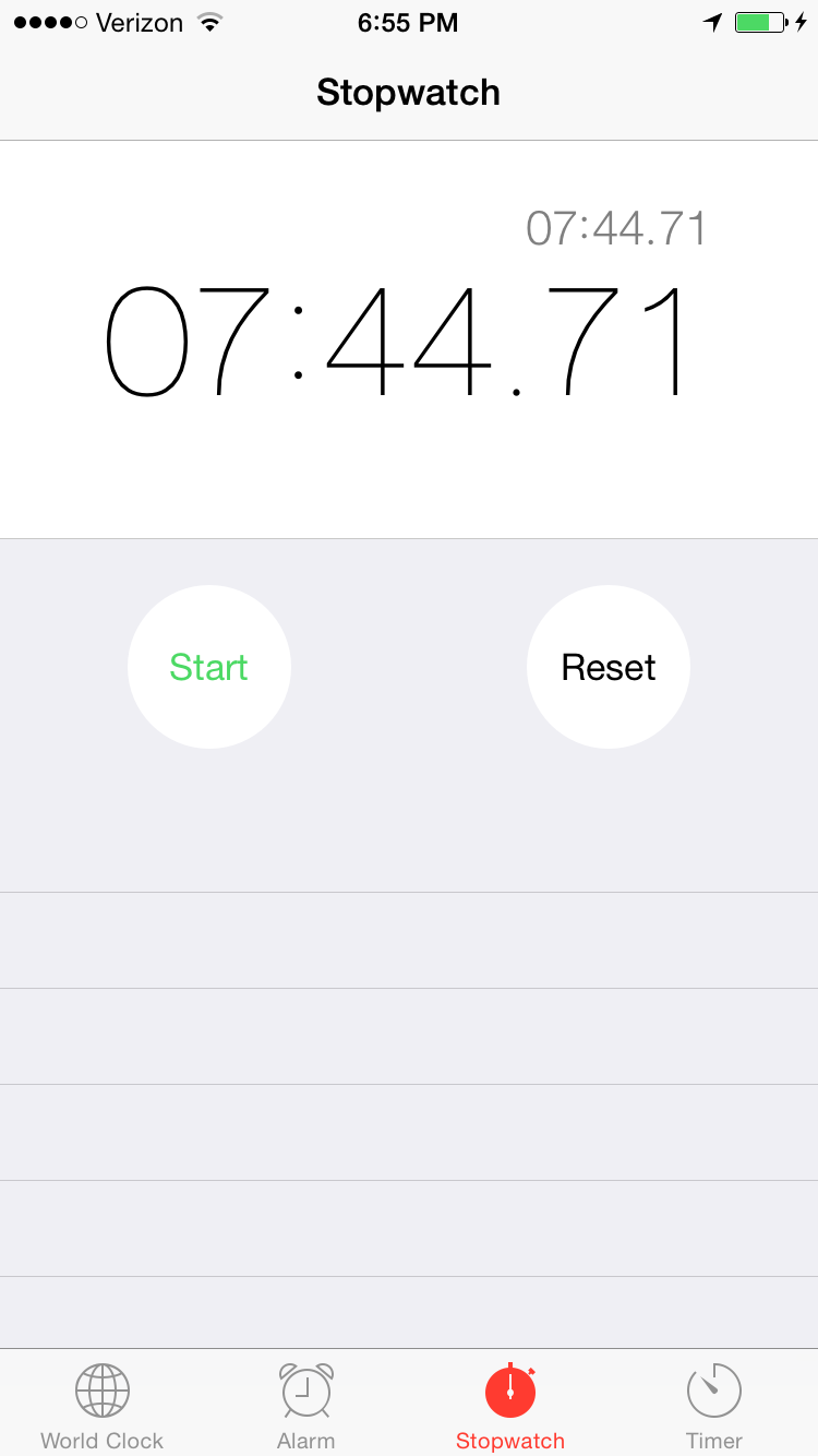

Takes probably 10 -15 minutes if you take your time.

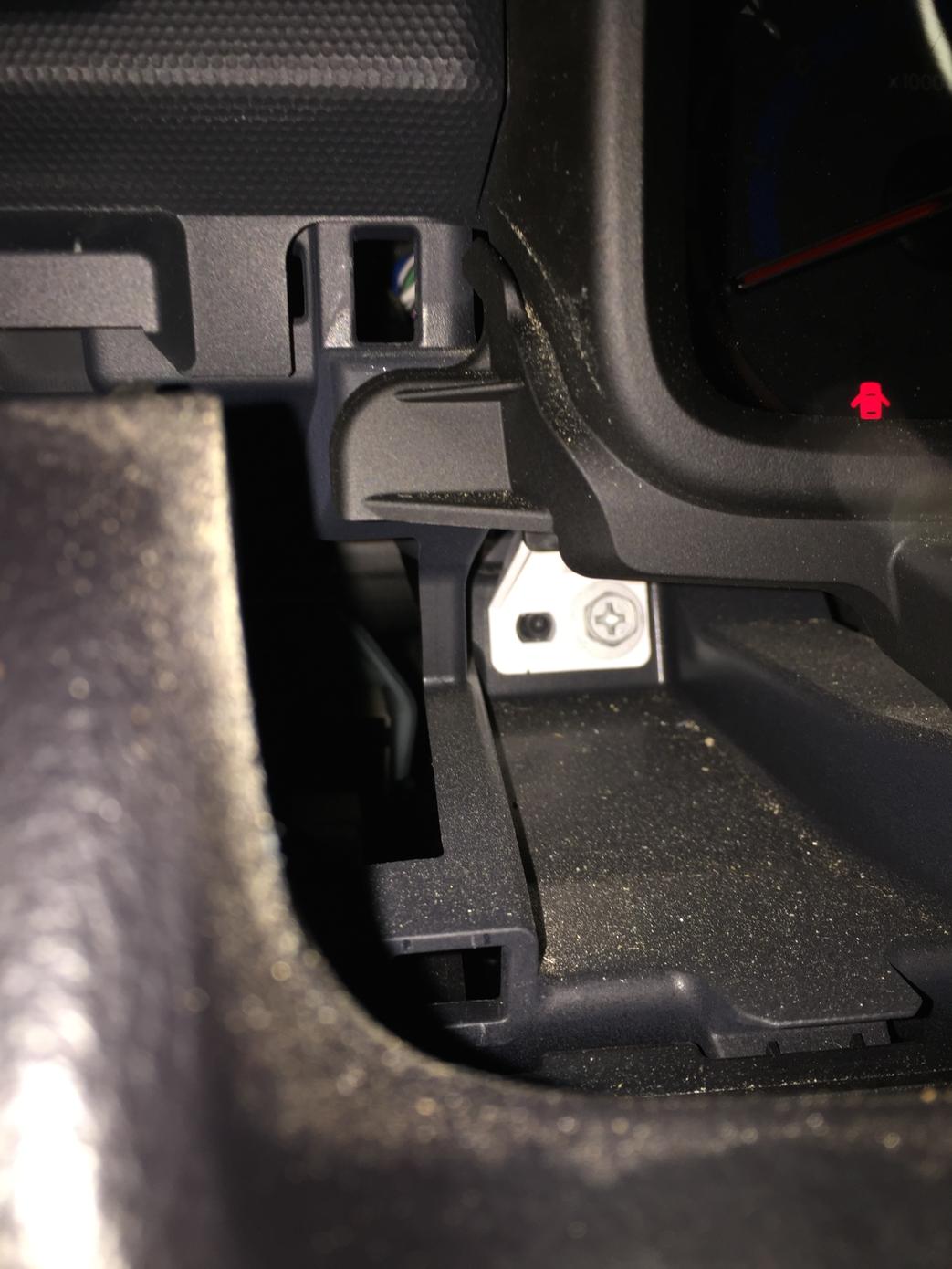

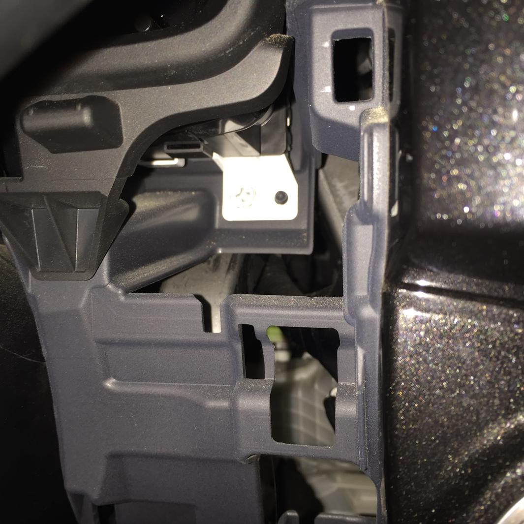

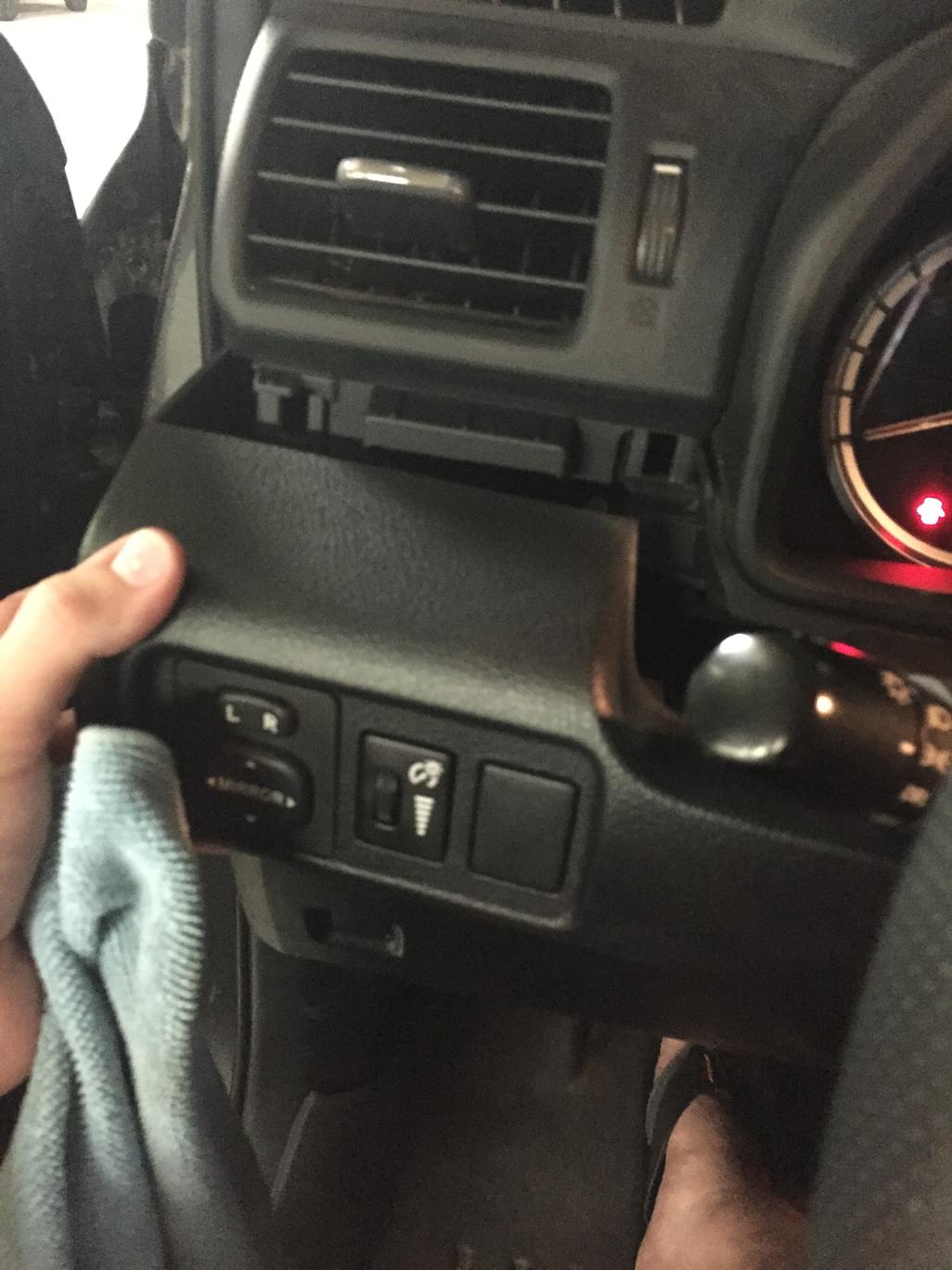

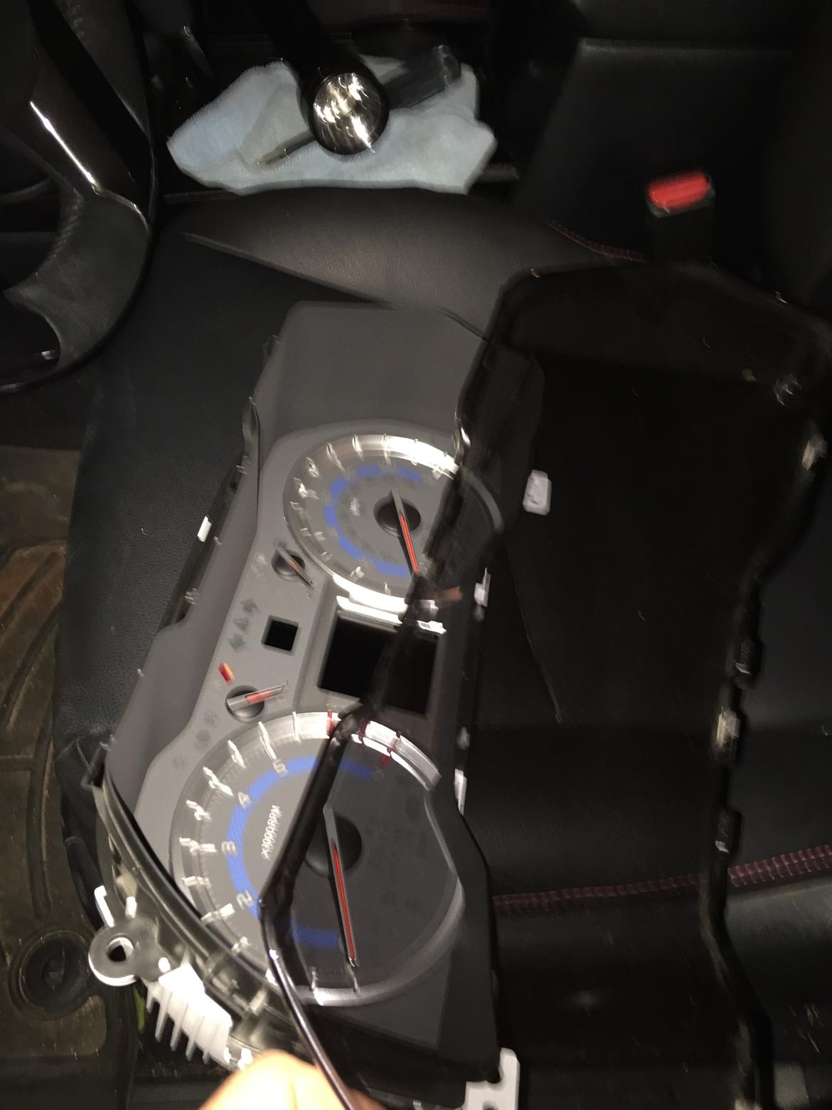

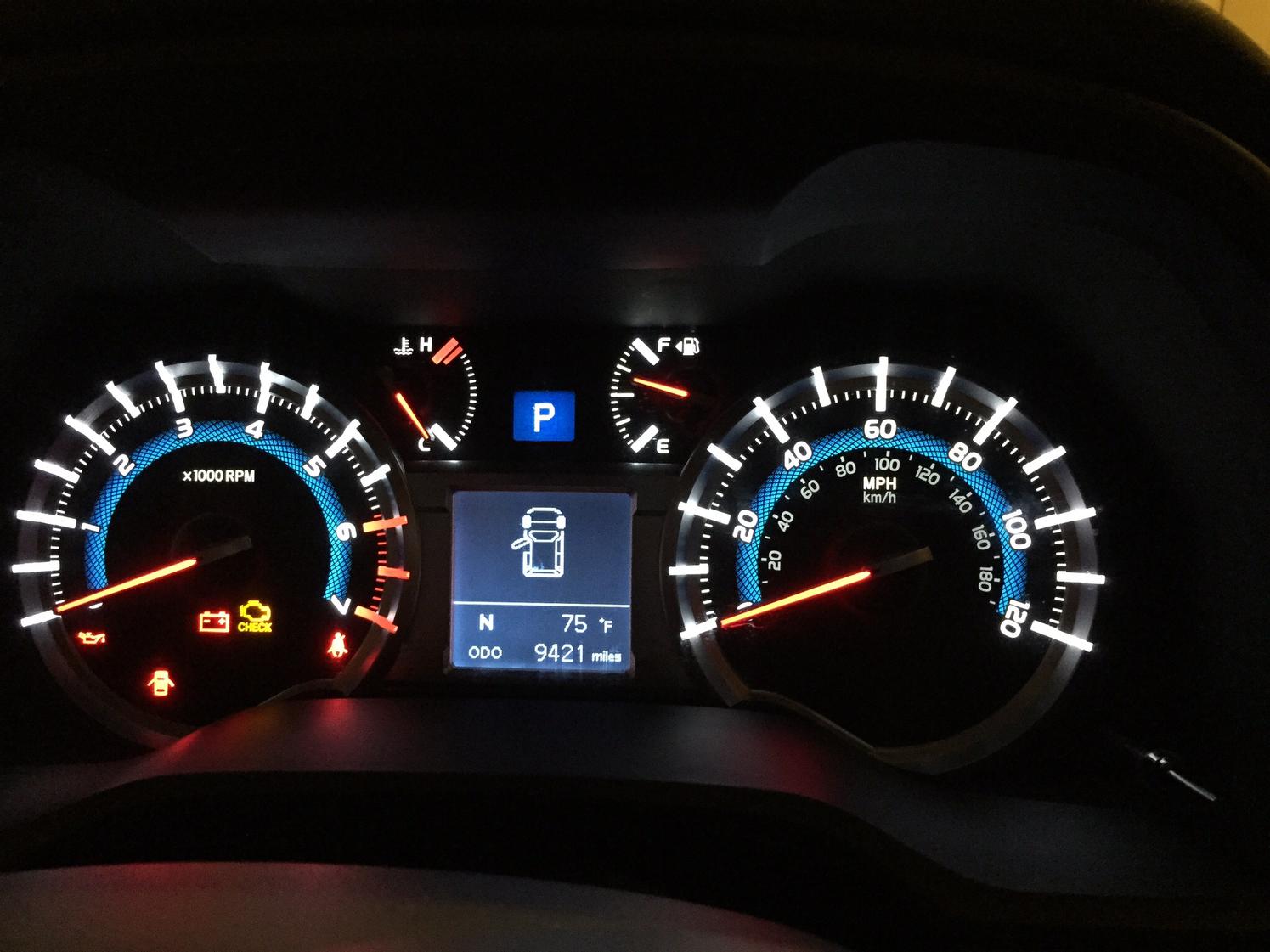

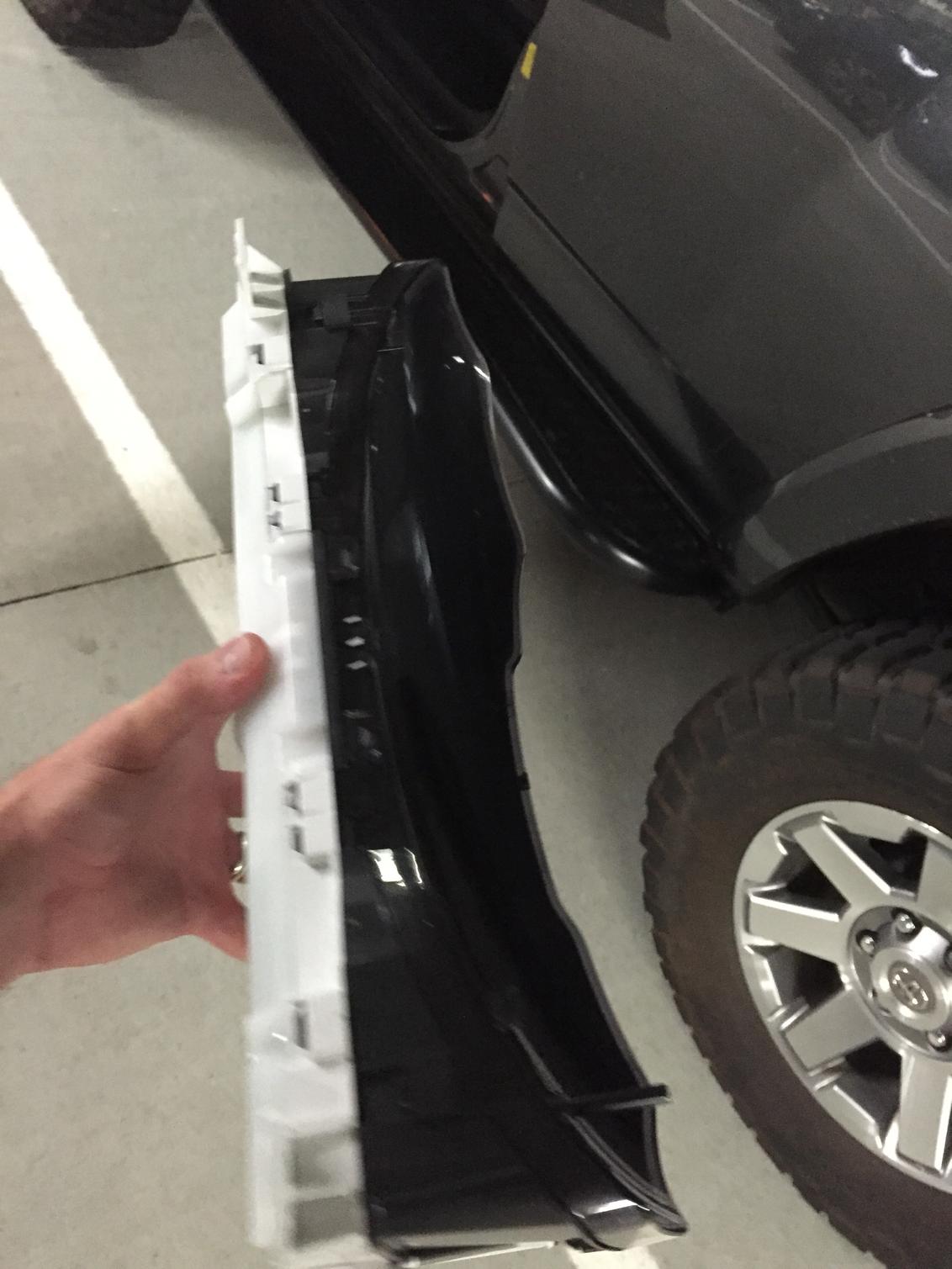

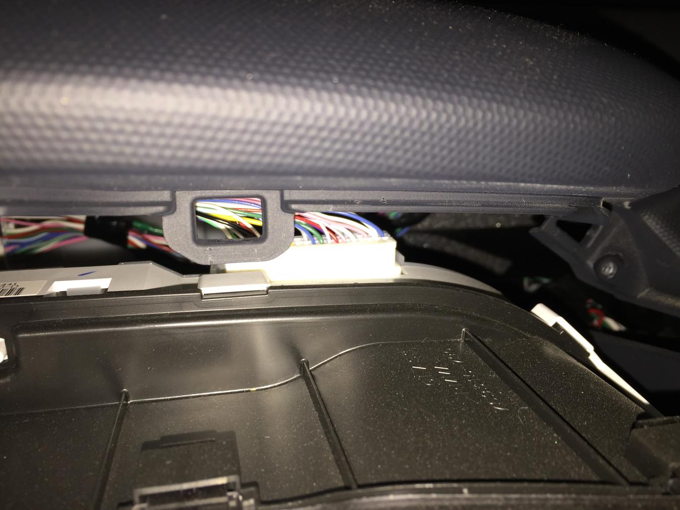

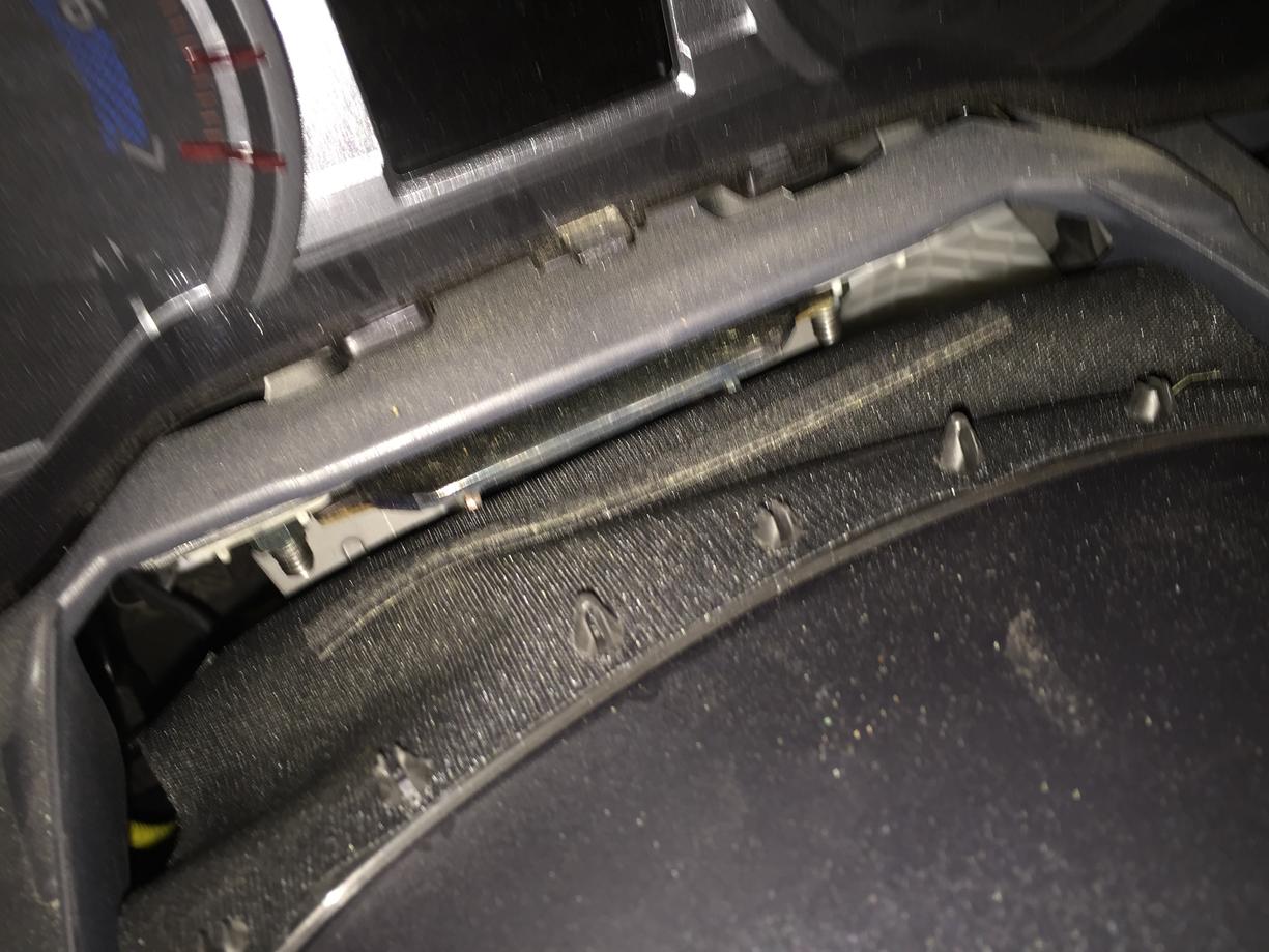

[MENTION=128745]Tamorris[/MENTION] , below are some photos to help you out. Although I will side with the poster who said if you bought it this way I would encourage the dealer to fix it themselves. (free of charge, or at least provide the parts)
Some Key Learnings:
*Make sure the Trip reset pole is back through the hole in the plastic lens, if not you will bend it right over when snapping the lens back onto the cluster (ask me how I know)
*The "dust cover" that goes from the top of the steering wheel column to the bottom of the cluster trim can be snapped off the cluster trim
*It takes longer to reinstall then to remove
Steps:
*Remove Trim panels from the lower left and right of the cluster, under each is a screw that must come out.
*Remove the cluster "trim" , will remain in the truck until next step
*Disconnect the dust cover from the cluster trim, it will remain attached to the upper steering column cover
* Remove two screws at top corners of instrument cluster
*Rotate cluster down to get better access to the wiring connector, remove connector
*Cluster is now free and you can remove the lens by unclipping the 10 clips that hold it to the cluster. I recommend starting with one, then working your way around.

I did not use anything on it. Truck is one week old to me. I think someone did get something like armor all on it though. I used Plastix and it is way better. Still noticeable when you shine a light but way better. I will post a pic tomorrow. See what it looks like in the daylight.
