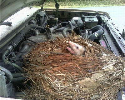

Holy hell, is that real?
Image search “rodents in engines” or similar. I have had three cases of rodents, two mice and one pack rat, chewing up my wiring/engine compartment over the years, always when visiting family in backwoods Idaho. My sister-in-law had her 2015 Subaru Impreza nuked when she left it at the trail head for two days, she came back and it wouldn’t run smooth or steer proper, $4500 later a new full engine harness, she sold it for a Crosstrek. I now leave my hood cracked and put magic tree pine air fresheners in the engine compartment, knock-on-wood no issues to date.

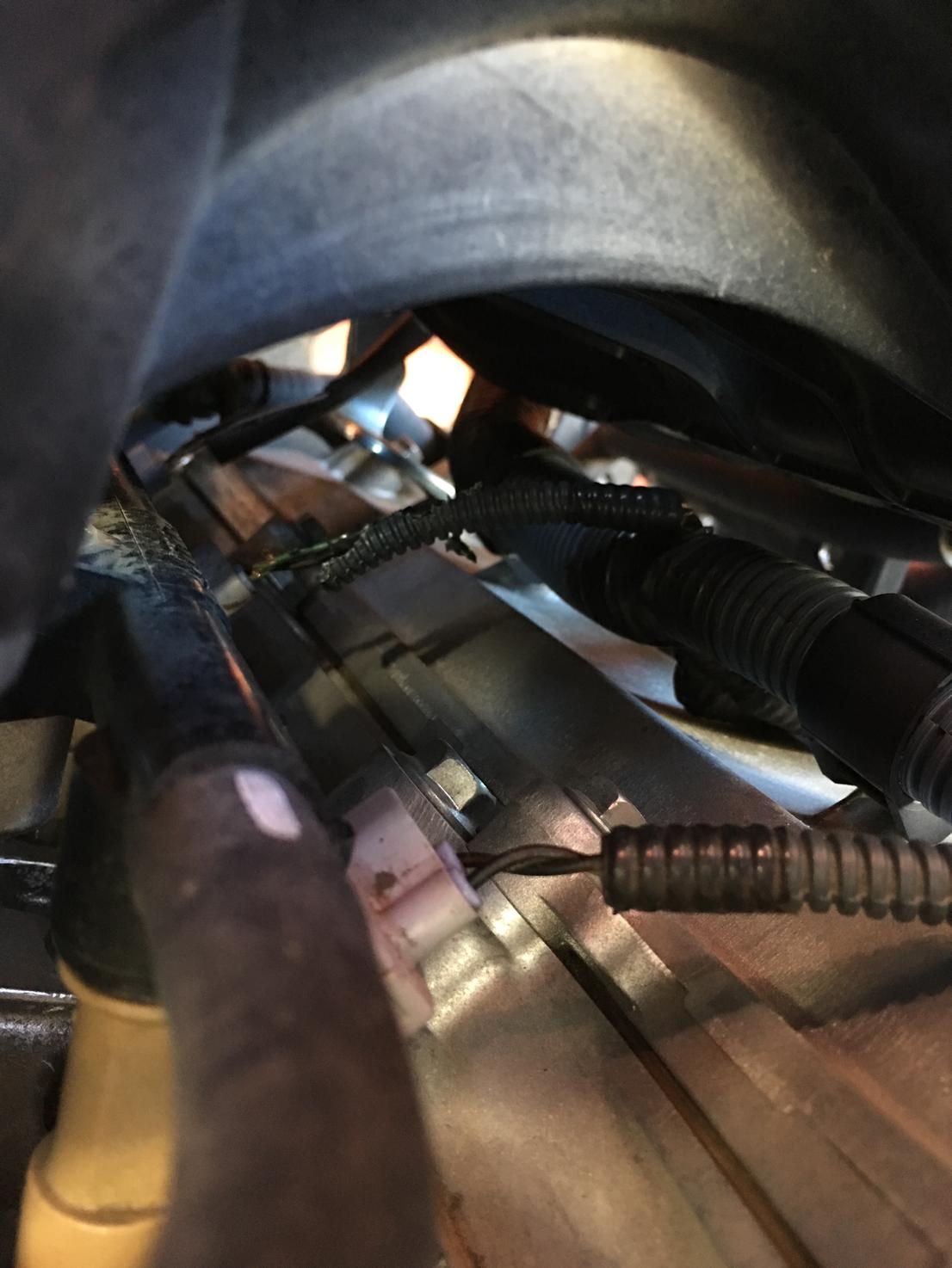

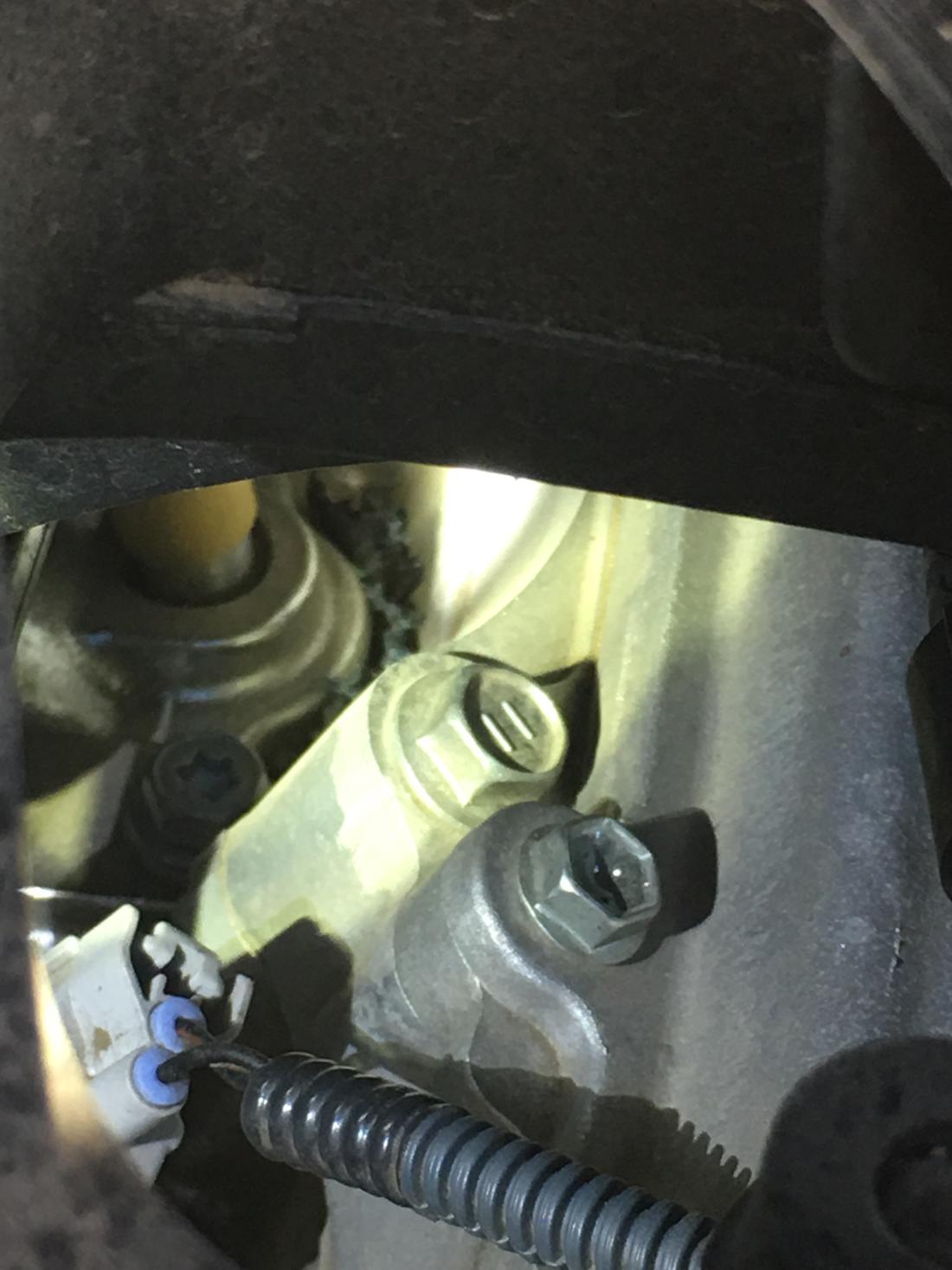

After switching the #6 and #3 ignition coils only to have the same code I decided to search a bit deeper. If I can get the pictures to load you’ll be able to tell that a mouse was the culprit of some chewed wires.
It’s not hard to find a new connector at your local parts store and replace it yourself, if you’re looking to save some money. There’s a lot information on here on how to move the intake if you search. It’ll should take you a couple of hours to get it done. Best of luck to you :hug:
