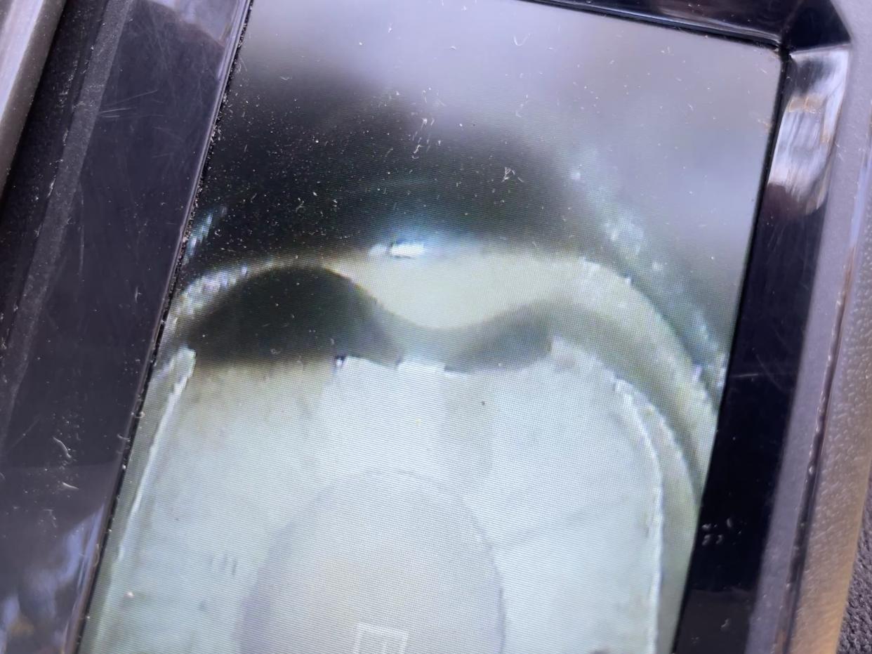

After doing injector it started doing weird idle stuff (idling at 1700rpm, surging, idle drops when ac is turned on) and it was still misfiring, I checked compression and boroscoped through the spark plug hole. Compression was 155psi which was the same as other cylinders on the driver side head. Boroscope shows what I think is coolant, but very hard to tell from crappy camera lol, I’ve attached that photo.
So unfortunately seems like a head gasket issue, unless IAC valve is somehow dumping coolant into only cylinder 6? Anybody have any ideas before I rip this head off and get it pressure tested?

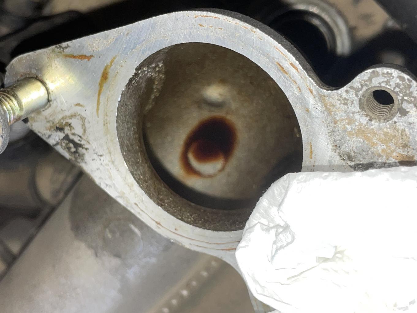

Edit: added a second photo showing oil puddle in bottom of intake plenum, that oil appeared in under 10 minutes of running car, seems like a lot of oil for such a short period? That photo is of cylinder 6 intake tube, other ones do not have nearly as much oil.

Do a leak down test of Cylinder 6 and then you're wondering will be over.

You can pull #6 plug and put inspection camera/bore scope into cylnder and look for steam cleaning caused by coolant.
As Timmy said, do a leak down test. A leak down test was the only way I was able to 100% confirm my head gasket was blown.
Good luck
or coolant pressure test
Or pump up the coolant system to 25 psi and see if it loses pressure. If I had, no doubt i would have been losing pressure in the intake galley, where the clear traces of coolant leaks were.
Our 99 became a "Stanley Steamer" due to coolant passages in head gasket failing.
