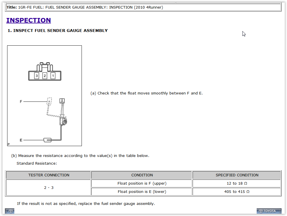

The Techstream program has a module that allows simulation testing of the gauge. Also, you can get enough access to move the float to test for specified ohms without dropping the tank. There is an access panel under the rear seat.
