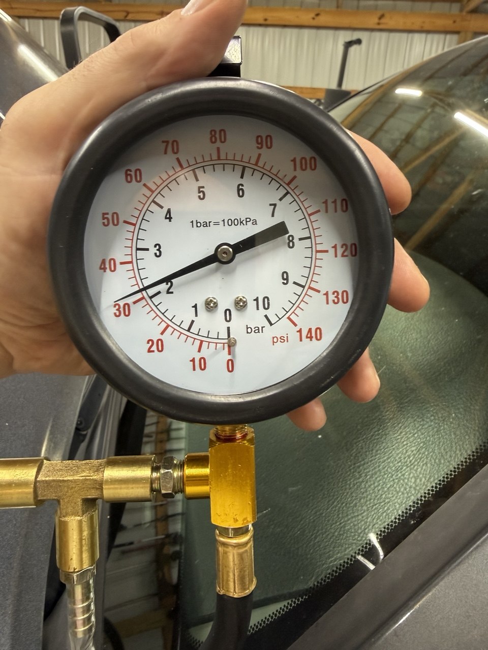

Well, the saga continues. I redid the entire job this morning, confirmed that the little bung piece was not where it should have been, buttoned everything up, and
(Spec is 41psi)
So I now get to do the entire job a fourth time! Yay!
EDIT: What are the odds that this amazon gauge is bad? My PSI did in fact double after this repair, it's just still below spec ACCORDING TO THE GAUGE.
(Spec is 41psi)
How does it run now, still triggering the CEL/codes?
As far as the gauge, these days anything is possible coming from Amazon!
Narrator: in fact the amazon gauge was bad.
I decided before tearing it apart to go try another gauge. Borrowed the Autozone fuel pressure gauge kit. It had basically zero fittings in it so what I did was unscrew the gauge from my kit and swapped the physical gauges.
Started the car up, gauge instantly hit 41psi on the nose.
Put everything back together, went for a drive. Completely fine.
