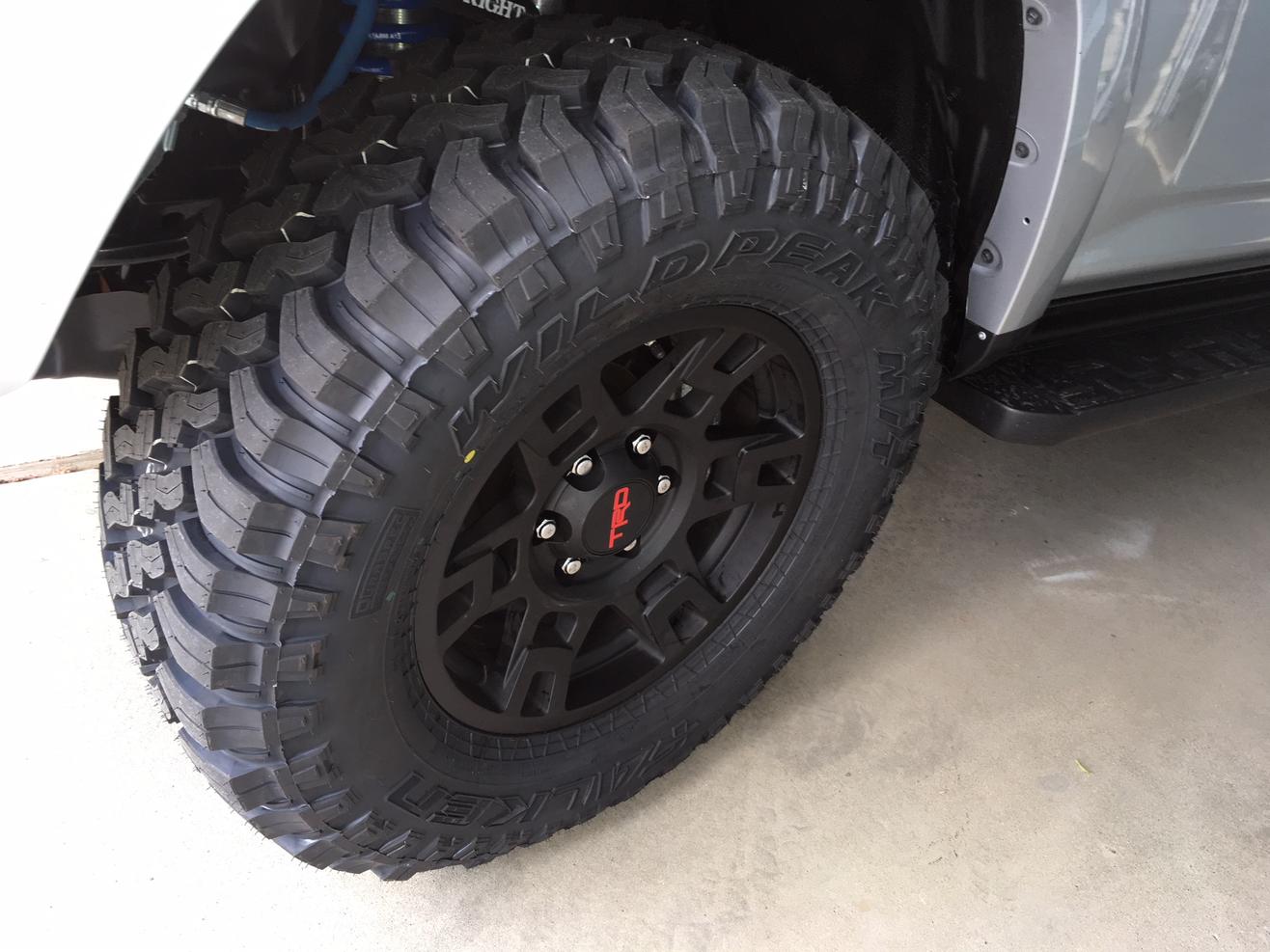

I think that is an acceptable diagnosis and assumption to come to. While I have the locker rear end I think that I can make out the same whine going on at light application of throttle at those speeds, I cannot reproduce it coming off the throttle however and it depends on weight in the vehicle too. I've heard it since new but we have very few stretches of decent highway pavement around here its tough to keep hearing. I think a lot has to do with the poor floor insulation, thin carpet, a lot of road noise comes through at higher speeds and this slight gear noise or whine coming off the long drive shaft is nothing to be concerned over. I'm not but I'll probably change the fluid on a severe duty schedule anyway just for peace of mind.
Make sure your tire pressures are at 35psi maybe too, I had to lower mine when new they had them up almost at max inflation levels, maybe for better mileage but the tire noise changed when they got softer (more quiet), less road amplification.

It's hard for me to tell, only have about 7,000 on her.
