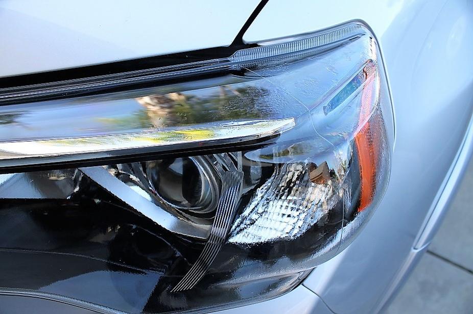

Hello,
My headlights dont necessarily have condensation, however there are water marks inside the lenses that are forming. It looks like water drip marks, again its on the interior of the lenses.
However, ive never seen the headlights have condensation... Kind of hard to take pictures but was curious if anyone else has noticed this?
This is on both my headlights, so cant really tell if its a isolated issue.

I think this is a bad headlight design to put on aftermarket HID. My other 2 vehicles also with HID installed don't have the condensation even though the rubber o rings are questionable looking.

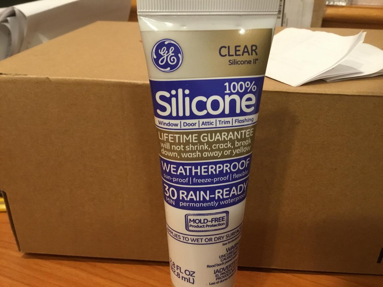

I just used some silicone sealant
