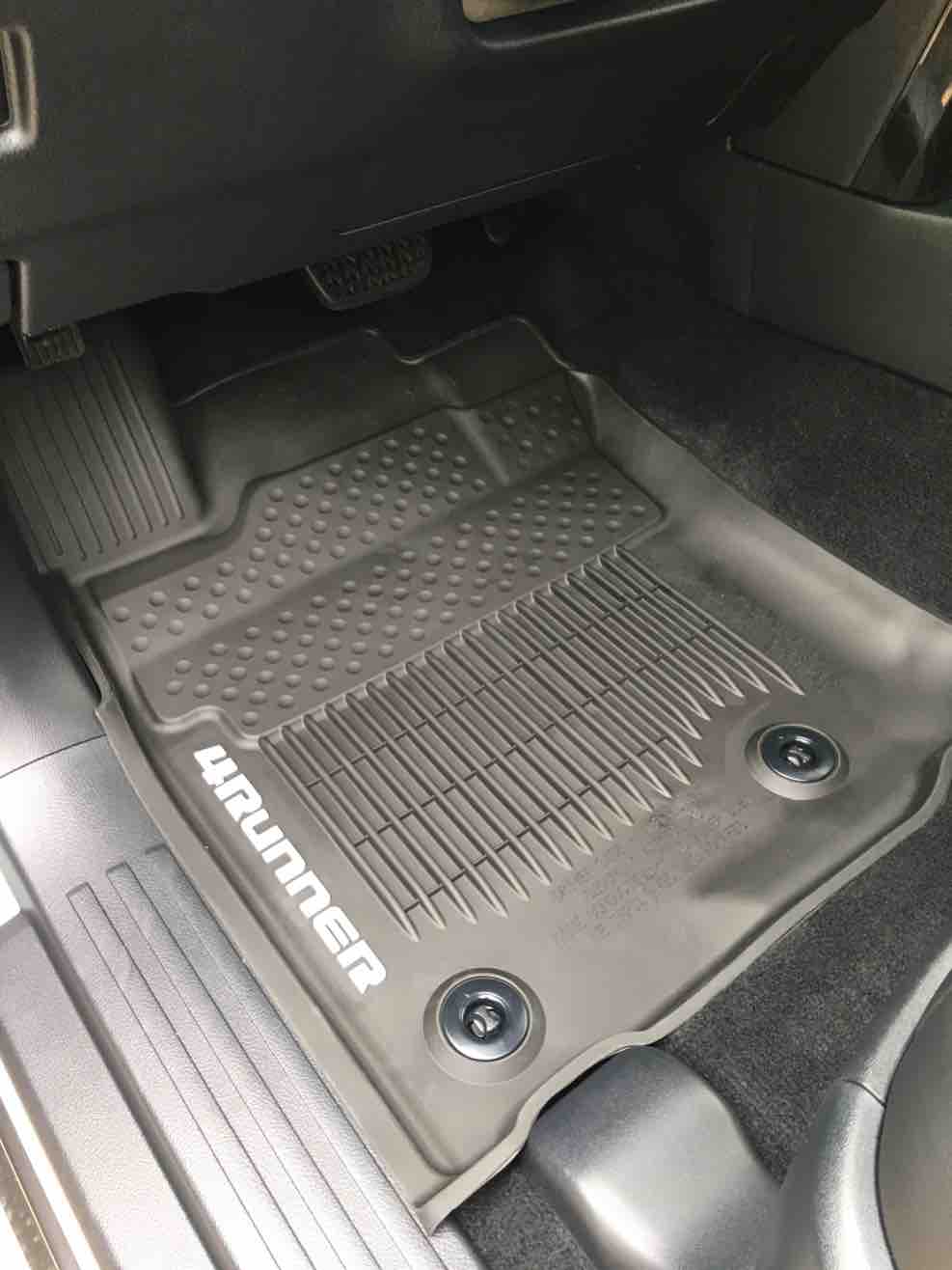

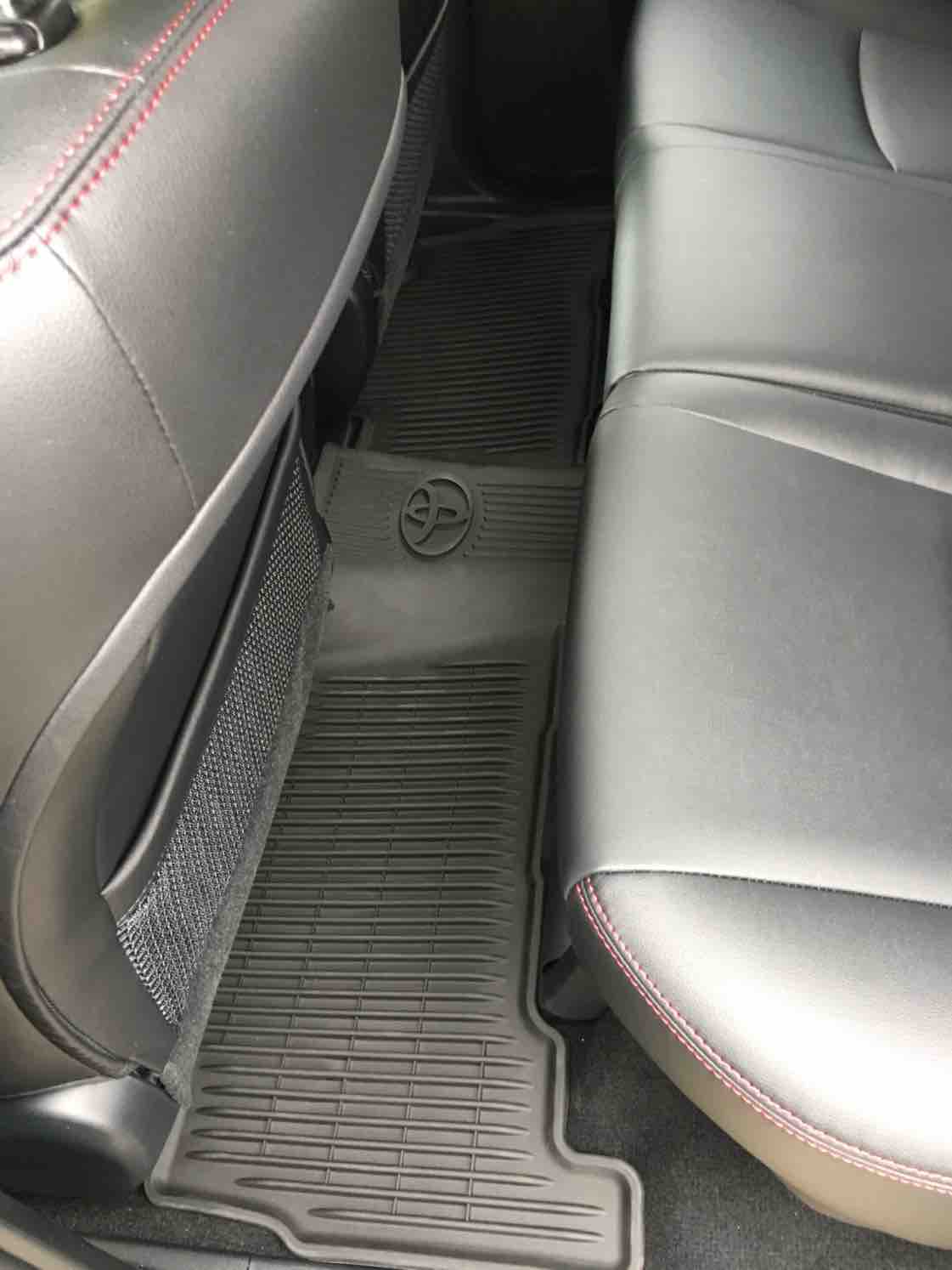

New mats came in.

Now those are nice. I have been waiting to see those in someone's vehicle. I will get them.
I purchased them for my trail a few weeks ago! Totally worth.. very impressed in this OEM product especially for the price as compared to weather techs etc.
Agreed, especially considering you can get them on Amazon for $60 less than if you add them on as an option.

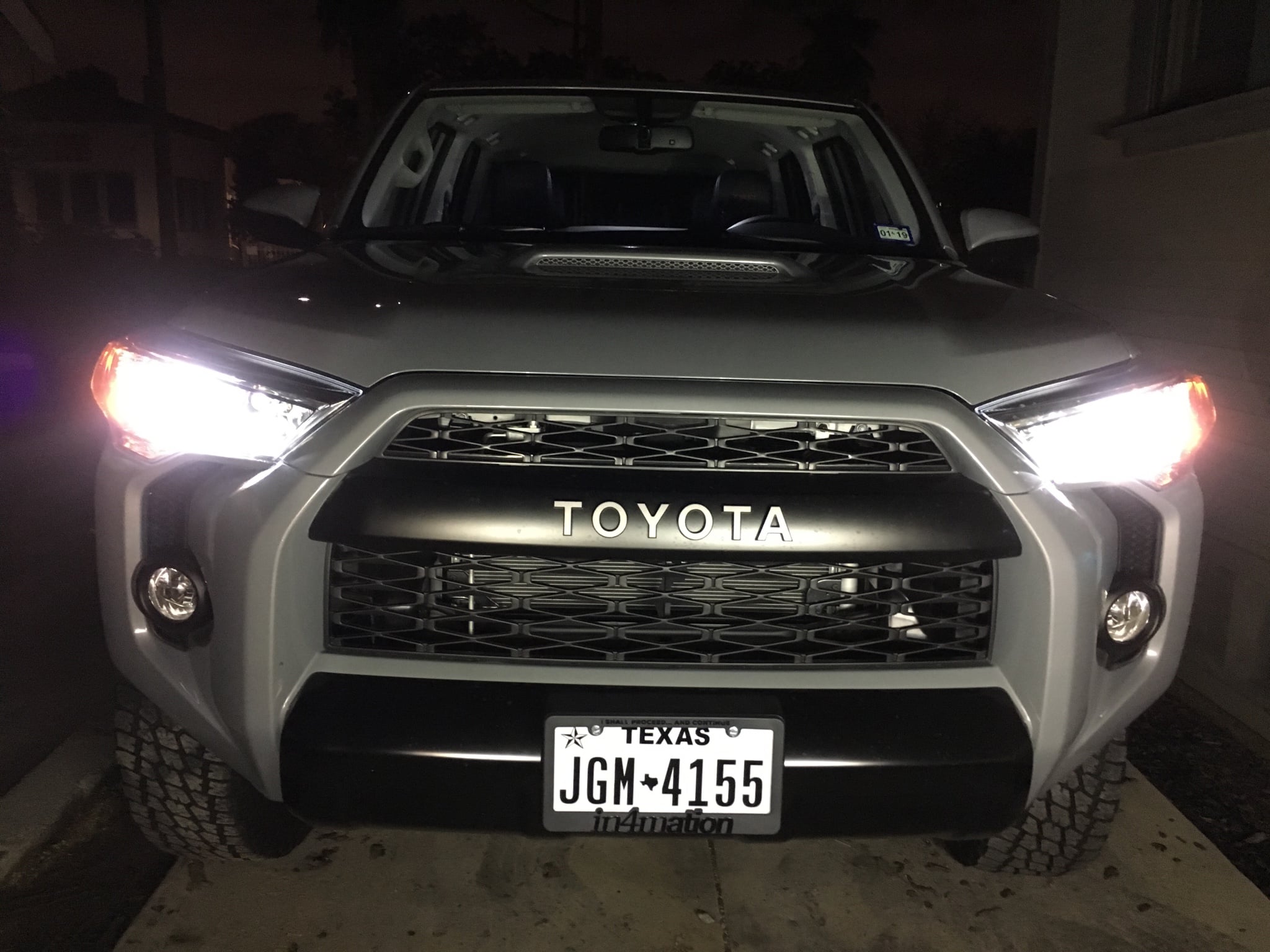

Had an issue with the right HID but got it solved today. Really great upgrade and pretty easy install. Thought I'd post a night shot this time.
Ditto - what was the issue? I have the same kit and my passenger side HID seems to be brighter when I see the reflection off other the rear of cars in front of me
It stopped working once I mounted the ballast. It was just a connectivity issue inside the dust cover. Had to feed more wiring out of the area inside the dust cover and reconnected everything. A little harder to put the cap back on but it worked.
As for your light being brighter. I'd take a look while you're out of the car. Could be one of two things. 1) just the angle of the reflection from where you're sitting or 2) the aim of your passenger light might be slightly off. There's info on aiming online if that is the issue. You can test it against a wall to see if there's a difference.
