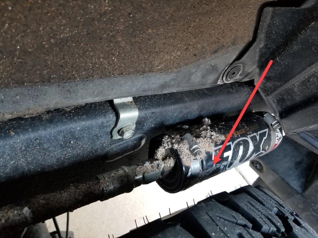

I have a 2017 ORP with Fox 2.5 with front and rear resis, 2" Icon rear springs and 285s on stock wheels. Rides great but the rear tires rubs the resis when stuffed. The Fox hose to the resi is 18", stiff, and short making resi placement difficult. Shock supplier said to add wheel spacers but I'm not a fan of spacers.
Have you found a place to mount the resis without the rub? Pix would be awesome!

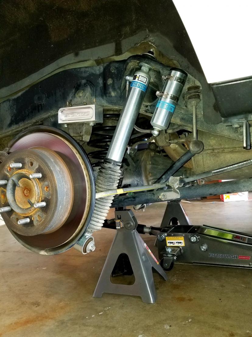

Not Fox, but this is how & where most of us with Bilstein 5160's mount our resi. Or just get the mount that attaches the resi directly onto the main shock body. GL
