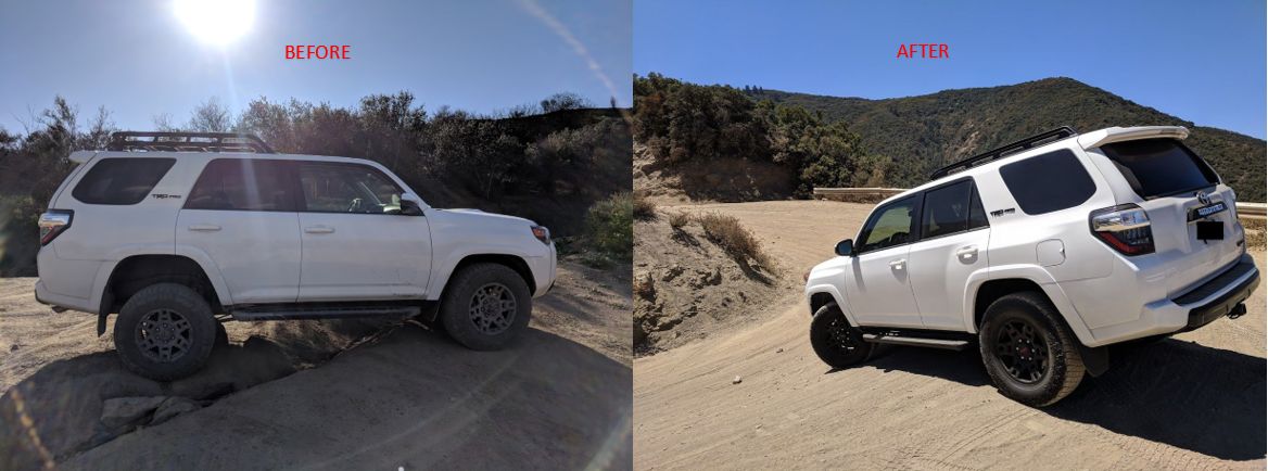

2019 Pro Basket Rack - Deleted :(
I had to take apart the back to get the headliner down enough to reach the bracket when I completely stripped and then drilled out the head of the bolt. It wasn’t hard and with some plastic pry tools it was a simple evening job. Took me about 30 mins to undo and reinstall.
Thank you for your help. I can't believe these brackets are so cheaply made and/or Toyota does not make a rack that for the TRD Pro that can be more easily removed.
[MENTION=109703]niadh0[/MENTION] thank you for that write up. I'm sure it just saved me a ton of pain replacing my 2019 Pro rack today.
I ran into the same issues and then some. The loctite was so heavily caked on to the bolts it was making impossible to screw out. Ending up making these worse for myself by stripping the head of the screw. Decided to surrender and bring to the dealership's service to get professionally removed as I didn't want to make things any worse than i might already had. Service technician couldn't even get 2 of the bolts out as they were cross-threaded into the bracket (which not sure if this was caused from my own attempts to unscrew or if it was just a bad implementation at the port), and couldn't continue to remove even after cutting the bolt head off or else the bracket inside could mess up the body. So ended up having to order new brackets to replace the old that had the stuck bolts. Just wanted to share the nightmare this roof rack put me through.
My AG Pro arrives on the 14th and after reading some of the posts here I think I may just have the dealer swap this out before delivery. I think the standard rails look so much better.
