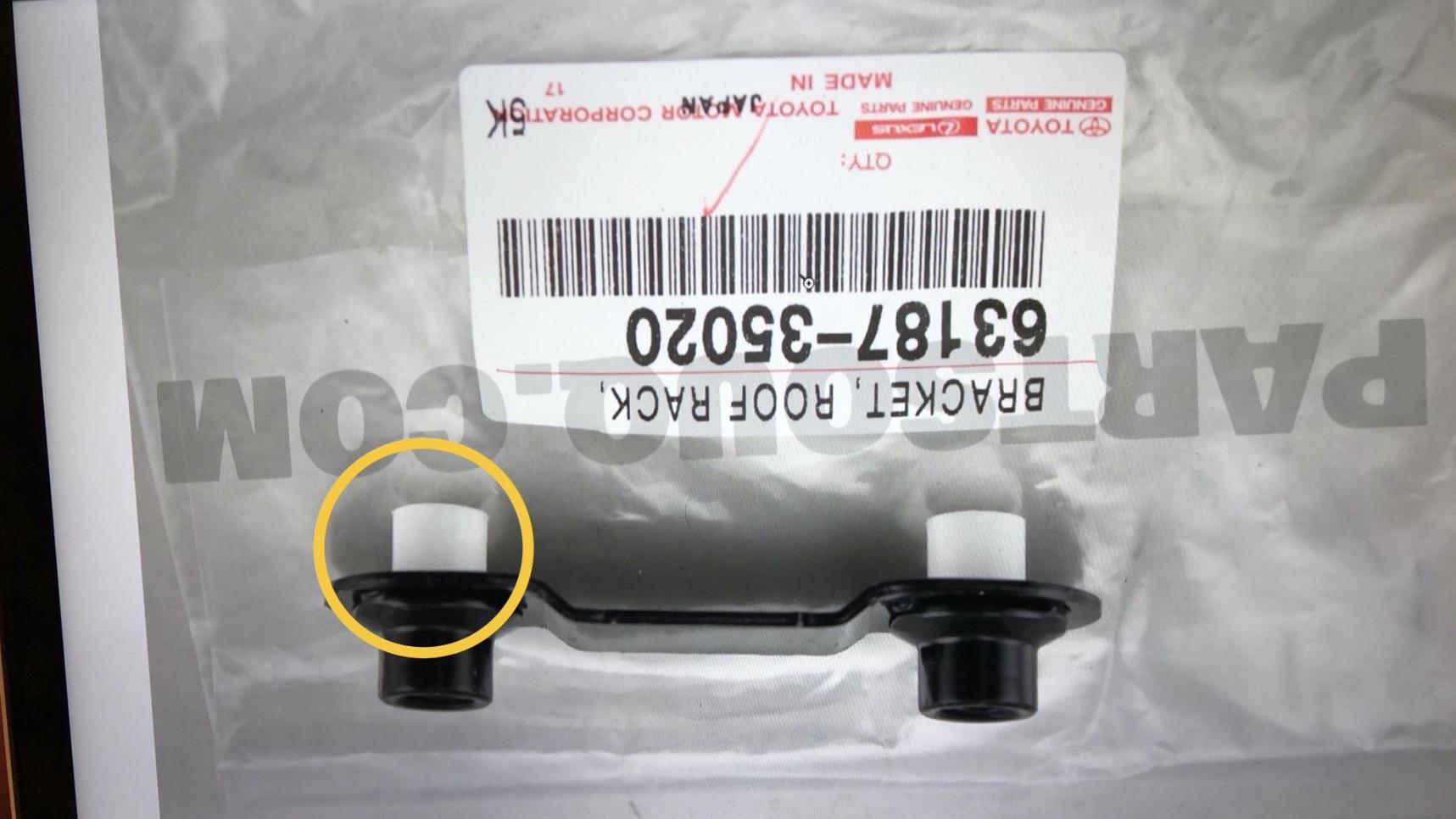

There are two mounting designs among the 5th Gen 4runners.
1) 2010-2013 Trail, and now 2019 Pro has the same mounting design. This design places a metal bracket between the rack and the room panel. Not counting the rubber piece in the middle here. Inside the room panel, for each side (front, rear, left, right) there are two short plastic cylinders coming out where the bolts would go in. The one bracket I mentioned sits around these cylinders. You then put the rack in place which sits perfectly inside the room panel cavity where the cylinders and the bracket is. I do not see anything inside the panel that falls out or gets lost within the roof panel. The bolts uses a "*" type socket. I bought thin rubber washer from Lowes that goes on the bolts. When you take out the bolts, the cheap washers mounted by the factory will rip and you can not save them.
2) The remaining all trims in any years between 2010 and 2019 has a second mounting design which is very simple compared to the one I explained above. straight bolts and regular socket. a thick rubber washer is used by toyota which can be reused. no special bracket sits in between the rack and cylinders that accept the bolts.

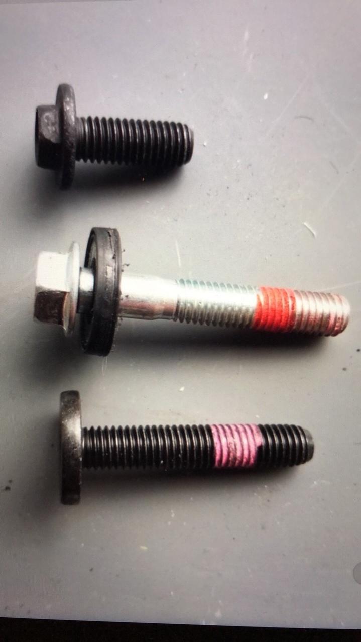

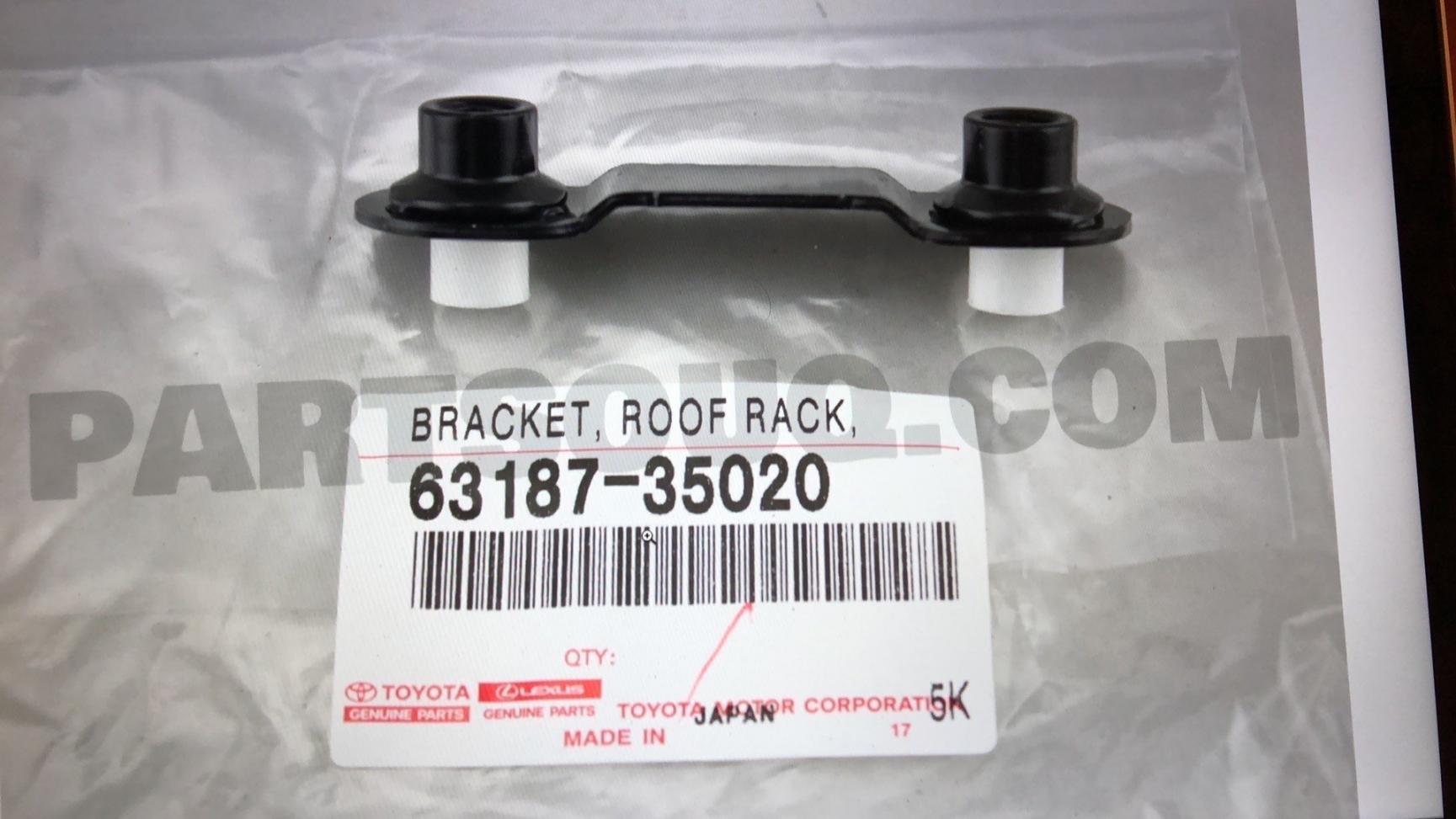

here are some pics.
the first bolt comes in the roof-rack-delete kit
the second bolt comes in the non-pro non-2010-2013-Trail rack
the third bolt comes with the pro and 2010-2013-Trail rack
the bracket is pictured

here are some pics.
[MENTION=109703]niadh0[/MENTION] thank you for the help - really appreciate.
Any idea if the bracket is the same on all versions of the truck, or is that specific to the Pro/2010-13 Trail rack?

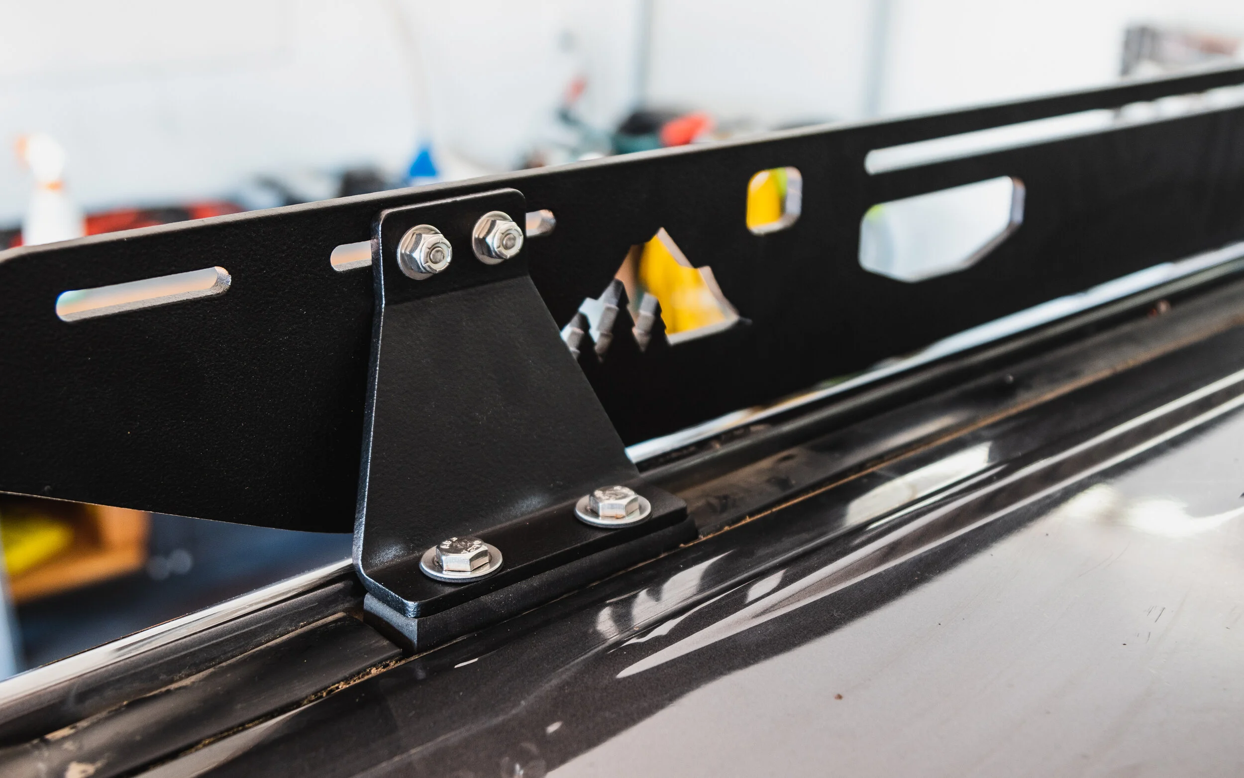

The reason I ask is that I'm planning to get the Sherpa Crestone rack for my 2019 Pro, but I'm trying to figure out if I will have install challenges because of differences in h/w in the mounting system between the Pro rack and other models.
The way their rack mounts is a rubber pad direct to roof, which is very cool in that no silicone is needed to keep out water, but if those white plastic sleeves are unique to the TRD Pro rack, will prob create fitment issues.
(Yes, I asked Sherpa, and got a "should work" but I'm a measure twice cut once kind of guy, so I'm trying to confirm before I order, rip off the current rack, then discover issues ...)
based on the picture you posted, you just need to make sure that the bolt you put on with the aftermarket rack is just long enough to be bolted properly to the bracket.
as for the bracket itself (especially the white tube that pops out - which guides the bold and serves no other purpose,) I know for fact that the Limited, Trail, TRD OffRoad, TRD Pro all have it. I have owned all of these model except for SR5... so I highly doubt that SR5 will have a different bracket.

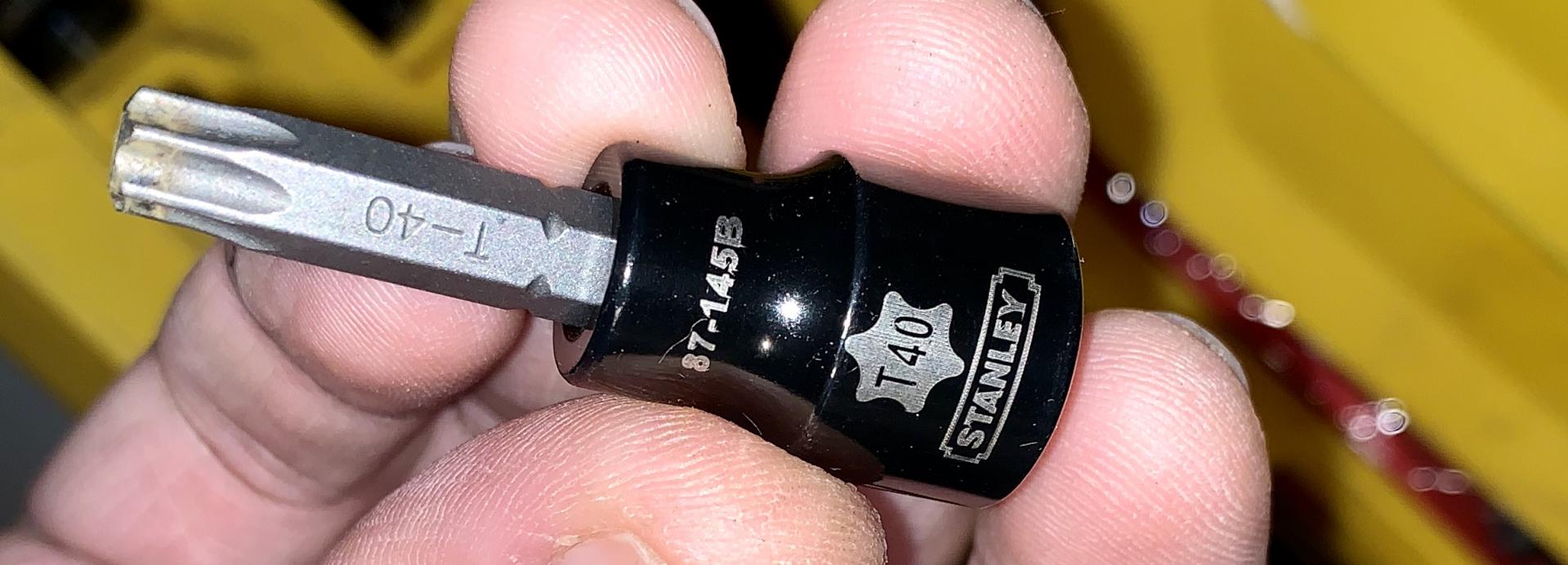

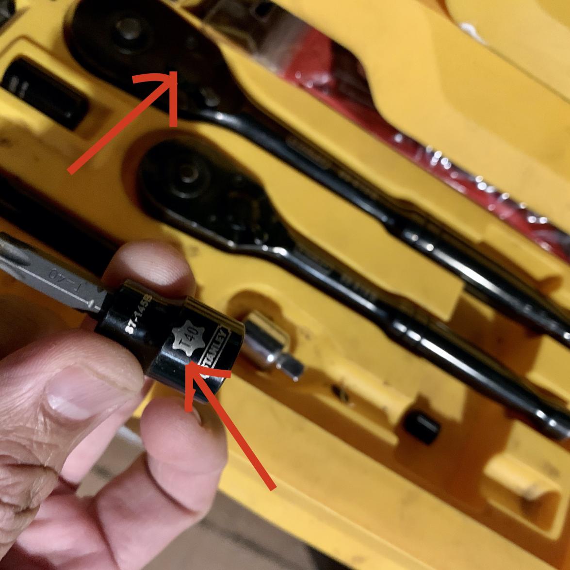

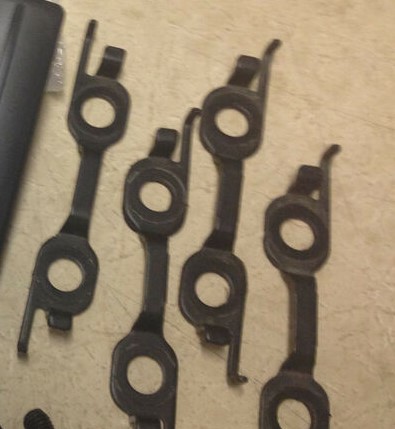

I have had people reach out to me for tips regarding removing the Pro rack. Yes you need to be careful when you unbolt the rack.
(1) get the longest Socket Wrench you can find. The longer the wrench handle the safer / less risky this is going to be
(2) get T40 trox Socket and attach it to the wrench

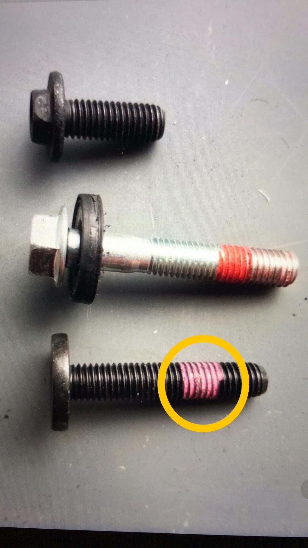

(3) take a look at the picture attached that compares all type of bolts that come with the pro or non-pro factory racks. you will need a regular socket to remove SR5/Limited/2014+ TRD-OffRoad racks. you will need T40 socket for the TRD-Pro and 2010-13 Trail racks.
(3) repeat the following for each bolt on the roof to remove the TRD-Pro factory rack...
(3a) make sure the socket is properly engaged into the bolt. maintain continuous contact and don't let it come off
(3b) EXTREMELY SLOWLY but FIRMLY move the wrench counterclockwise while keeping the turning momentum at consistent speed with constant FORCE. Utilize the LONGER handle of the wrench to ensure you are not turning the bolt with sudden/accelerated momentum by using excessive force
(3c) if the BOLT being turned has excessive Lock tie/glue applied (circled in the picture - blue or pink), then you will feel that the BOLT is not easily turning. In such case UNTURN and TURN several times, and feel that the resistance is going away. This is a critical point of failure if you don't do it right.
(3d) MAKE SURE not to take out the entire BOTL... you need to work all ALL eight bolts at the same time... a few turns at a time. By doing this you are making sure that you won't bend the Bracket inside the roof and you are preventing it from spinning inside when taking out the second bolt
(4) if you manage to take all bolts off safely then you have done it. Life away the rack and make sure you also take out a butterfly shape type metal retaining thingy that you will find between the rack and the holes in the roof (you will see the while cylinders circled in the picture).
so there you have it. some people have NO issues no matter how they remove the bolts... that is because the PORT installer put just the right amount of glue on the bolts. some people have nightmare with this because they rush to take the bolts out and run into bend brackets and stuck bolts - thats because the GLUE put at the PORT is excessive.
sorry I am very wordy here...but its for your own benefit.
when it comes to mounting a replacement rack.....
- if you are using an after market rack, then use what the rack comes with
- if you are using a 2010-2013 Trail Edition rack then you will need to use the metal-double-hole-bracket before you put the rack on, and then use the rubber factory washers in-between the rack and the bolt.
- if you are using a non-Pro and non-2010-2013-Trail rack (which mean the standard silver, chrome, or the black 5th gen rails), then you do NOT use the metal-double-hole-bracket (that you found under the Pro tack) before you put the replacement rack on, but still use the rubber factory washers in-between the rack and the bolt.
BTW if the factory rubber washers are worn off like you said, then buy equivalent ones from a local hardware store. - or- you can buy a Toyota hardware kit that comes with bolts and the washers.
all the best.
