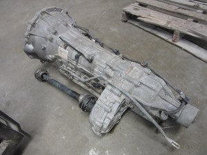

What I've read suggests it may have some pretty neat features. Namely *real* torque vectoring with ability to overspeed any individual tire. If that's actually true (I'm skeptical) it means it has a planetary gear set on each axle - or maybe a planetary in each side of the center diff to overspeed that axle then brake one side? I have no idea.
My best bet is that it's simply the same awd transaxle they've used for a decade, only balanced ring gear front/rear (currently front diff is 4.40 rear is 2.20 so the torque split is heavily front weighted). Current version in the Lexus models does have a push button center diff lock. My guess is that it's the same thing in the new rav4 with brake based traction control and a matched gear rear differential. If that's the case - it'll be very similar to the Jeep products in how they go about doing it. And it would probably give an SR5 a run for its money in stock form - not durability, but capability on a trail on a given day. The SR5 will probably do the same trail every day for 20 years that would destroy the Rav in a few weeks. BUT... lots of folks like the Jeep GC and it's the same idea. Works pretty well for infrequent trail duty.
I think the Lexus IS/GS awd platform is ripe for transfer to a Highlander. It's a separated front differential and a much more complex AWD system that RWD biased and can transfer 100% of torque anywhere. If that is the basis for the new RAV - I'd be shocked, and also really impressed. It's the best AWD system I've ever owned. Much better than my RX350, and kinda wasted on a sedan IMO. It belongs on a crossover that's dipping a toe in the offroad world. It has a real transfer case, front drive shaft, and a front diff that's very similar to a 4runner. It's practically built for this - if they'd ever do it. Highly underrated because it's not put in the right platform. It requires longitudinal engine mounting among other things and packaging for a grocery getter isn't easy.
It will not be a viable replacement for a 4runner though. For starters it's a transaxle. That means no lifts other than very mild because you can't drop the front differential and the entire structure makes it very hard to do much with. Like a Honda Ridgeline. It's just not made to be lifted or be possible to lift much or at all.
