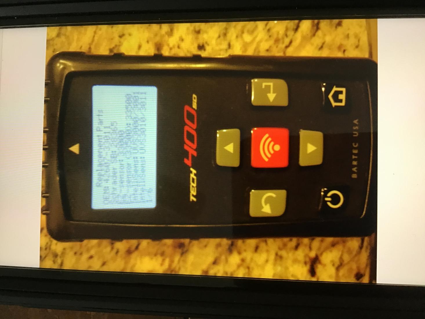

Called the guys that make the computer/reader of the tpms sensors, Bartec, and they said that Discount has their own proprietary deal with them. They get a special model 33520 sensor and reader. The universal, dual channel tpms sensor that works both 315 and 433 mhz is the Schrader EZ-sensor 33500. That sensor works in the 4runner and can be programmed by anyone with a Bartec scanner other than Discount.
