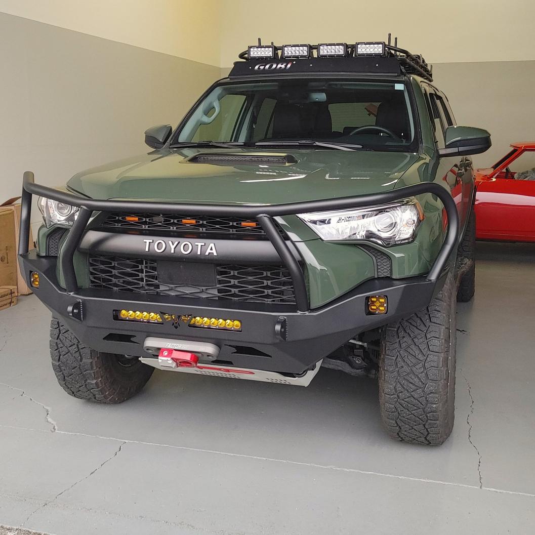

I love my Victory 4x4 bumper. FYI, buy steel if you plan to use for recovery. Aluminum is no go... Wanna know how I know?

Bumper+winch ~177lbs... Plus fogs and light bar so roughly 185lbs give or take? Stock fox suspension would not handle that so I did the toytec aluma 2.5s at the same time.
