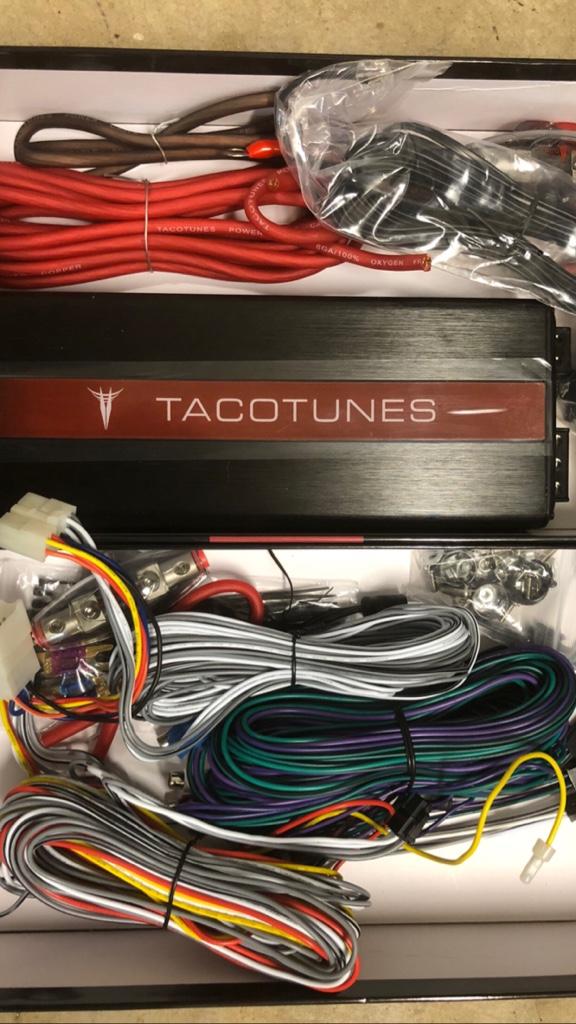

Alright everyone, so I searched to see if anyone was running any aftermarket subwoofer setups using the stock 2020 head unit and to no avail I ended up reaching out to tacotunes for their 5ch amp with matching wire harnesses to make a simple install.

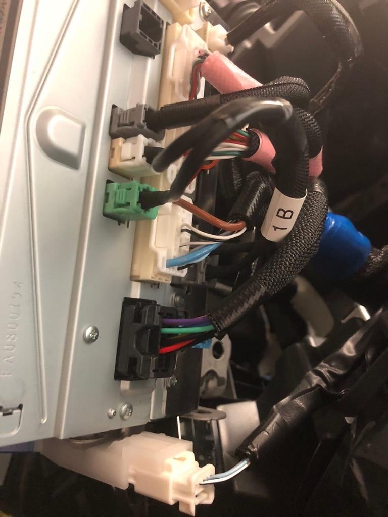

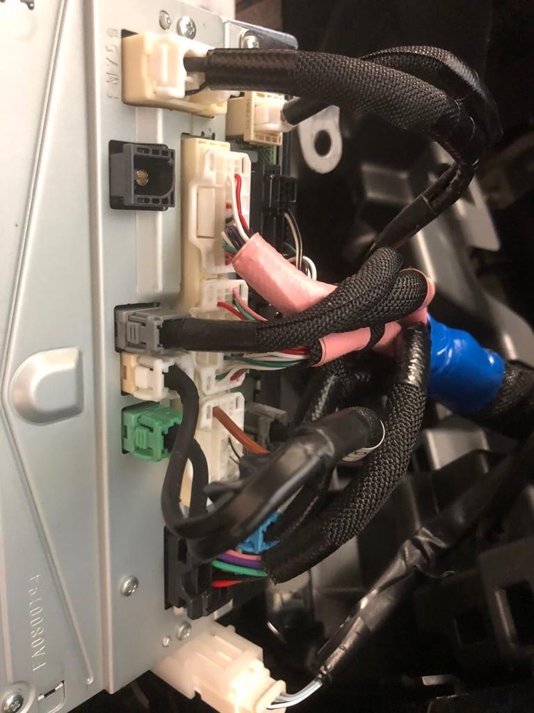

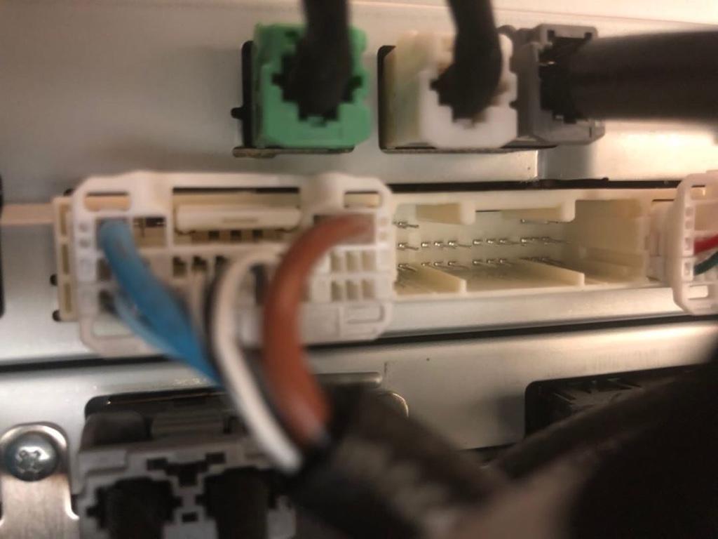

Welp that went south IMMEDIATELY! I get the kit everything works until I get to the back of the head unit on the 2020, none of the pins match and harness received from Taco Tunes, does anybody have any experience with this. I reach out to taco tunes but haven’t got a response yet, it is the holiday weekend so I’m hopeful that within the week i can get a correct part shipped out.
However in the meantime, who has a plan B!?!?! Lol
Some photos for reference.
The 2020 4runners have different plugs from 2019 and older.
technically you can use:
Metra 71-1765 (reverse harness to OEM radio head unit)
Metra 70-1765 (harness to car)
which is expensive...
Amazon sells a generic kit for ~$56 USD which is cost effective, but you will need to cut/modify these harnesses to fit your needs. (Amazon.com: Add An Amp Amplifier Adapter Interface to Factory OEM Car Stereo Radio System for select 2018+ Toyota Vehicles- Add Subwoofer Bass Amp etc.- No Factory Premium Amp- Vehicles listed below: Everything Else)

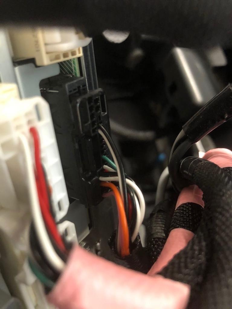

I modified the harness so I can use the 10-pin black connectors and remote turn on lead as needed:
bTDJGRLe-g2scbUXaVg_t37uHOrTYhB75OoGEwPsC8qe3PwBsYljQCWccpKquhtum7FvOxfme4hA-hLdimcZ1VXCcOujOLE13RivGk3H_QX5aclQLwtx9wzb_lRHcJAXwjW41hJqvKOvWVvXijGcuBmvfDuIeIzxUFSYxhRj5gJZ1ReARrFT2Zgbt2bkuIo9U_I2XbWBd81OE_nMkOhVoTB4R_YmQOAUGb1UQF-iTDICm_D5LCvjLRtL3dREzF1bcydch_4IepvckvITTCVZMTpgh3dEL_xCf4UET8sQaxGiFeV5ep4ixdb7_eGsyGtUNzmCGlwT8rWPa8Ir45wvssSgz9Hh6tmSKHOBtkZWnKM6XvNptCnMS5n9j9H0dwMzzo_9nz5sAVtDgWdPQ8iioqAUMhuZAqpSkguQuBlsJ4tIIGL6uv1YLjuBKOJtNLy_abJfMFSebPma7gUwOOGednF9hyUBetz9YC_2ADJM1OC24P8xvSJq7b3LI9dIlqc6S2MBlceKZeuSgaAdXVUz1RAt17895XW0_3O6RMockYO1g3kBzcC4JjhFaqEmFSER_BSG2YHhHBSSOZmXCkeXyLEvVXbhy4rj9k2msEzj2aBOXmmuEHPqOYB7MuFe-4eFMx6VSsU5kh3jY-_W4IiOgYR5Nf8cmTZv0o-fcZ0Aif2Q21EmWSi4EFMAmckfOA=w2112-h1584-no
and here is the finished product:
lfQL6kAdFKWEsrIkqhcLwttKIu554wjGWYZGc_xTVu1Xr6SogxLeKyhBXz9AGKEti5Ts9wPUuimJ6djZJgHWZpFg5Jh7wg3yOdZrL3ALQeJMDDn6C3gEIHwvDAcvtQ8Lg3vYFObPQNsq3VgZZ5DOxH41DhZGHdhMW4E7KwK4QmPgYP-a2VMDPfBwqokTgnag_A4ul3_ipNR8-hueFG6_1eloGON3bAJHcfD5XRgvigsPfqOoxLJKjLtOU9eL-Q-Z4gQWu2c41e4PP9NyHPGqEm-7-SGPwhz07PNUlWOMtnQb0Zy5h0372AIKazHrxgvR1dCKYQja9S1xjqSzRF_enHBhLN5Zmrq0vMcCMn6oImZSRFZ9nC6RBC88VG3m0cmMH-hbq-uuyHpm7ZLAhzRC07L30QsK-sOLkKzIT_JvPJDCURCsAuUndr0NDvAltKv3N5jc0b9zXI9hw6oGf_gBz2TVyRnpWXPbrriFmQkNYbbN5agiVSdTNAmKXL8re1nNefjL8i8abksfPssXb1XA7Ouxy9yLwchbmf0Db1SgRCnxz4Az2HVS15oo9cm5RTYCy_yauwo6vQgxycYOCtUhy6ltOzL_FEiz2td-sdDu0CEskiPdHlpGdZPIpZHC0-NQYvu84JKNa2siZ7gn38S-p4IBVubWXWS_FWTE1cUgOE-0fLpcZQ27EkMWiFkQlg=w2112-h1584-no
This harness does work with the 2020 MY 4runner (non-JBL)
