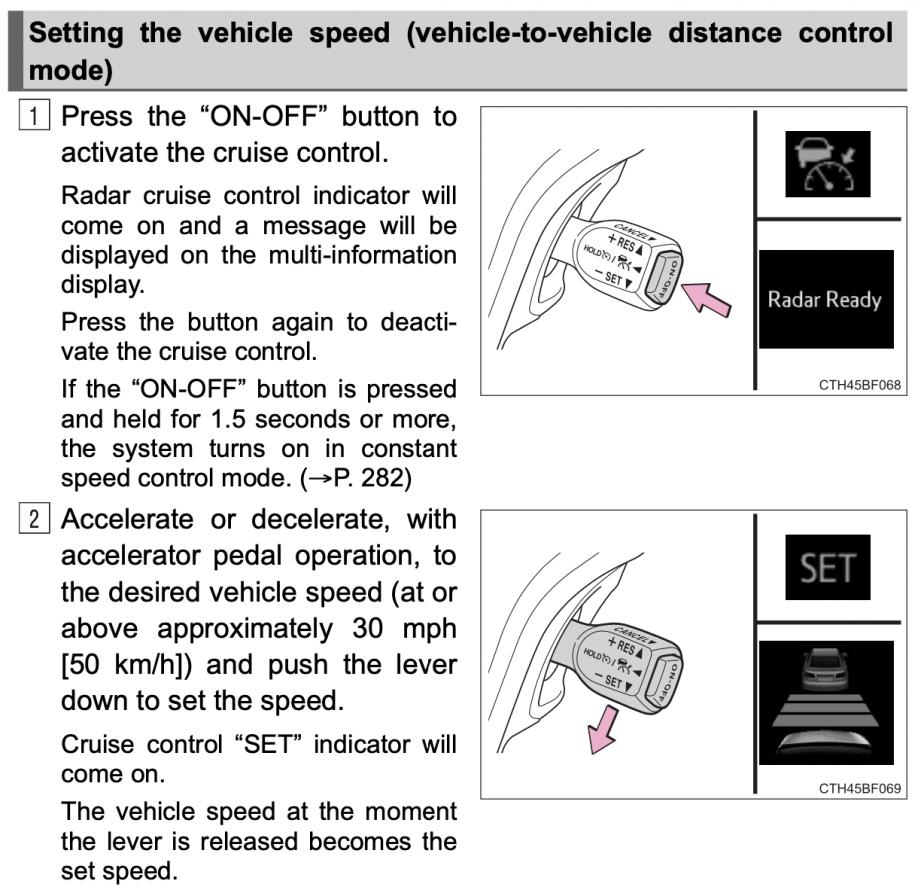

To activate the cruise control you depress the button on end of control (the stick located below windshield wiper controls). Then you push lever down. This locks cruise control on. You have to be going over a certain speed before it will work. Maybe around 40 mph or more.
here ya go
here ya go
So I am assuming soon as ON-OFF button is pushed-in or held on for 1.5 sec, a green "Radar Cruise" indicator should come up on the dash.
But this doesn't happen for me, nothing happens. I tried it in all kinds of speeds.

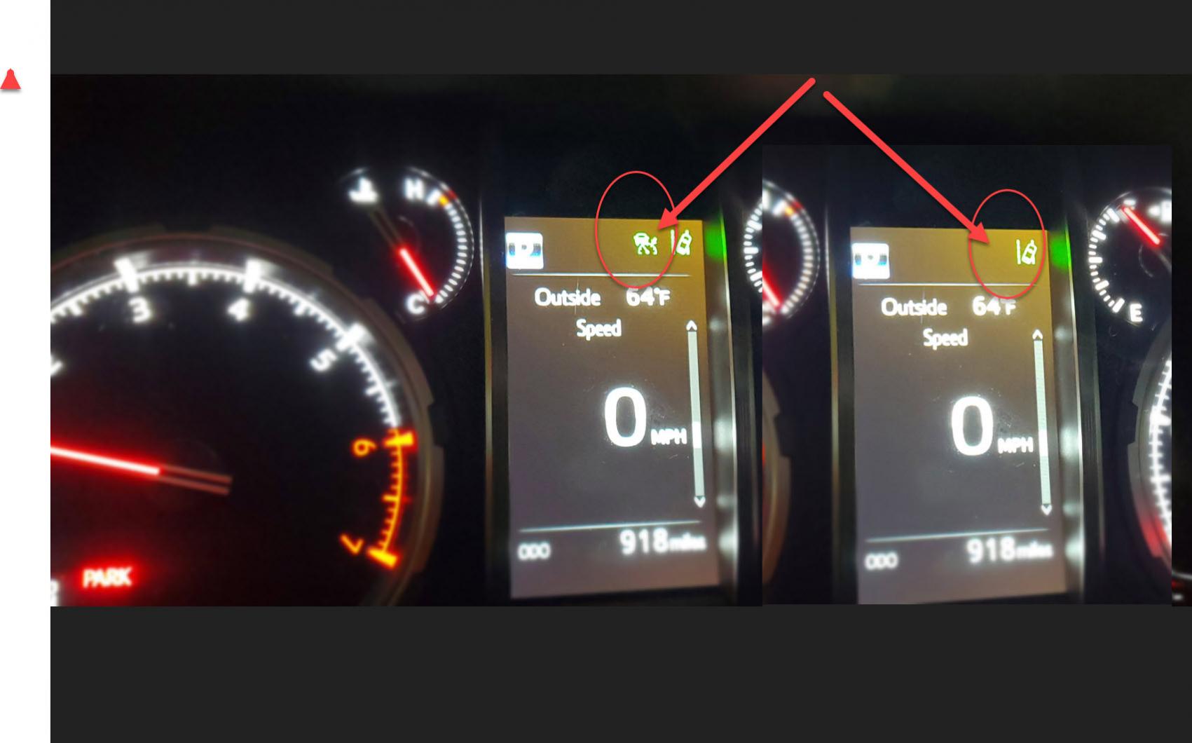

Do you see the CC Icon when turning the CC On?
Here is my example from my 2020 4R-ORP
That is also tied to your Front collision control.
You don't need lane departure on for the cruise to work but maybe if that doesn't work either then it's a clue to help troubleshoot.
In my 20, I just tap the button at the end of the cruise control stalk and it turns on, says "radar ready" in the DIC and then you can set the speed.
if yours isn't working the same way, sounds like a trip to the dealer once you check any relevant fuses.
