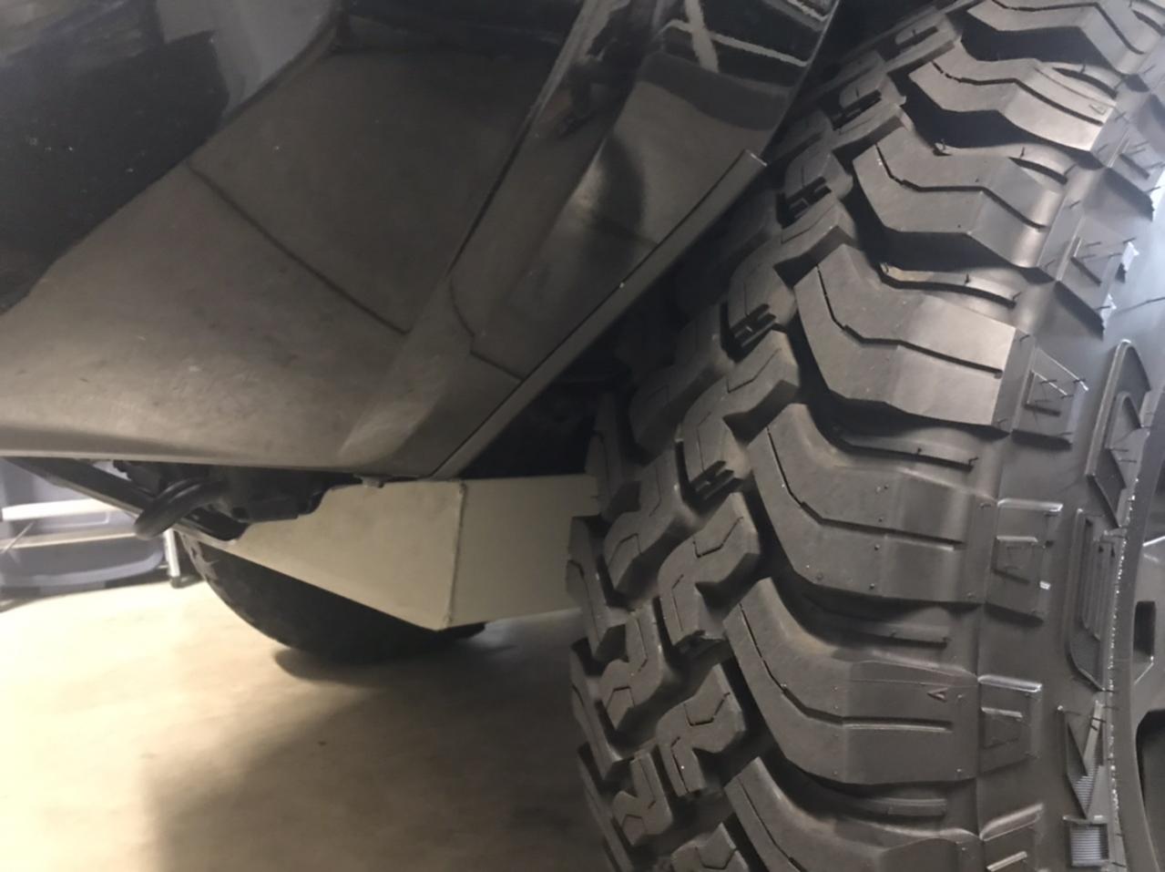

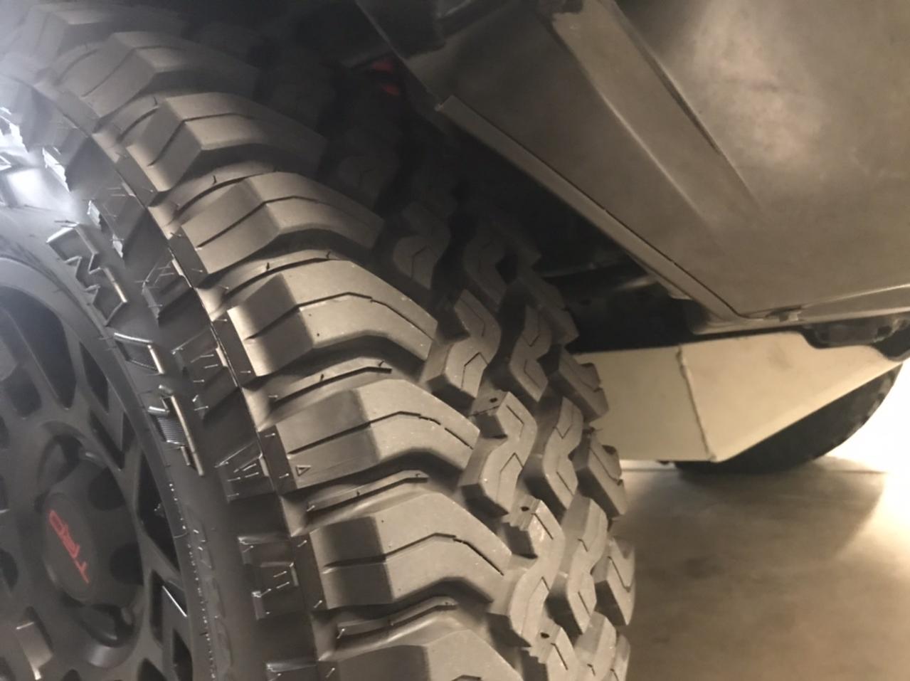

I went with the 2/1.5 Cornfed spacer kit on my 2015 TRD Pro Bilstein suspension with 285/70/17 Falken Wildpeak MT’s. Had to trim down the fender lip edges with no other modifications done. Once this suspension setup blows out, I’ll probably upgrade to something else, but I expect it will last for years to come.

I went with the 2/1.5 Cornfed spacer kit on my 2015 TRD Pro Bilstein suspension with 285/70/17 Falken Wildpeak MT’s. Had to trim down the fender lip edges with no other modifications done. Once this suspension setup blows out, I’ll probably upgrade to something else, but I expect it last for years to come.
I had to do small mount of trimming as well as pushing the liners forward. The trimming is not visible unless you look for it.

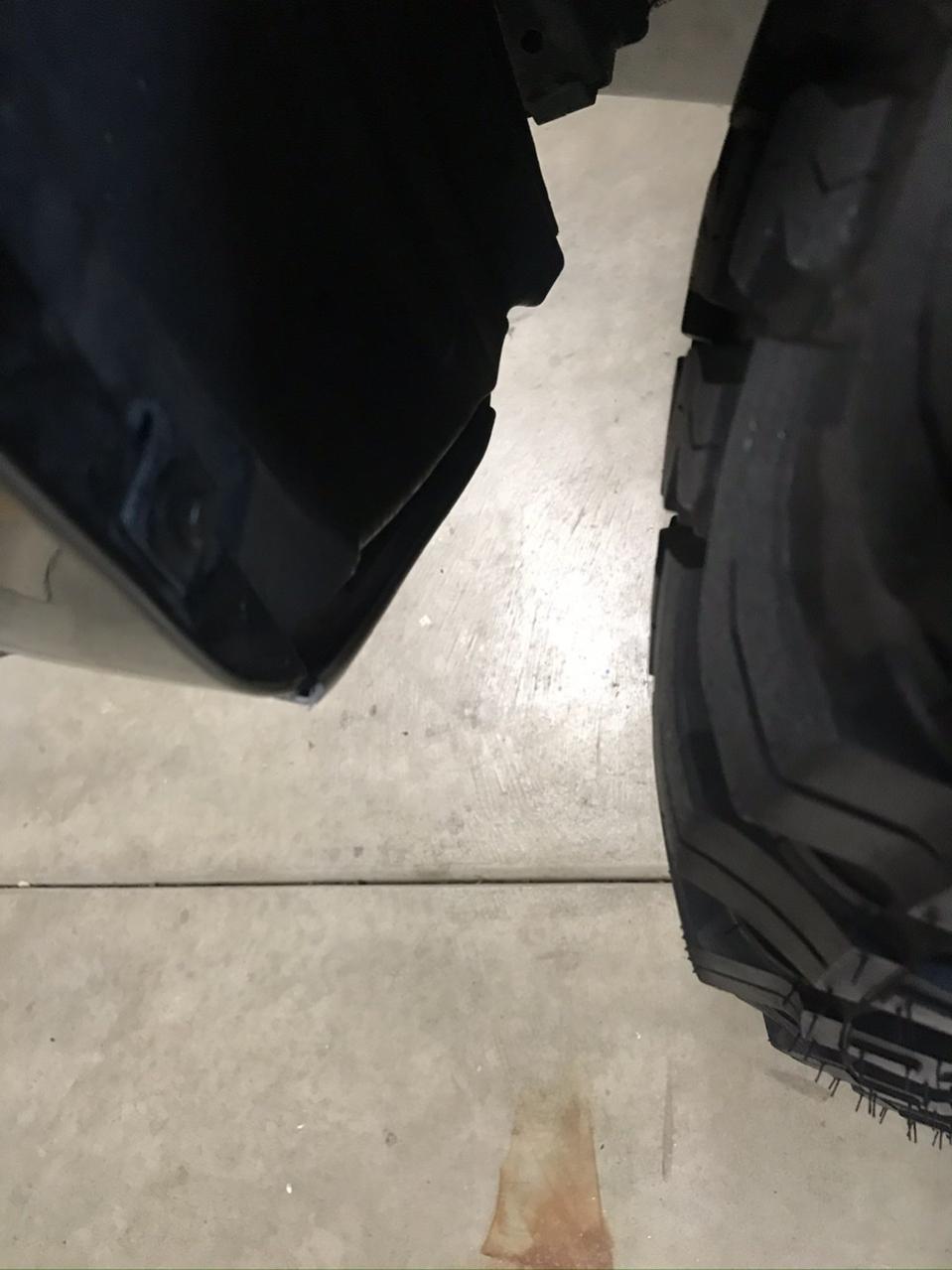

I used rubber automotive door edge guards to cover the trimmed edges on the fender. Looks much cleaner to me. I didn’t have to push the liners forward
