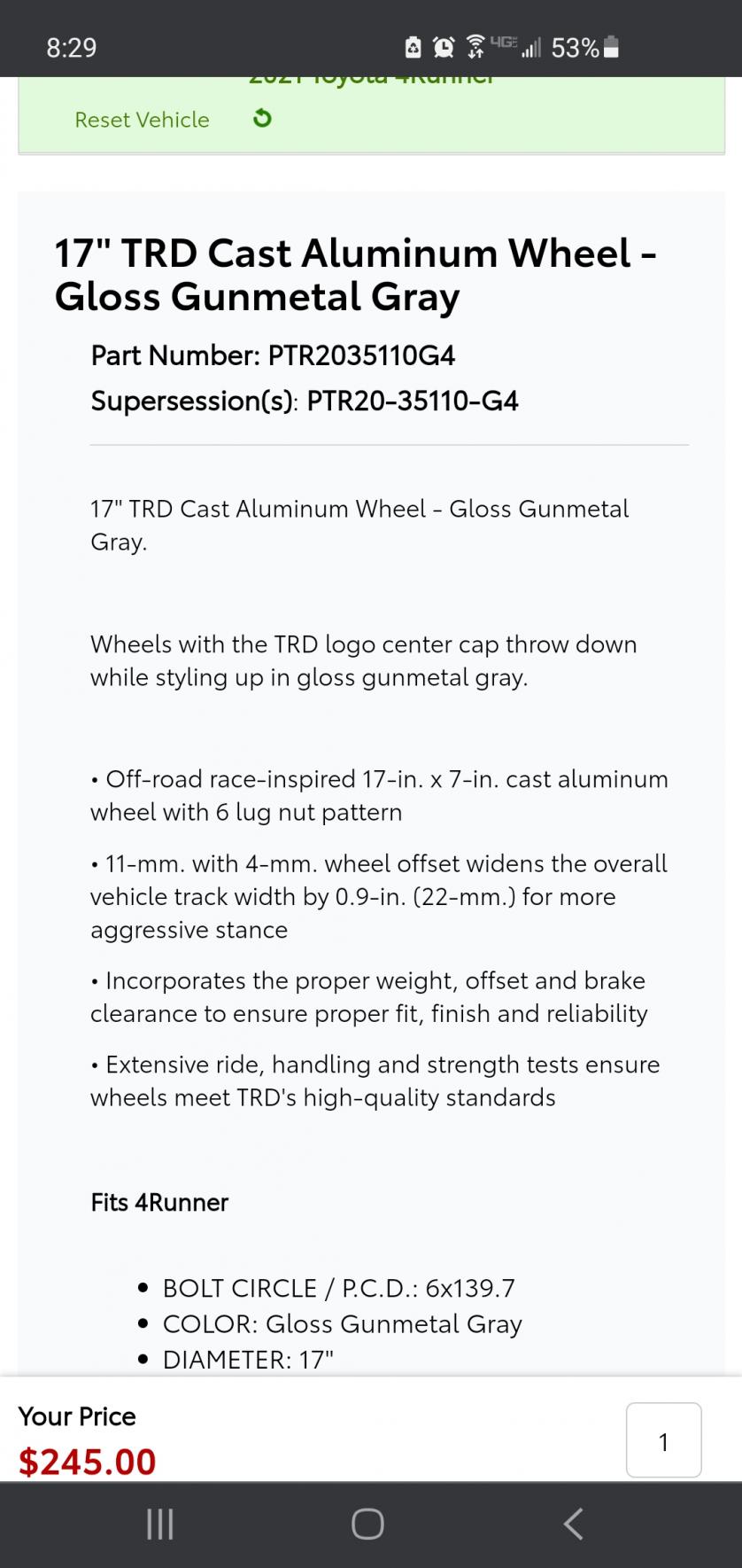

This seems odd, I thought my 2021 Venture had the 17x7 TRD Pro wheels, but the door label lists them as being 17 x 7.5.
Does the Venture edition have a different version of the black TRD wheels than the TRD Pro?

I think the sticker is just wrong. Mine is the same way. They are the standard 17x7" TRD wheels.

Shoot, was looking to go to BFG A/T KOs in a 285/70/17 from Costco (on-sale) and they say they will only install if the rim is within the tire spec (which requires minimum 7.5" wide rims).
My sticker just says 17 and not 7.5
Are you sure? At first I thought mine did too but if you look past the space you see it says 1/2 after the 17x7.

the sticker is probably referring to the sr5 wheels or the Trail/offroad wheels.
since thats what the car came with until the dealer/port swapped them out for the trd pro wheels.
maybe someone with a pro can take a picture of their sticker and see if it says 17x7?
