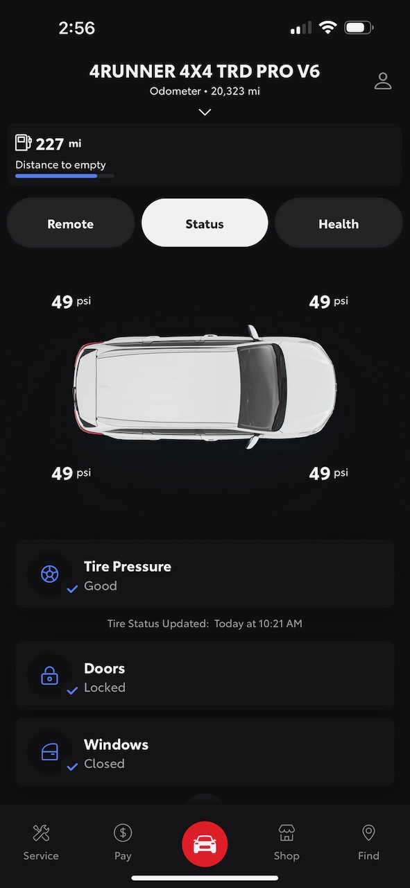

If you download the Toyota app to your phone, there is a part that will give you the status of the battery health of the keyfob. That is at least the one thing it is useful for. Otherwise, it's a stupid app. The old version was much better IMHO. Don't know why they nuked all of the useful things (mileage, Tire pressure, maintenance log etc).
I have all that stuff in my app. Perhaps it's subscription based and you didn't renew it?
It wasn't subscription based before and it never asked for me to sign up for any subscription. The app was 'upgraded' to a new version a few months ago (?) and ever since, it's been useless.
Don't know what to tell you...
