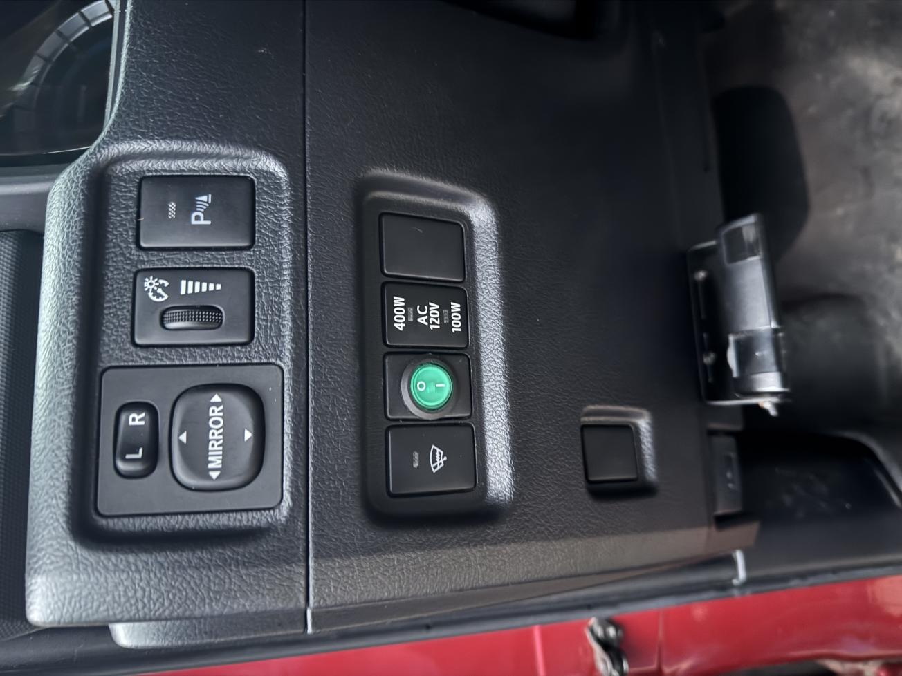

My workaround is this. The system is looking for a “normally open” circuit to arm the alarm. In other words, it needs to have no continuity and not to make a circuit for the vehicle to think the hood is shut . The switch in the latch creates the circuit “open” when the hood is closed . (I don’t know about other models of Toyotas or even other 4runners… I saw some guy that had a video about a Highlander hood latch and he said that you needed to jumper it to make it “closed” if your latch was defective to get the alarm to arm. That was not the case with my 4runner. If you just unplug the hood sensor. It will arm everytime because the circuit is open and that’s what the Alarm is looking for. It doesn’t solve the problem of stopping the Alarm from arming automatically.
Anyway, I ran a wire up to my dash from the plug (unplugged) to a switch and made it so when you flip the switch it makes a continuity closed circuit… mimicking the hood is open when it’s not.
In the on “I” position the alarm will not arm and the doors will not time out to an Auto-lock….but the doors will lock manually with the button or the FOB. You can open the door anytime after the fact without setting off the alarm because it never automatically arms.
Anyway, I used a toggle rocker switch because I wanted to have a visual on/off instead of a push button. The only difference is that I is on (closed circuit) which means that the alarm will not arm. And O means that it will operate as normal, but you do loose the alarm on the hood latch…. Which I pretty much decided, didn’t seem to matter that much because someone would smash the window to open it anyway. Good Luck Campers
