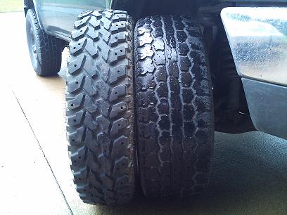

I just picked up some Zamboni tires cheap........really cheap.
Just wondering your thoughts whether i should install or not?
They are 215 85 r16... they are 30.38 inches tall and unfortunalty 8.46 inches wide.
They are load E range.. but i noticed it says at 80 psi??? What tire pressure do i need to run if i do?

80 psi is the max pressure you can pump those tires up to. I would run those at about 32. Most Es ride harsh IMO, but they'll work.
Mounting those skinny tires on wide rims will let the tires wear uneven at the wrong PSI. You will have to test to find the right PSI.
Easy test is to spray the tire down with water, drive 20 feet on dry concrete and look at your tire marks. If the edges are not leaving marks, then it is over inflated, if the center is light on the marks, the it is under inflated.
10 ply tires will require 65+ psi any way to keep them from cupping.
BTW, Those tires will be awesome in the deep snow. It should be a mountain goat.

Looks like ill give them a whirl!!
If they are great in snow I'll let everyone know because even new these tires are waaay cheaper then our stock and larger sizes,...
Thanks for the tip they are a gazillion ply so I'll try your meathod!!

^^They aren't. The skinnies will be great digging through deeper snow down to the pavement, but pretty much all MTs suck on hard packed snow (that's where ATs shine). I've found skinnies will dig too much and get you high-centered if it's really deep snow. Then it's better to have a wider tire that'll float on top easier.
A 8.5" wide tire will be fine if you have 7" stock width rims.
yes your MTs will not be so great on snow and ice, but there are a couple things you can do the help yourself out there, one have the center treat block sipped and you could restud them, but i dont like studs unless you drive on ice 99% of the time, on wet pavement they are bar far worse than a trailer tire. also the fact that you have a very narrow tire will help you in the now and ice as its a much smaller foot print still holding the same weight, so there for you have a much greater PSI to the ground than you would with a wider tire. your narrow MT tire i would venture to say will do just as good as a wide AT in hard packed snow and ice.
