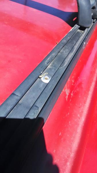

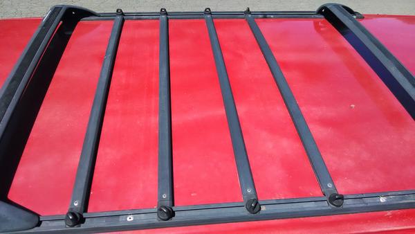

Went and got a stock t4r rack from the yard. Drilled through the roof and used some hand rivets to mount/seal it, no leaks or anything! Strong as if it were factory, I was more than happy with the results.
Here is the rivets:

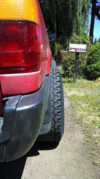

Next I threw on some 15x10 Alluminum wheels, with some 33's to beef it up.
Now its drivable! :lmao:
