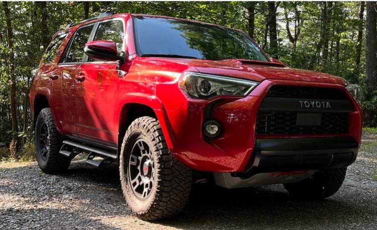

The TRD skid plate is what comes standard on the TRD Pro model (top of the line). I added one to my '23 Off Road Premium - easy swap. It does feel more substantial than the OEM plate that I removed. Whether it covers more - I do not recall, I also added the black valance that also comes standard on the TRD Pro (OEM is silver).
