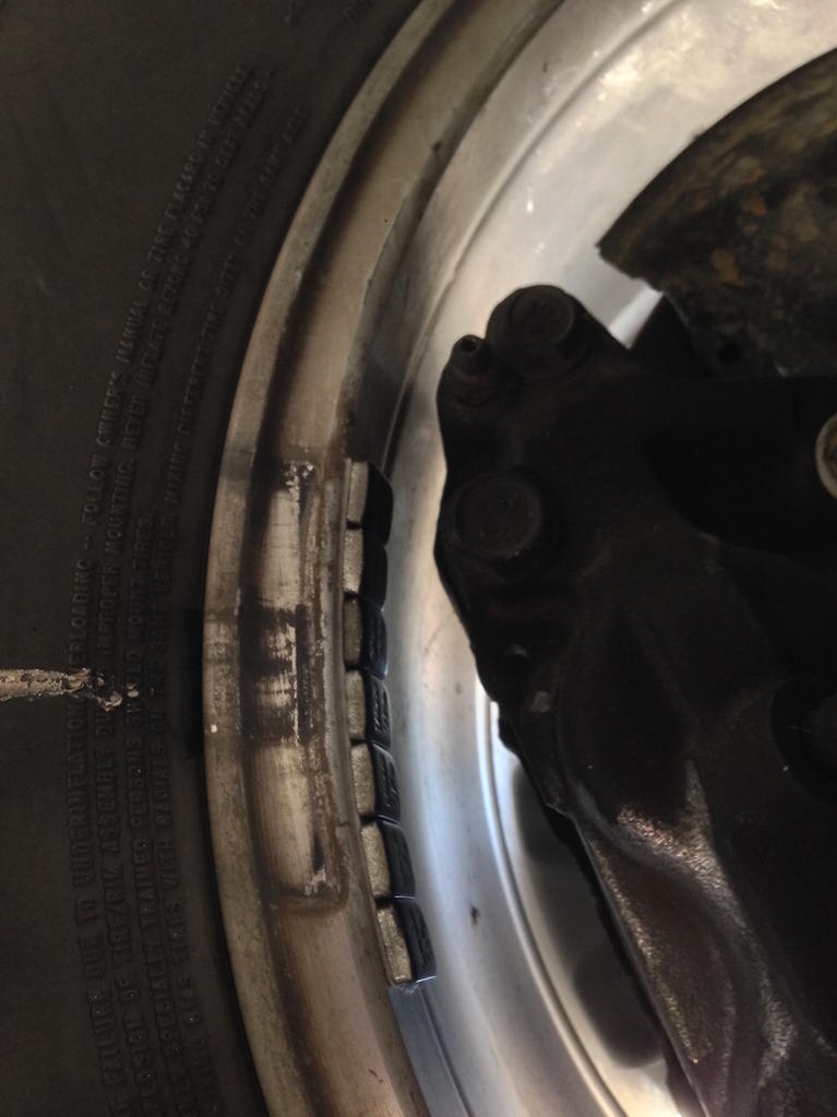

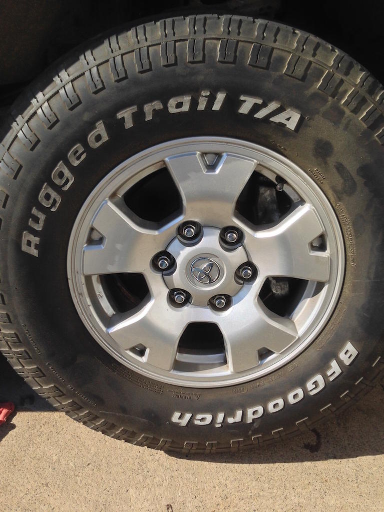

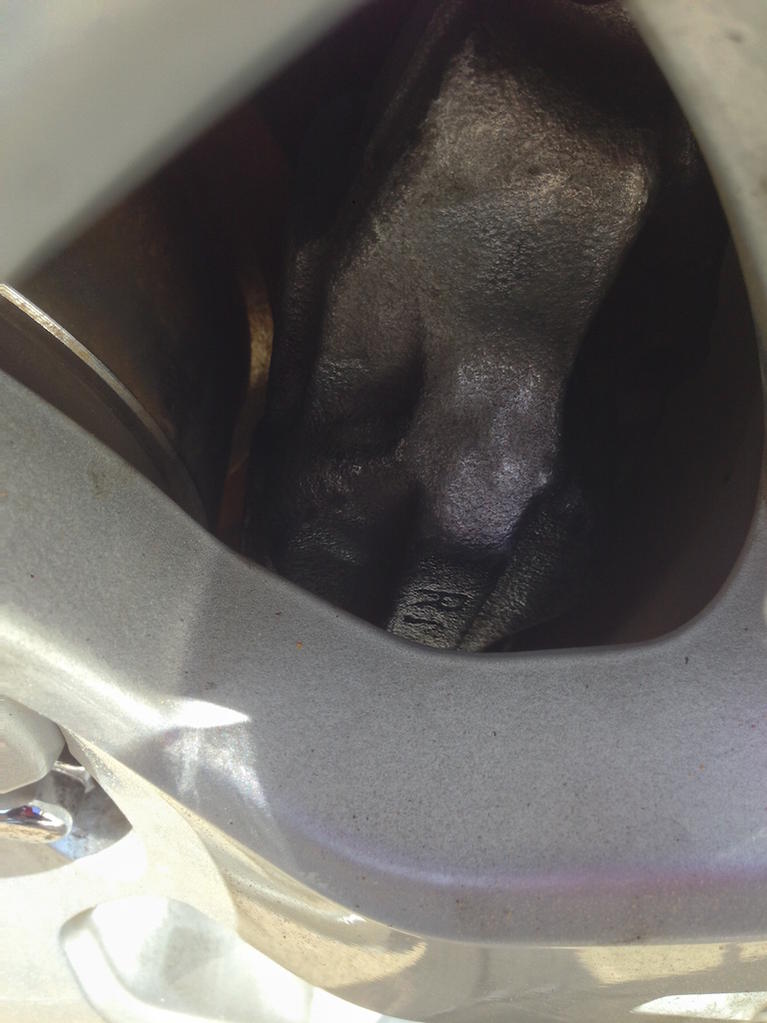

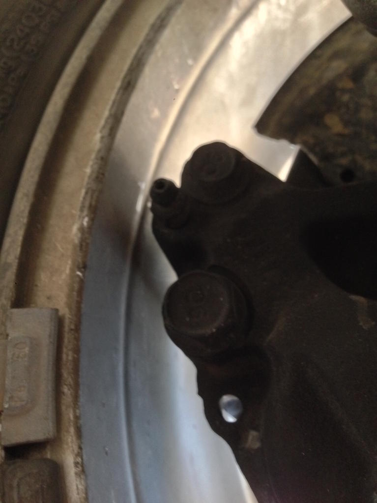

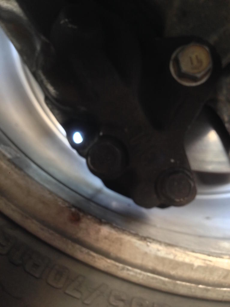

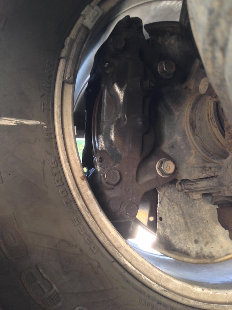

I know this thread is old, but since I just created my account today...I figured I'd contribute back to the community. I'm able to run 16" Tacoma rims off a 2012 on my 3rd gen and the tundra calipers clear fine. Although I'll have to change the way the rims are balanced to complete the upgrade (see how close the weights are in the pic).
