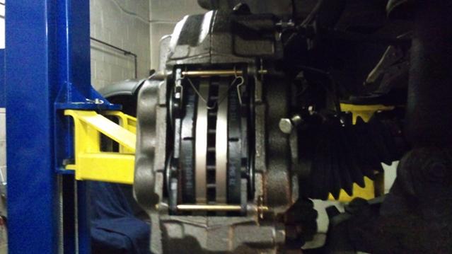

231's FINALLY!!!!
CanukRunner
WOW...
Just wow... That was not a small upgrade, this upgrade is totally understated.
It was incredibly simple to add on... one break line to undo and two bolts... and that's it per side.
Bleeding the brakes was harder than the caliper upgrade.
I really wasn't expecting much from the descriptions i was reading, perhaps some improvement..
But noo... This is a very big improvement.... the pedal feel is much softer so it may appear to be less of an improvement but my 4runner now shrugs off speed effortlessly.
Have not even kicked in the abs yet because there was no need... getting off the highway my needle dropped from 100kph like i turned off the ignition.
Worth every penny.
I did the proper bedding proceedure.. or close to it.. 60-20 a few times 100-40 a few times etc

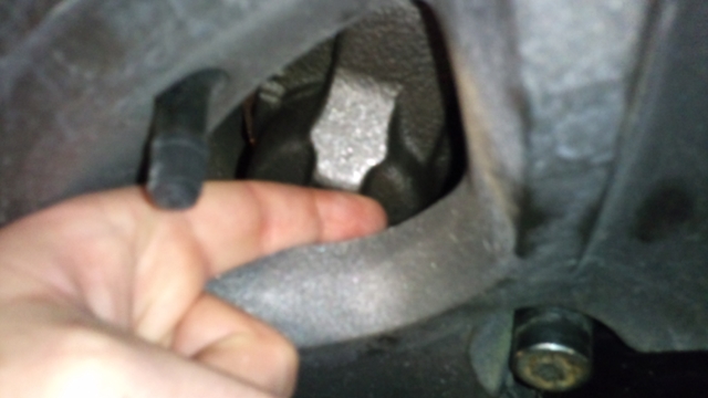

The 5 spoke rims had lots of room, about a fingers worth.

If you aren't engaging abs you have less applied brake torque. Tire compound, weight transfer & vehicle weight are proportional to max friction force available (ie a skidding tire that activates abs). If you can skid your tires with stock brakes you can't stop any quicker with 231s. What you're gaining is repeat braking performance.

Pedal feel is very slight difference. I did notice some slight brake bias differences with more front end braking power, but there are 3 things I still need to correct on my 4runner that might alter that (rear brakes should be bled, suspension is shot so more front end might be diving more, and I still have wheel balance issues). I am an aggressive driver, so I might notice things like this more than others. Also I used some Rabesto's cheap pads from Rockauto and the cheapest rotors I could find at summitracing (who has really reasonable shipping rates). No issues as of yet over the last 1000 miles.

The pedal plunge is about 1/4 of the pedal were there is almost no braking then it starts slowly and at the 1/2 way point it becomes very obvious the brakes are waaaaaay stronger. I take it its because the pistons are larger we get the plunge so there is not enought fluid getting pumped in?
