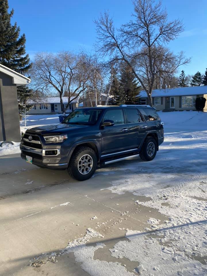

I'm running 255/75/17's on my '15 Limited with 1" front spacer lift, there was zero rubbing on FJC wheels, but when I added 1.25" spacers there was some rubbing I was able to address via pushing the fender liners forward and removing the rear inner liner panels that cover the body mount. The tires are Duratracs, which only come in SL load rating in that size, they have been fine although this truck is on-road only, if I was wheeling it I'd want a stronger sidewall.

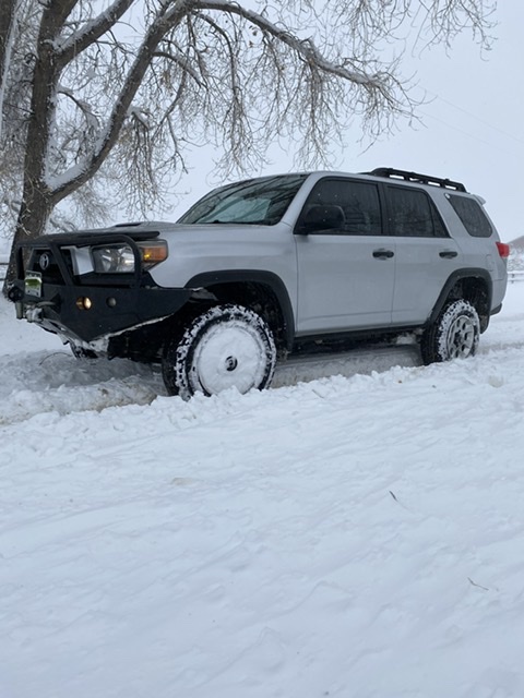

Ya some people have got them to fit and not rub at full lock or full articulation. I want to know what kind of sorcery is involved, because for some people, no matter what they do, me included, the 285 rubbed no matter what. Soooooooo that led to the bumper chop and fender liner pushed forward and a BMC. Now I could fit 34's or maybe even 35's!

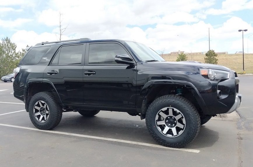

Go 255/80R17. They fit just fine (might need to slightly trim mud flap, not everyone does). They look great, I still get 19+ average running on the highway, and the ride is great.

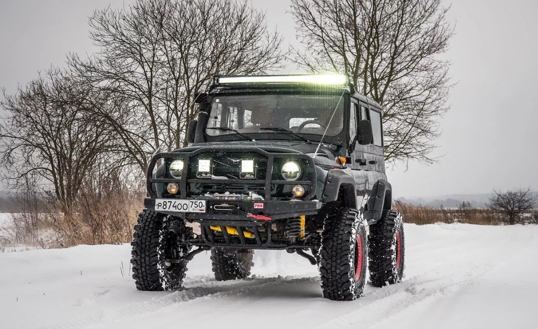

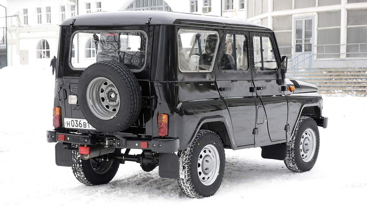

Lookup "Russian UAZ" they will have skinny tires I bet. I'm aware of the floating thing and those trucks they have in Iceland but I don't think it's something most people are going to encounter. If it's that deep you'll bottom out something else anyway unless you have some truely massive tires. Winter tires don't float their benefit is mostly softer compound. Thin ones are still better to cut through. I think you actually get more tread contact deflating tall narrow tires than wide ones because you get more lengthways contact.
