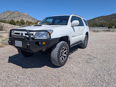

TIA and recent photo from Great Basin area, NV, for attention.
