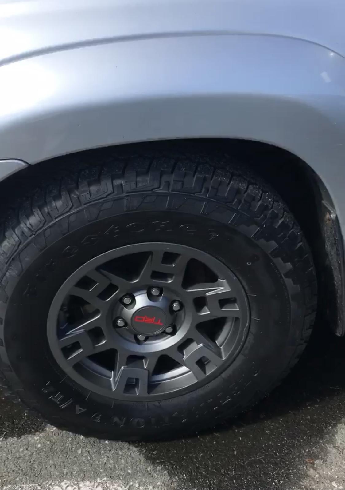

Hello friends,
Just got 255/75 ATs on the trd wheels and seeing a lot of rub when turning hard right or when backing into a space
What suggestions do you have? Should I remove the mudguards will that definitely solve the problem? I'd like to really keep the mudguards they look great but don't know what other options there are.
I'll be honest I'm new to all this so I've heard about "trimming" but not too familiar with the process or what that means if there's a tutorial. Would that mean removing the mudguards then will the guards be able to go back on?
See photos. Can take some new ones today with the wheel turned all the way. Any suggestions? [emoji1374]

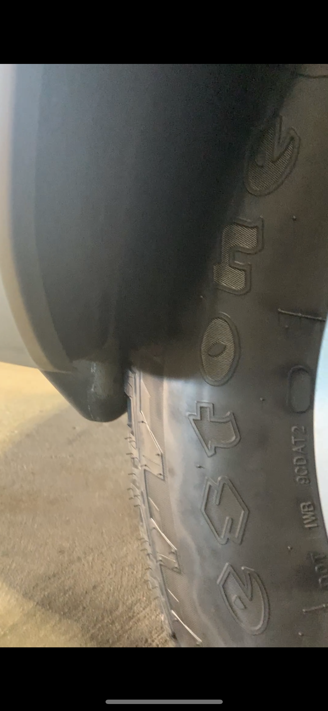

where exactly are the tires rubbing in the front wheel wells? towards the front against the fender liner or bumper? or in the rear against the body mount? maybe against the UCA? if it's in the front it should be an easy fix with the fender liner mod and perhaps a bit of bumper trimming. if it's against the body mount, that's a whole different story. are you planning on getting a suspension lift?

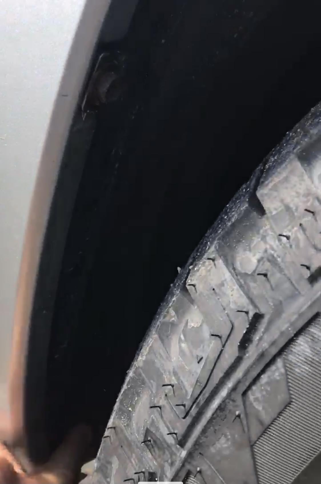

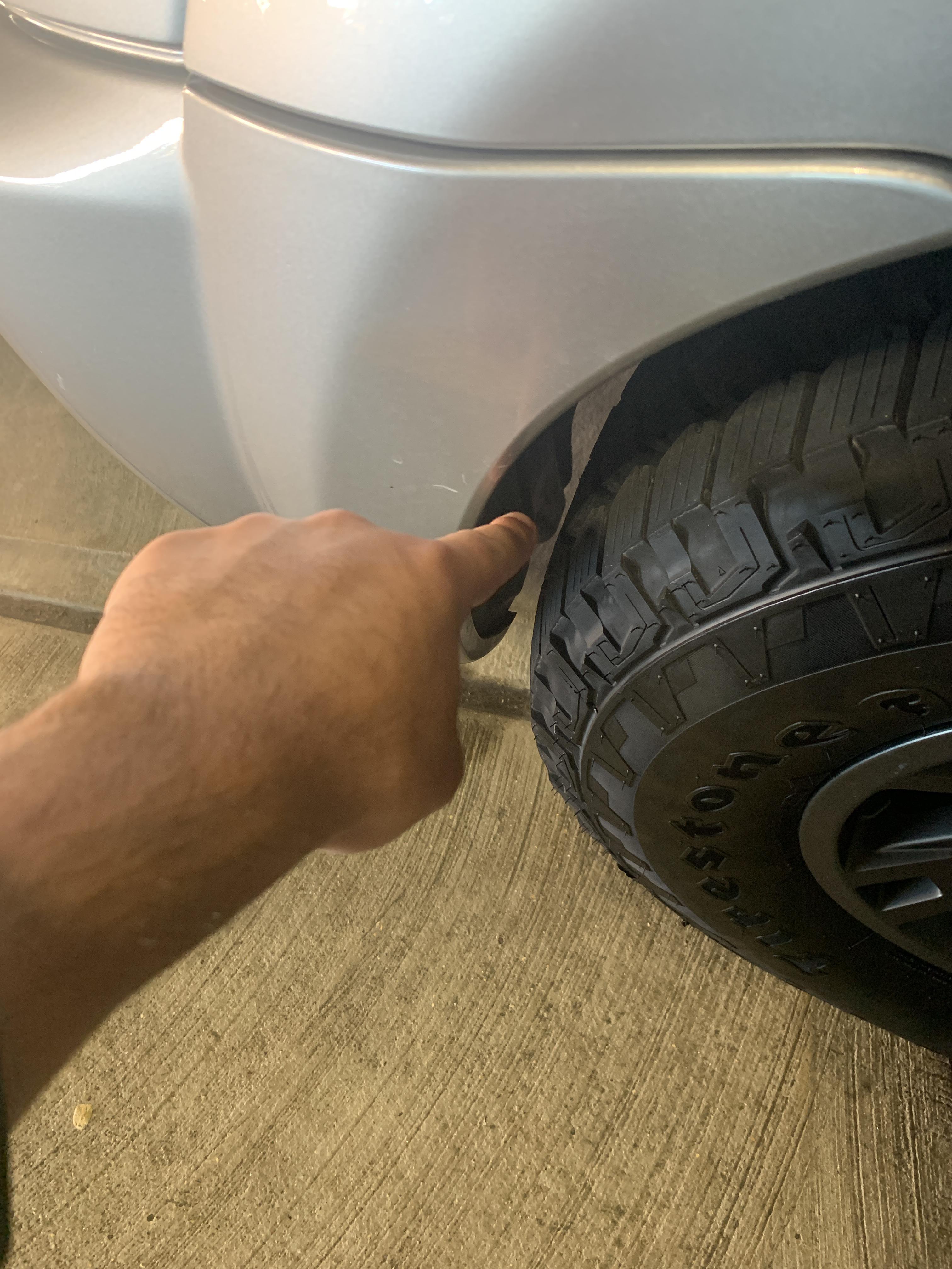

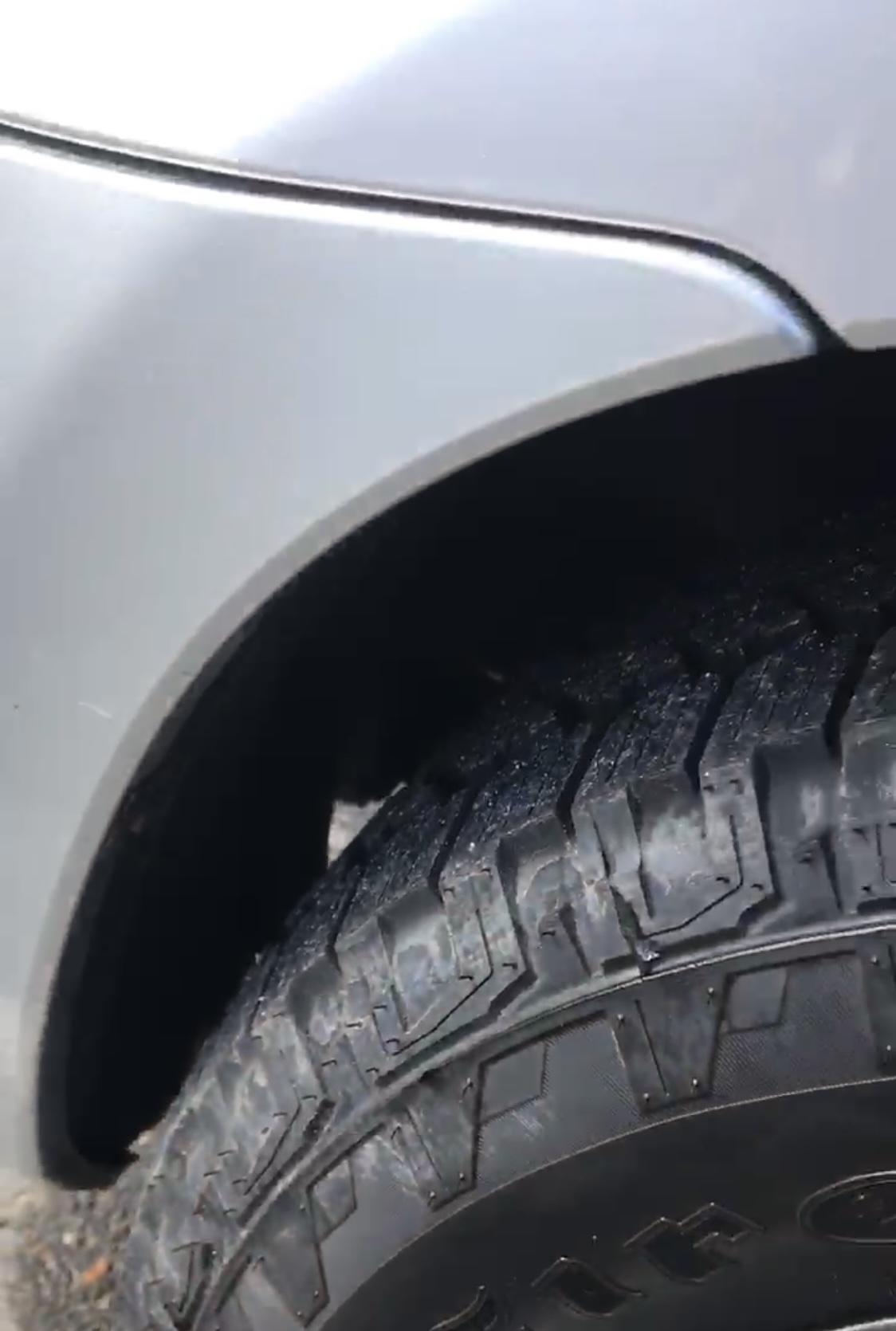

I'll attach photos so you can see. This is all per the driver side (the descriptions, and hopefully photos help to clarify)

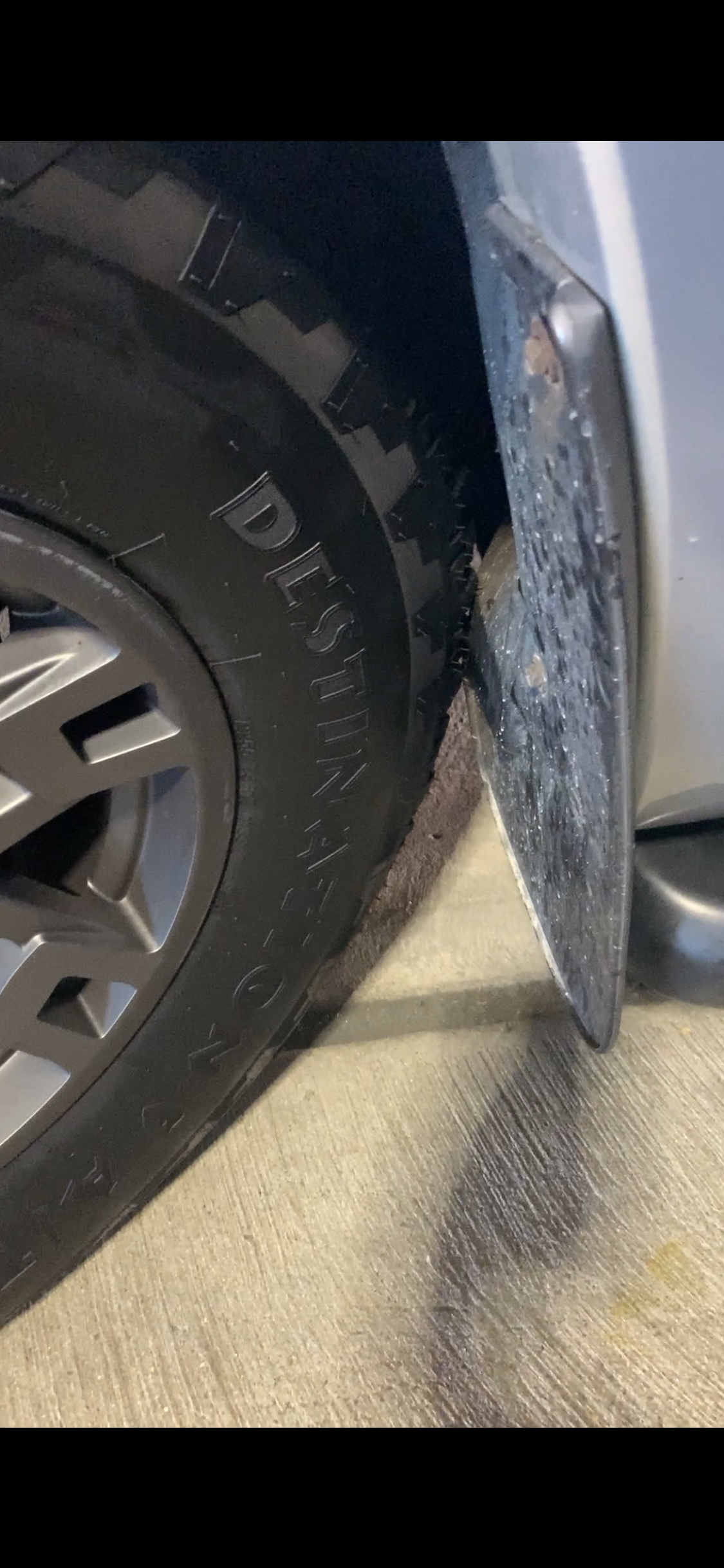

When turning left all the way it hits in the rear against the mud guard
When turning to the right, it hits in the front, I'm not sure what part that is but I'll attach two photos and point to the area in the second photo:

Assuming that you had 265/65s on first I think the difference in offset of the wheels is a larger factor (+30 vs +4). The lower offset means the wheel is pushed out further from the hub, making is a wider turner radius, in addition to the larger tires. I think your only options are trim the wheel wells or add a lift.

i'm right there with you! i have 285/70's....i realize the 255/80's are almost a half inch taller, but the 285's are an inch and a half wider than 255 and i have no need for a BMC - i'm nowhere close to it. all i had to do was the fender liner mod and cut off a tiny section of the bumper where the liner used to attach, and that was it. everyone's truck is different. that's one of the first things i picked up on while researching this site for months trying to decide what lift/tire size to go with. one person will do a mod with no issues, and then another person, with the exact same truck doing the exact same mod will have all kinds of issues.
