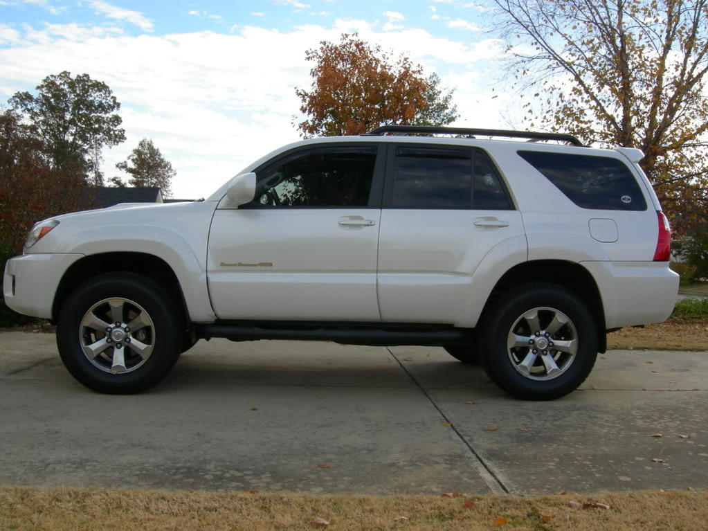

I'm thinking I'm going to go with a 275/65R18 now, I've found a few pictures of guys with that size and only a daystar lift and it seems to work.
like this guy. except I'll put 275/65R18 terra grapplers instead of Michelin AT2. what do you guys think I'll need to do to eliminate rubbing? simple fender liner mod and a bit of trimming?

I run 275/65-18 terra grapplers and when I first got them put on, almost a year ago, I only had a Daystar lift in. If I remember correctly the only thing I had to do was move the fender liner forward. However, keep in mind, I wasn't running Spidertrax at the time, so I can't speak for fitment of that size with Daystar and Spidertrax. If you are or want to run spacers it still probably will fit, but you might have to pull the front mud flaps. I even had to do this when i installed my Spidertrax with my 886's. Hope this helps.

I went through the entire lift and tires thread last night and I specifically remember your picture on there. I was actually looking for your post again today. I think you just convinced me to go with the nitto's in that size.
Which 275/65R18's did you choose? the LT or the one with the *
Any complaints so far?
I actually wanted the LT ones but the shop only had the XL ones on the sale they were running, so that is what I got. When I get new tires I plan on LT, but I cannot complain about these. They have been great tires. I probably have about 20-25,000 miles on them and still lots of life left. Just remember to rotate regularly.
