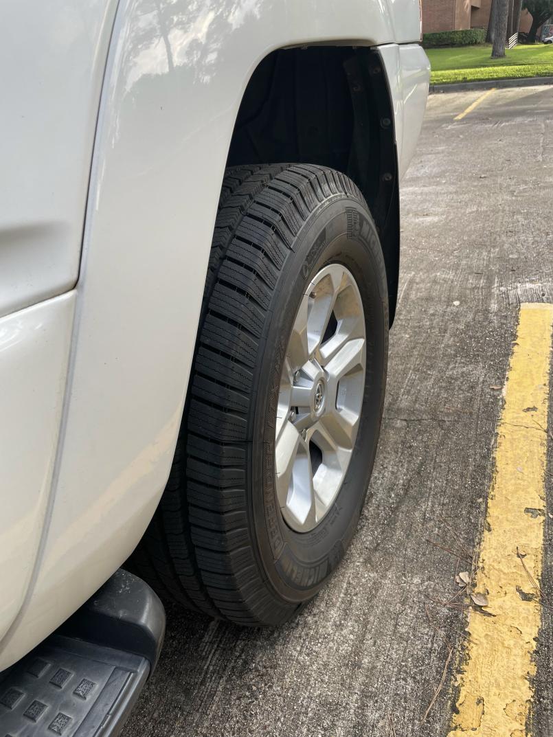

The installer was kind enough to mount a new 265/65 tire on the 17x7 rims and put it on the front of Runner. No clearance issues. I decided to go ahead and mount all on the 17x7 rims. It doesn't look bad but I do wonder about unusual tread wear or sidewall stress or quick emergency turns. So far she drives about the same as with the stock rims. I'll post pictures when I have the chance.
Better picture
Here's a picture. Too bulbous?
running the same setup on my 03 v8 4th gen, except with kumho krugen ht51's (design is very similar to the michelin defenders). I think the bulging makes it look better imo!
I agree that it's not a problem, and if anything you have a bit extra rim-saver rubber there.
Nice wheels, by the way. What did they come off of?
edit: duh I clicked the link, disregard my question! 2015 4Runner.
