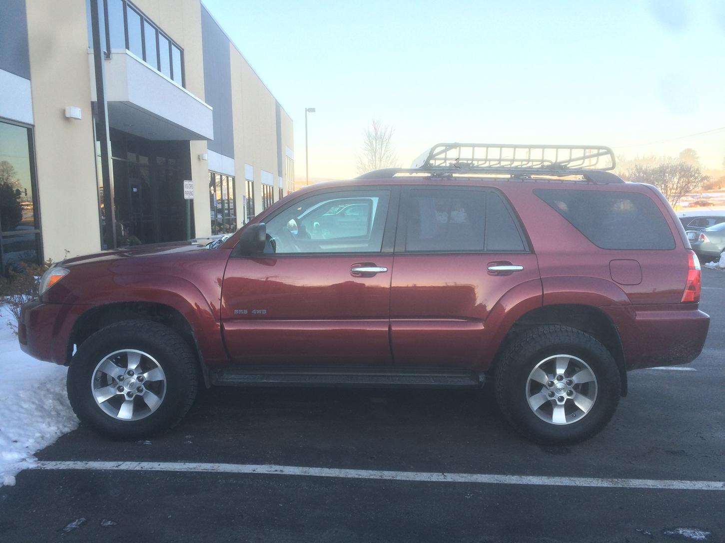

It does look good though. :)

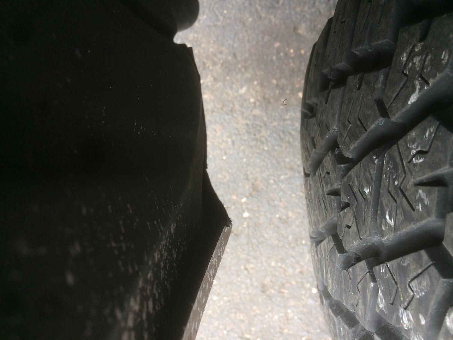

This is the trimming that needed to take place on the driver's side. It's the same on the passenger side too. Sorry the picture turned out sideways…

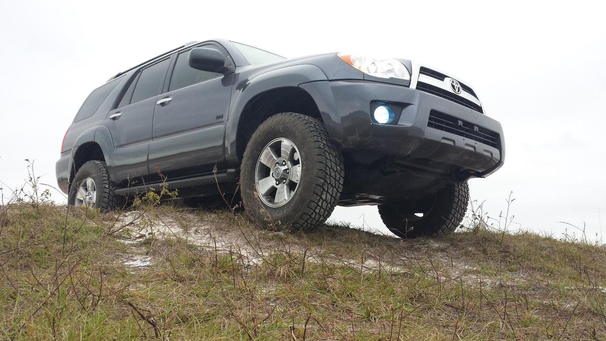

I say "go big, or go home". Get some 285's and a 1.5" body lift. You're going to rub regardless, especially with Spidertrax, so why not? You can always add some coilovers later for extra lift, which will help minimize rubbing.

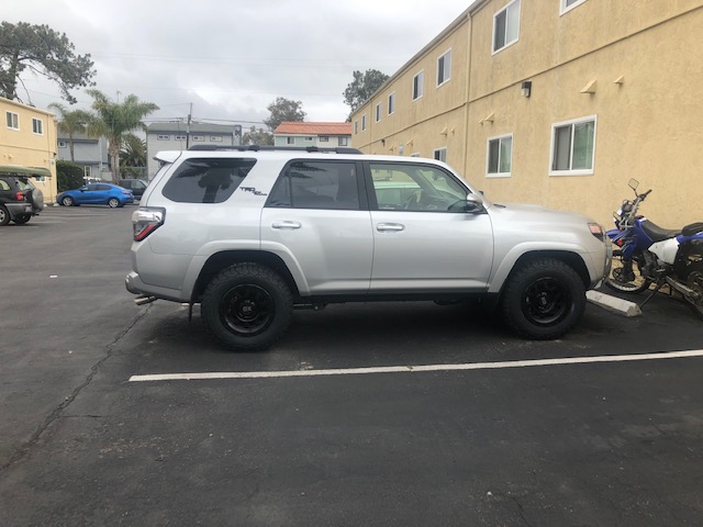

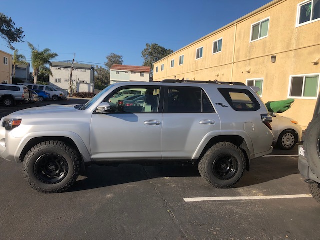

Not sure if this is the best thread but wanted to throw this post up so people could compare the differences in tires. Stock kdss no lift. . I recently got new wheels that have -12 offset. I attempted to get 275/75/17's on there but there was way too much rubbing. I downgraded to 265's, which only rub in full lock at reverse. Definitely like the look of the 275's better. I may try to put the bilstein 5100's onat 1.75 and do some front fender cutting... Here is a pic of a comparison for those concerned.
