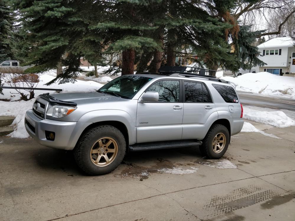

265/70 fit just fine on 17x9s. Here they are on my 17x9 Level 8Mk6 -12. This is stock height as well.
