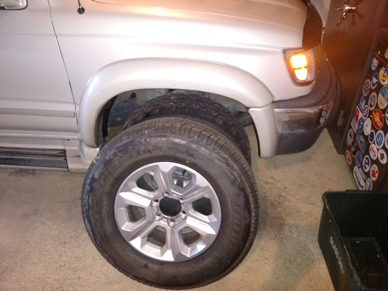

Bought a set of stock 2016 4runner takeoffs for my 2000 4x4 sr5. They rub. Thought enough guys have put these on. What do I need to do to make them clear the front fenders? IMG_20170218_162709358.jpg

those tires are 32" and should fit on a stock suspension 1996-2002 4WD 4Runner. probably the PO lowered the 4Runner.

looking at the OP's posted pic, the truck seems to have been lowered, judging from the distance between the top of the tire and the bottom of the fender flare.
EDIT: also the front bumper seems to have been moved rearwards or is it just an optical illusion?
Nope, they can rub. I had it happen too. 20 years of suspension wear causes this. I'd stick with 31's. 32's look cramped and stupid without a mild lift.
I don't think it's been lowered. Seems 100% stock to me, but maybe sag. Hitting on rear edge of front fender flare in a turn

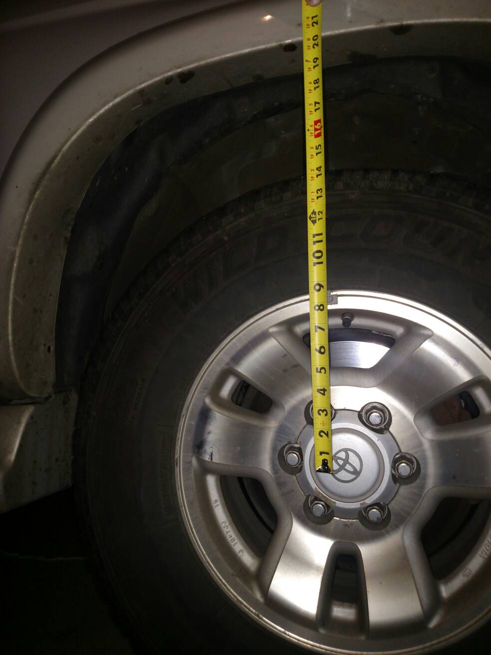

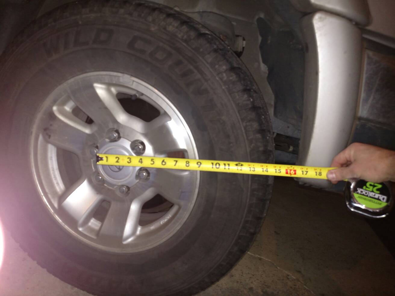

I have about 17" from hub center to the rear edge of front fender flare (bumper) where it hits. Also about 20" to the bottom center of fender flareIMG_20170219_191304378.jpgIMG_20170219_191342062.jpg

Laying a tire angled and next to another tire is a big visual difference than actually bolting the wheel/tire on the vehicle and taking measurements. Have you actually tried to install the wheel and tried yet and they tried to turn lock to lock? This will be better than asking people on the internet if they will fit.
FWIW, I run 265/70/17 Goodyears with 4th gen runner wheels on my 96 Sr5 4wd with factory suspension at 160k. The 96's had the shortest coils of the 3rd gens and I have very minor rubbing on the frame at full lock. Although I do not have flares and running boards.
I have tried putting them on of course. Very strange most people get by with stock sounds like, but mine definitely hit.
