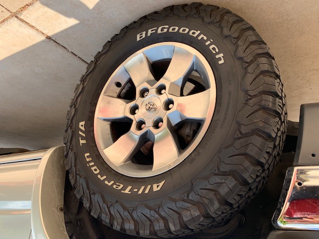

Today, i fit 265/70/17 new tires on my 4runner 2001 4x4 “no rubbing”
265/70/17 bfgoodrich KO2s on 4runner 2001 4x4, previously removed my front bumper flares and running boards because i didn’t like them but not sure if it would’ve been a problem. Other than that, all stock suspension
