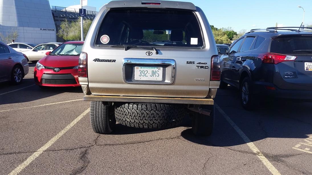

Installed the bumper this evening. Spare is getting caught on the cross member. That thing isn't going in there anymore. It's in the back of the truck for the moment -
I had the same issue with my CBI before I get the tire carrier added on. I was told that "any" high clearance rear bumper makes the spare not fit.
this was before I finished the bumper, but the back is just a rectangular tube, as you can see my 35" tire fits, but it would be impractical to use it that way on the trail.

I have a Savage rear bumper installed and my spare 265|75R16 fits perfectly. Any bigger and I'd need to find another solution though.
I can get mine up that high but that's no good. With the cable not fully retracted, I fear that it would eventually brake from the tire having movement. I'm not concerned with the trail part. I don't like driving around without a spare. Gonna have to figure something out.
