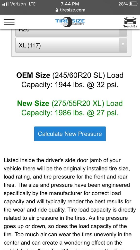

There’s no way this pressure change is correct:
Yokohama responded with...
27psi.
32 feels way too squishy, can’t imagine 27 is gonna be better.
Sticking with 38 for a couple thousand miles and keep an eye on tread depth readings.
27psi.
Am i misunderstanding something here? Both Yokohoma, the tire manufacturer, and the online pressure calculator tell you 27 psi, but you'll just stick with 38 psi because you didn't actually want an answer?
